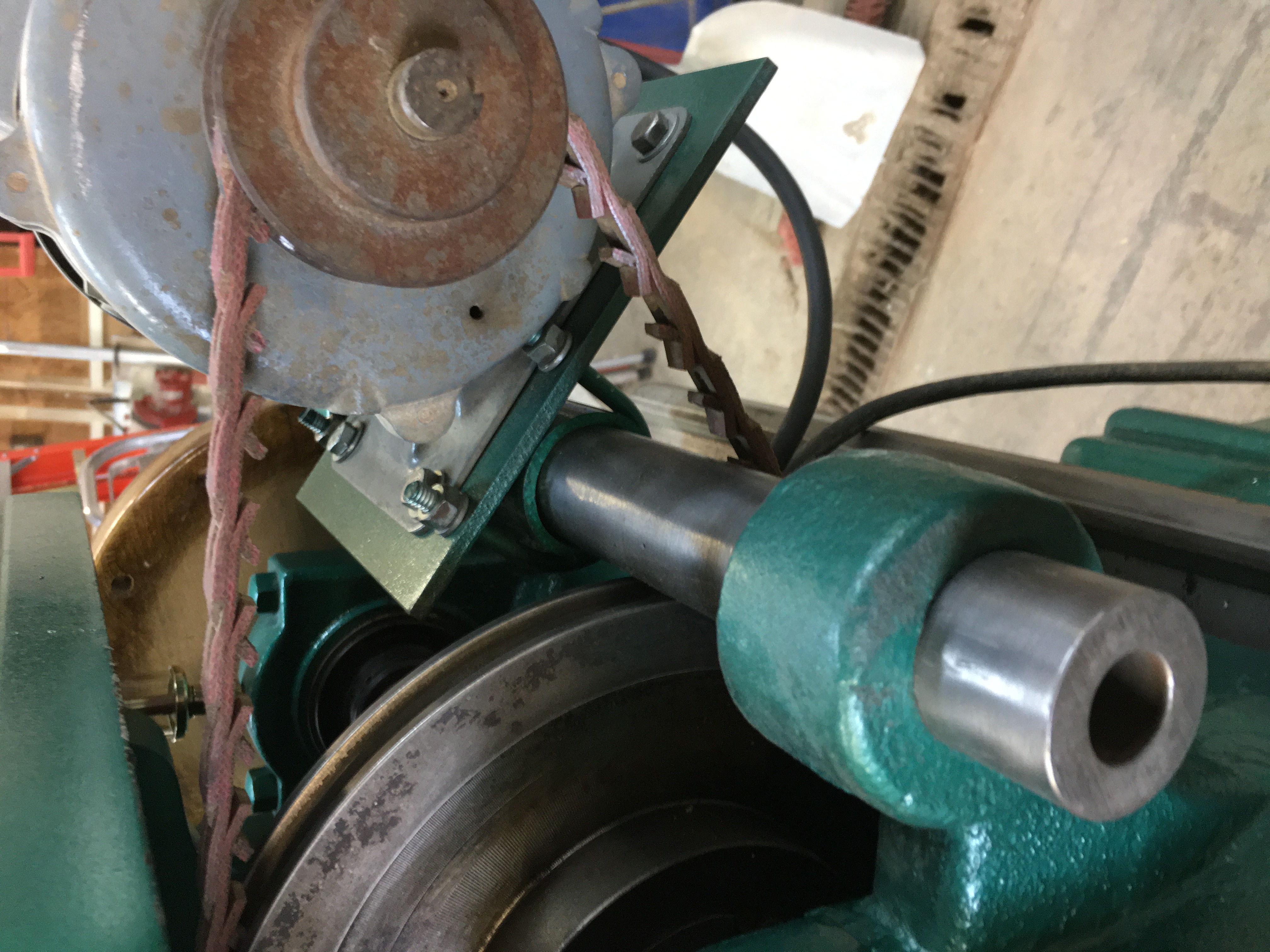

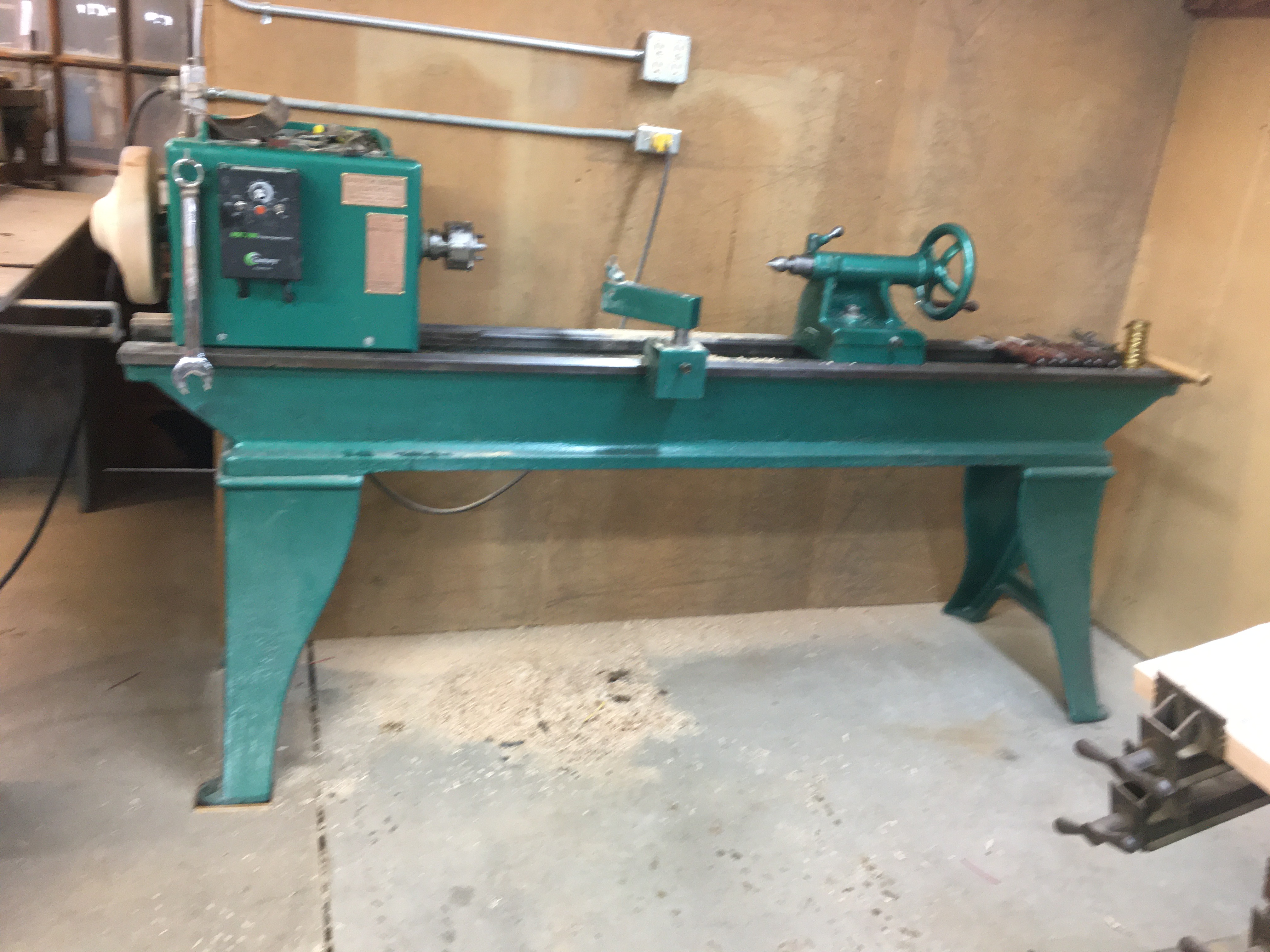

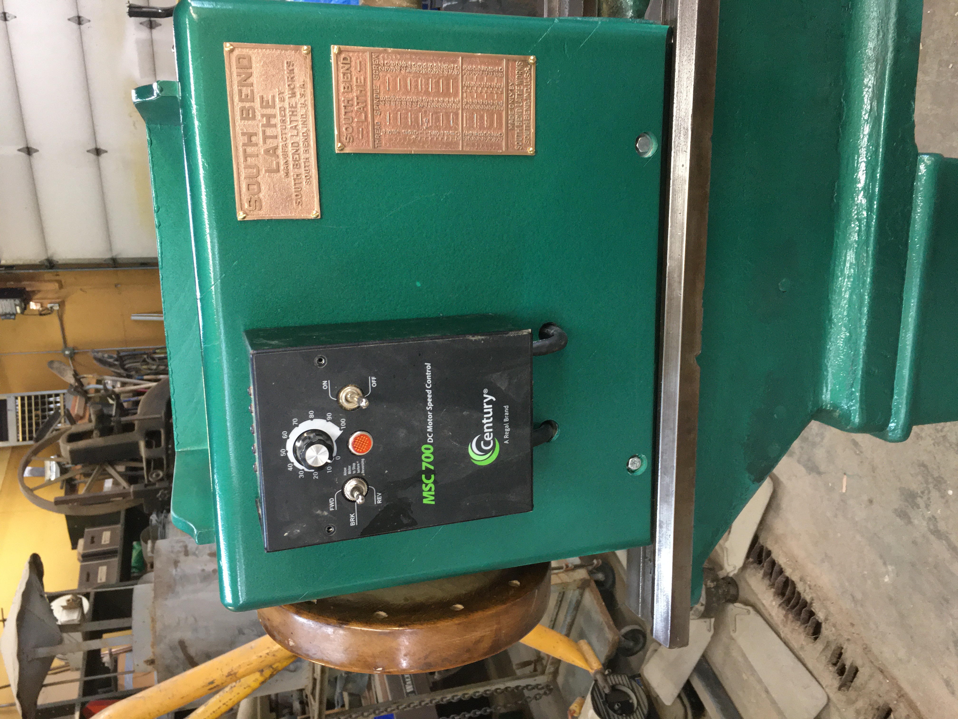

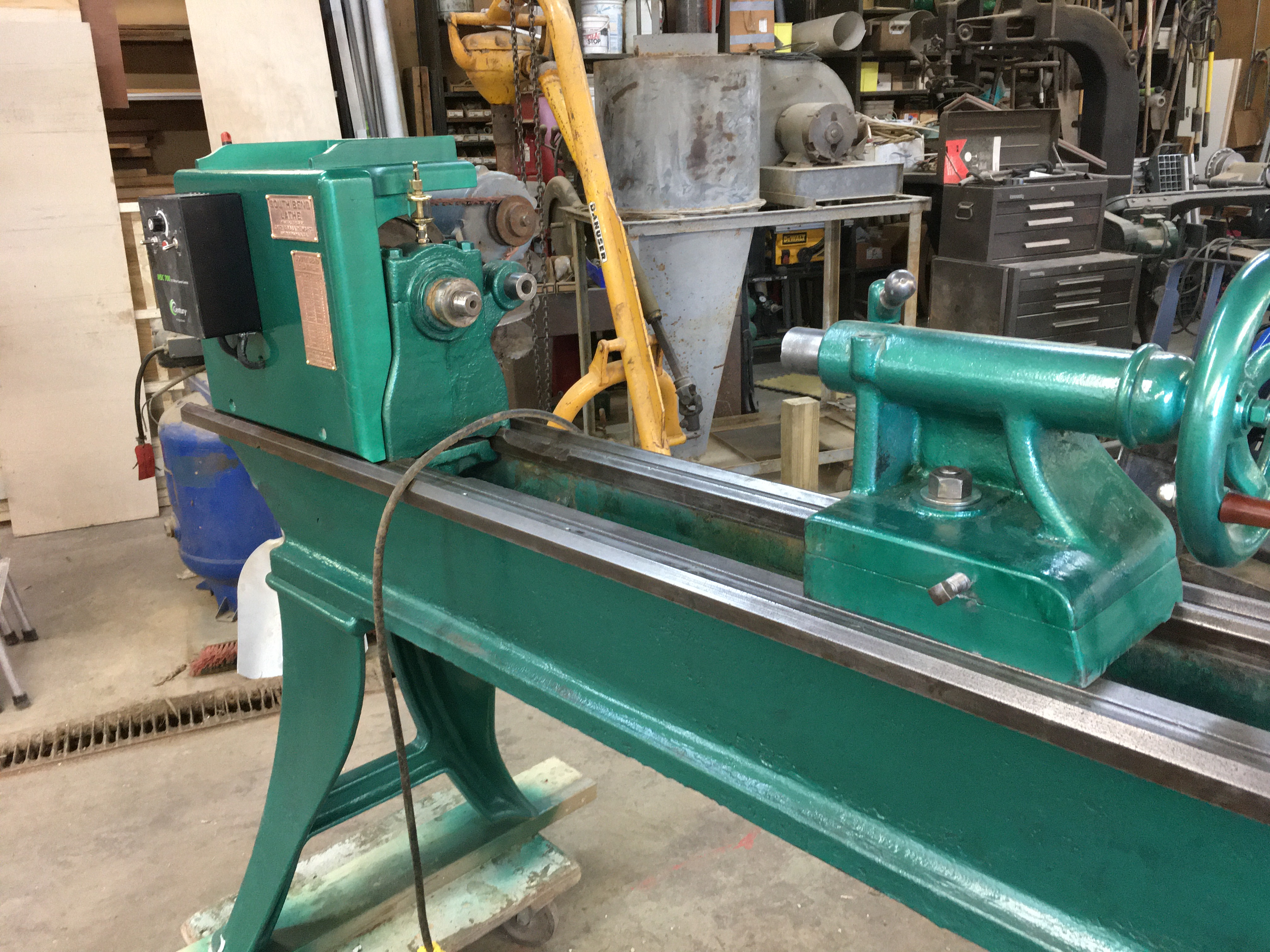

FB1FED9B-A3FC-41C3-9AE9-A353FE53B740.jpeg1159D404-F9C7-48FA-A31E-A76412B41685.jpeg5A516632-A393-433C-B270-42EB6F54C42A.jpeg1D5BD912-989C-4985-86D1-E05EC98C1DCF.jpegA new shop acquisition a couple months ago. This is a South Bend Lathe originally born in the 1920s or 30s as a Lin痴 shaft driven metal lathe. I have no idea about it痴 life history other than my late neighbor owned it and used it as a wood lathe for a number of years. I acquired it out of his estate and spent some time tuning it upl making it presentable. You got to love old iron. This machine weighs in somewhere around 1,500# and is still dead nuts on the money with no spindle runout. Currently powered by a
1 1/2 HP DC variable speed motor

Looks like someone stripped all the goodies off to make a dedicated woodworking lathe.
   / Todays shop time. #924
That is exactly what happened somewhere in it’s lifetime adventure.
However, it’s a rock solid wood lathe and light years better than the old Dunlap (Sears) lathe my dad had back in the 50s.
It came with three ‘Nova’ chucks and a variety of faceplates, three jaw chucks, chisels, and other stuff. Regretfully the last owner was in poor health and passed away two years ago so the machine wasn’t used for at least five or more years and was left in an unheated, wet barn. It’s incredible the damage humidity and condensation can do.

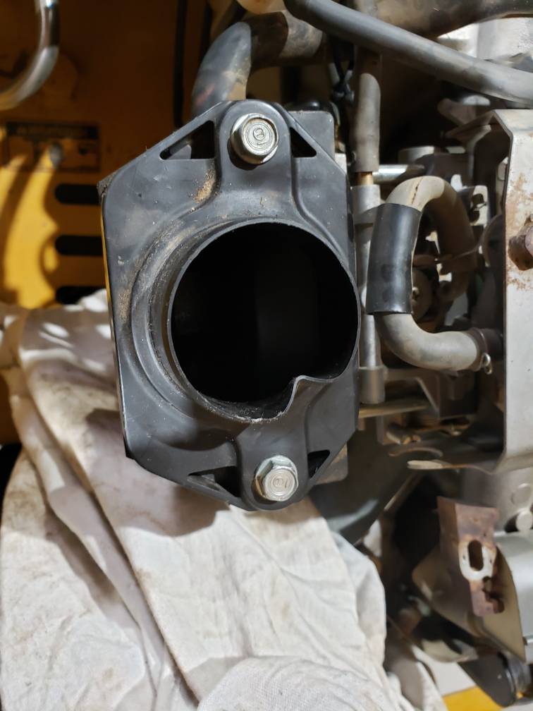

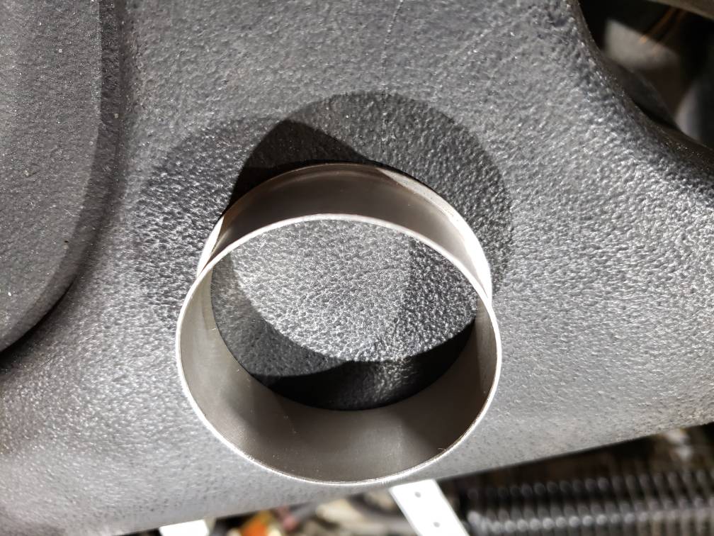

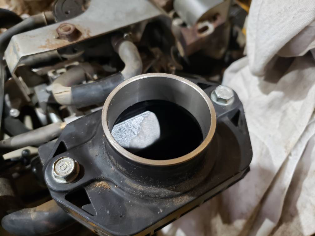

Little fun project that's been bothering me, the air cleaner adaptor on my zero turn is plastic and collapsed from the clamp holding the hose on.
Have been doing some maintenance on the mower and finally decided to fix it, was hoping I had some pipe that was close to save on machining time bit no luck.
Found some nice 2" mystery stainless TGP solid round and machined a backup ring.
Works good and now the dirt doesn't have way to bypass the filter!

Nice $250 fix!

Nice looks good

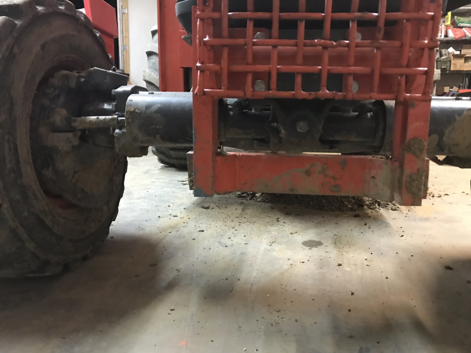

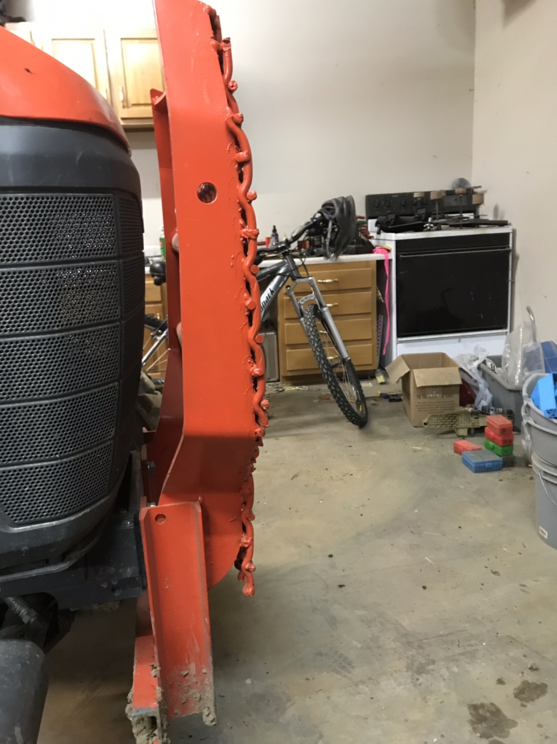

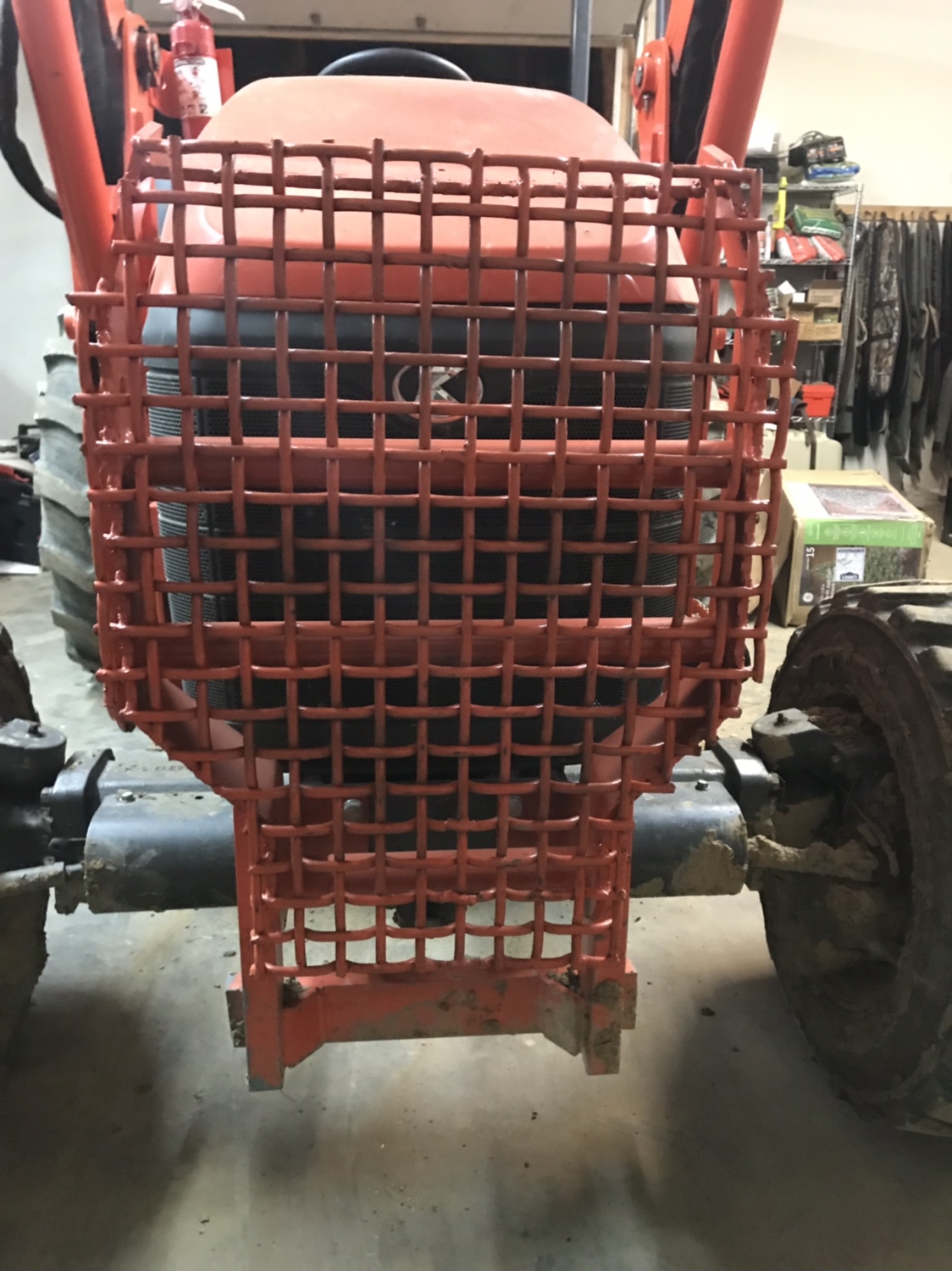

A member was asking questions about my brush guard and you can’t send pictures in a PM or at least I haven’t figured out how so I decided to post here. It’s a heavy piece of woven rod which is way overkill for the task. I found it in a junkyard so I have no idea what it started life as. Luckily the M59 brush guard is pretty straight because I couldn’t have bent it across a curved one. I intended for it to have a bumper to protect the tie rod but I mis calculated that and had to cut most of it off. Whenever I get around to it I’ll weld another piece on that’s bent to clear the tires. IMG_8547.JPGIMG_8548.JPGIMG_8549.JPG
