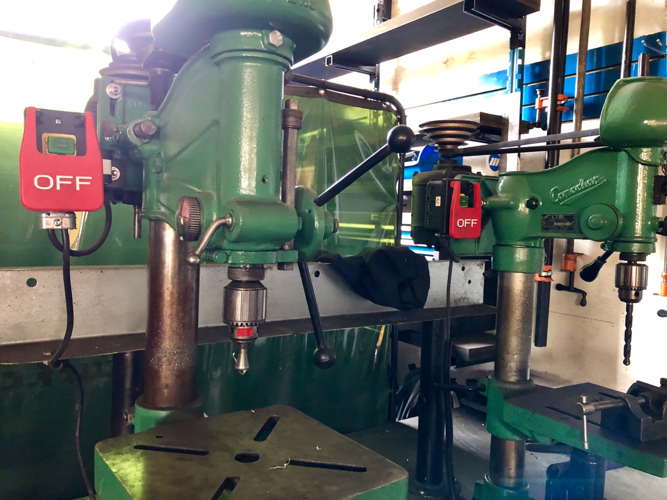

I thought it might be a safety issue too.
Add me to the list of that being a BAD idea.
Picture this. You’re holding down a piece of flat bar and the drill press belts slip or the drill stalls when the bit breaks through.
You let go of the workpiece in order to reach for the switch. The drill then continues to turn spinning the workpiece like a propeller.
Mount the switch on the machine. I added paddle switches on mine. They’re cheap on Amazon.

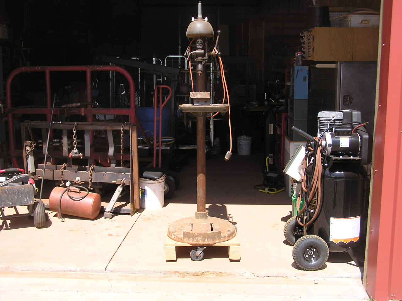

My drill press was modified long before I got it. They mounted a momentary push button floor mount starter switch (like the ones used in cars back in the 1940's) in the left slot of the floor plate. Very safe, the motor only runs while I am pressing down the switch with my left foot.

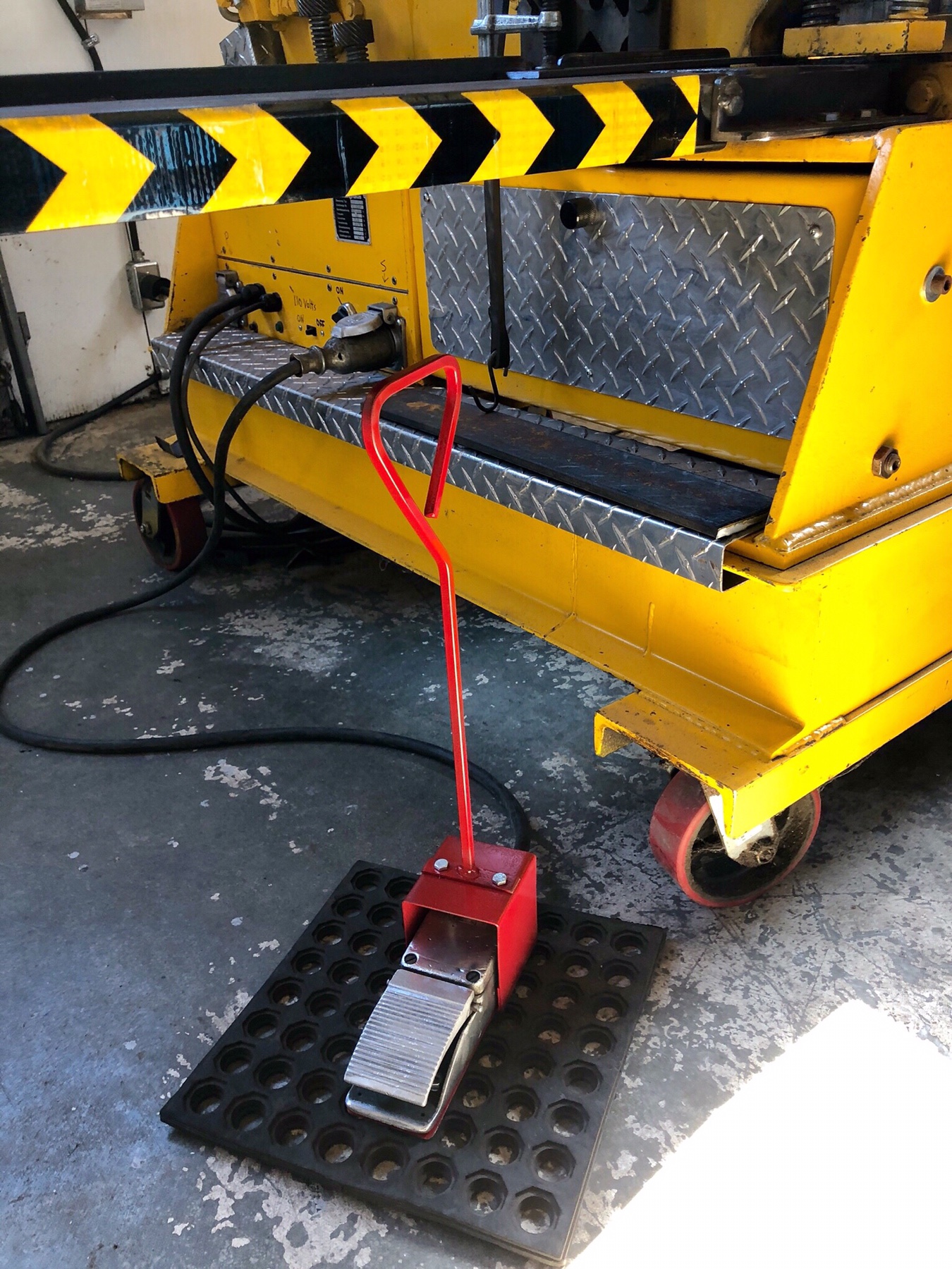

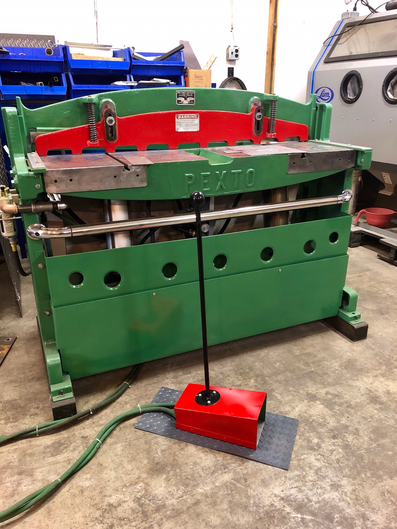

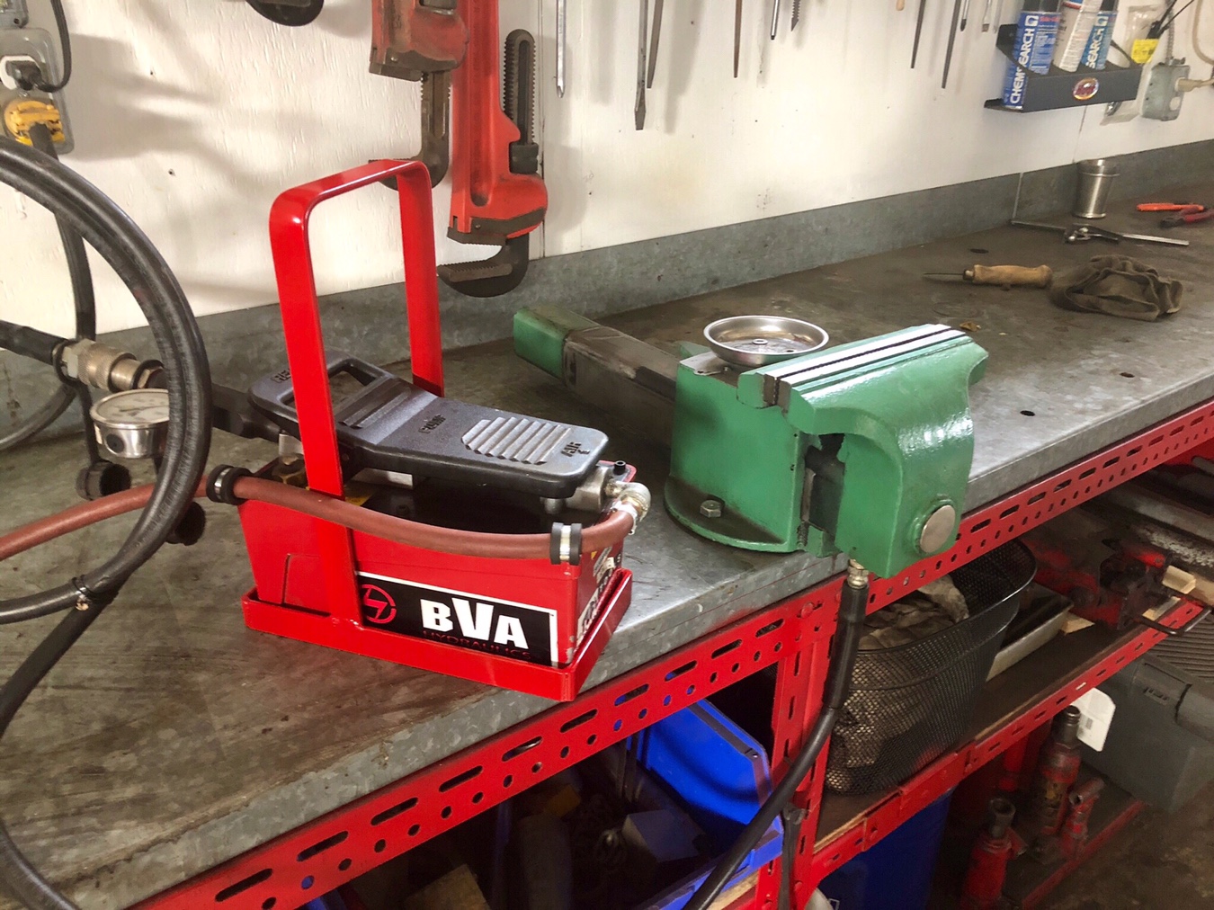

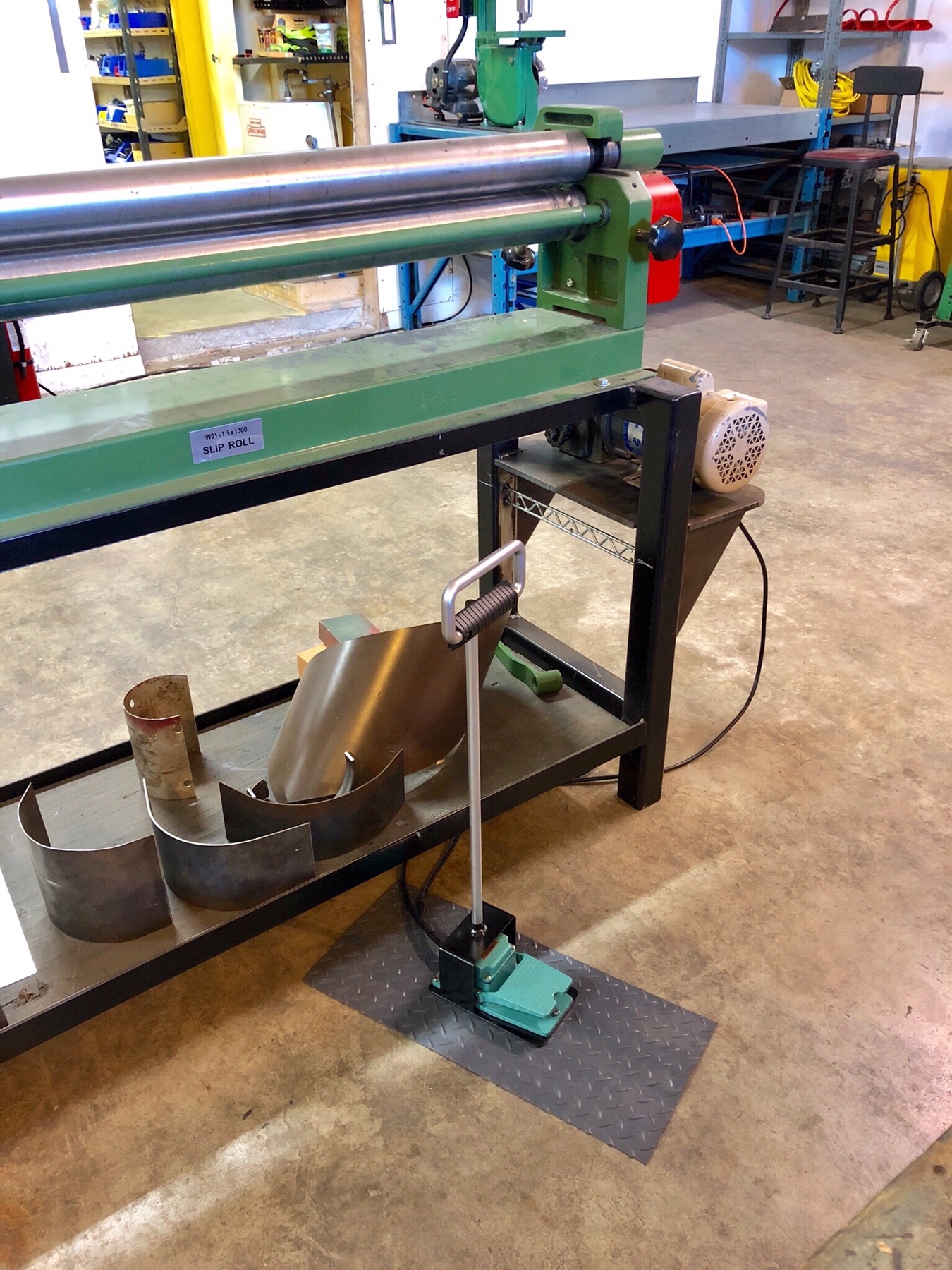

I added handles to my foot switches for easier relocation. Bending over gets old when....you’re old. :)

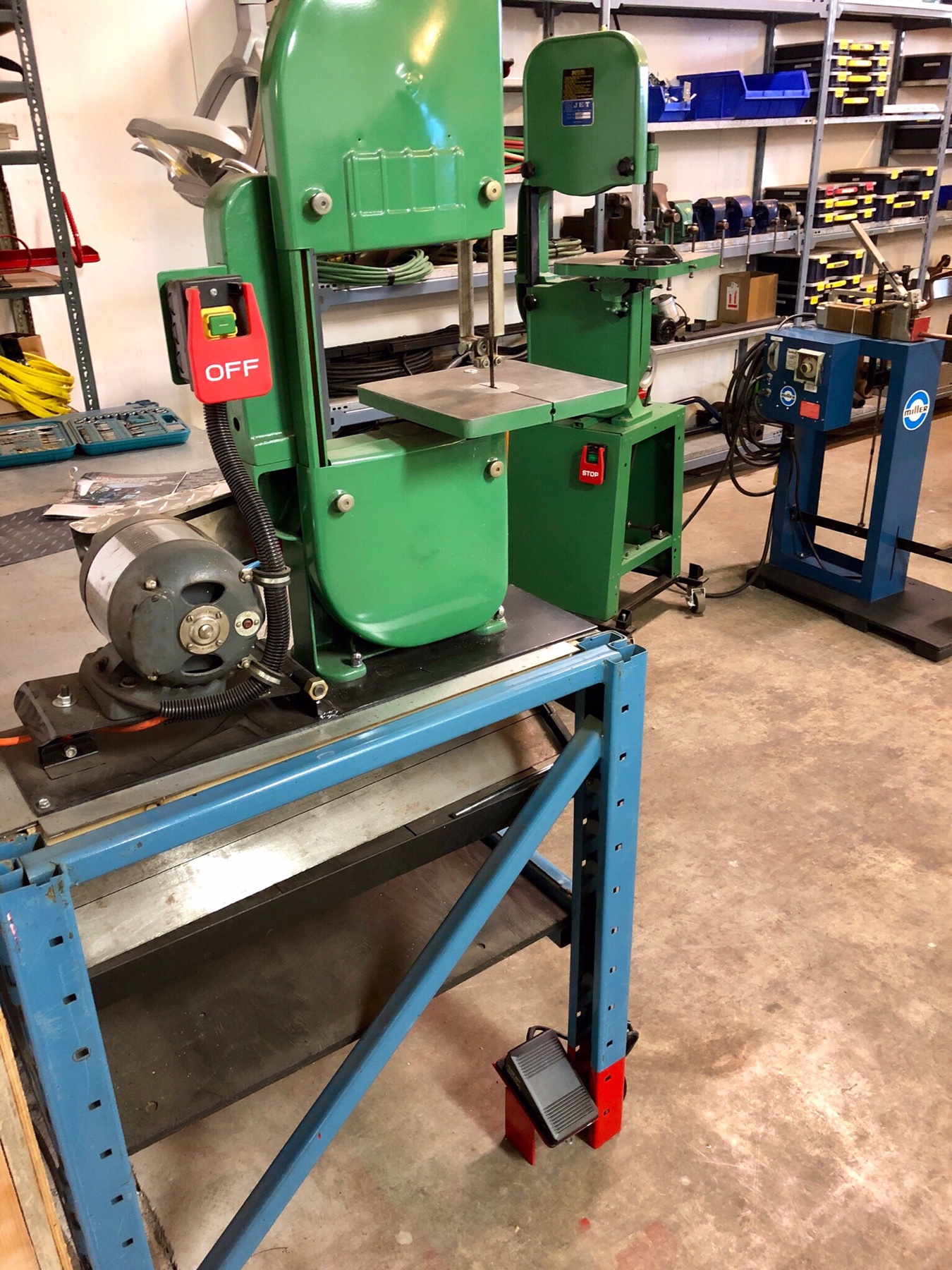

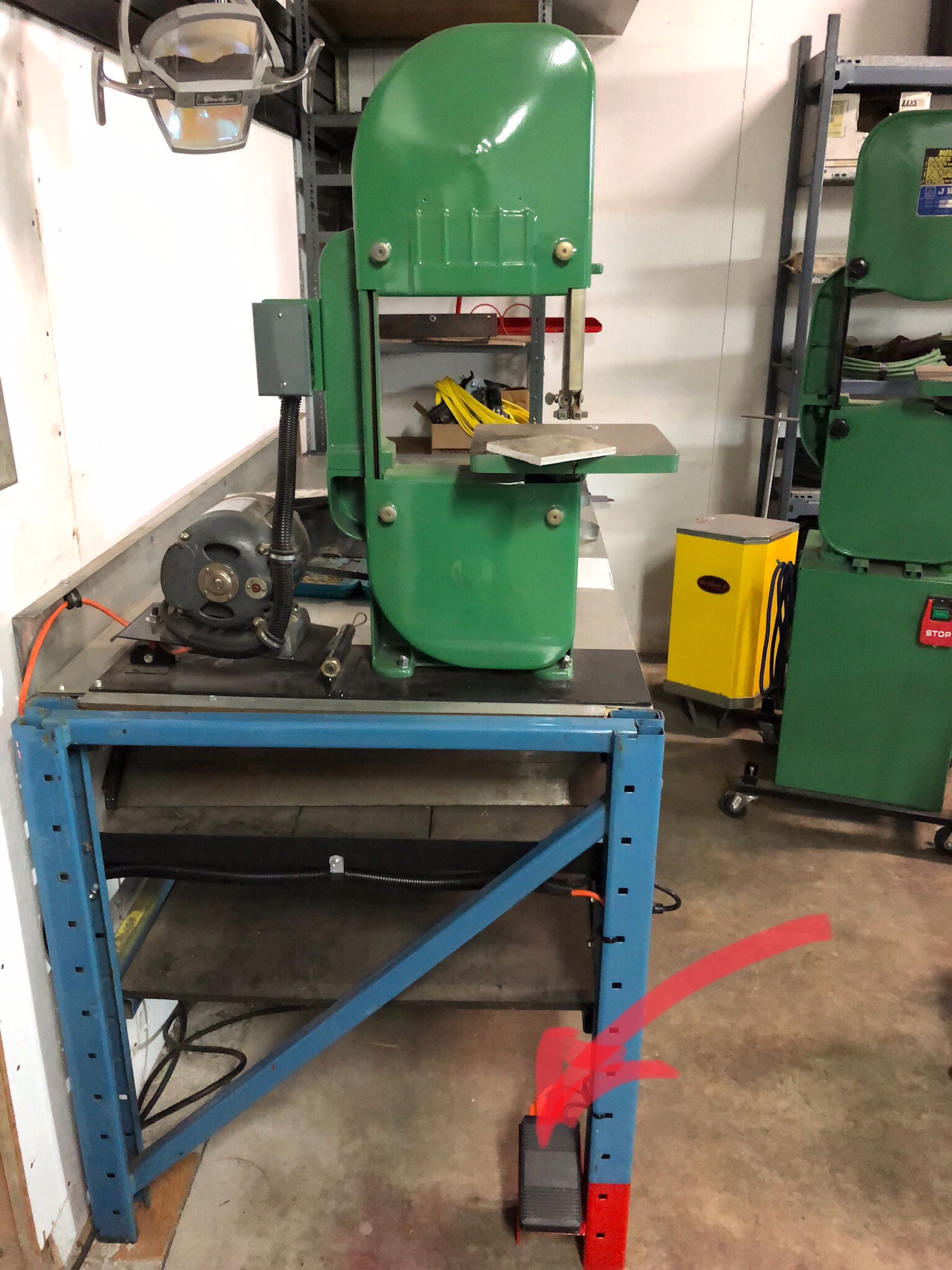

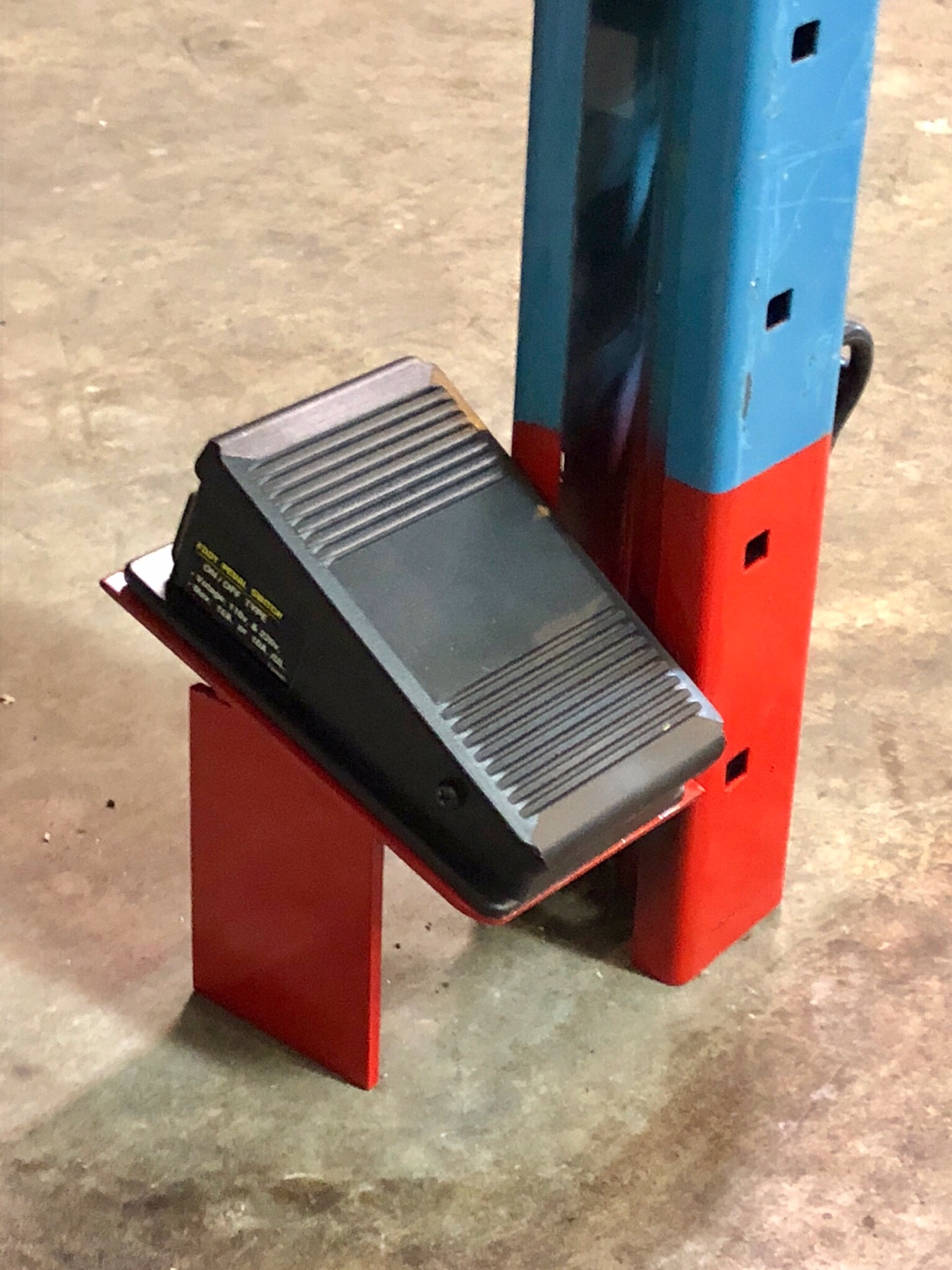

And I thought I was being clever mounting this bandsaw footswitch but in reality it doesn’t enable a stable working stance IMO. I will prob relocate or remove it.
