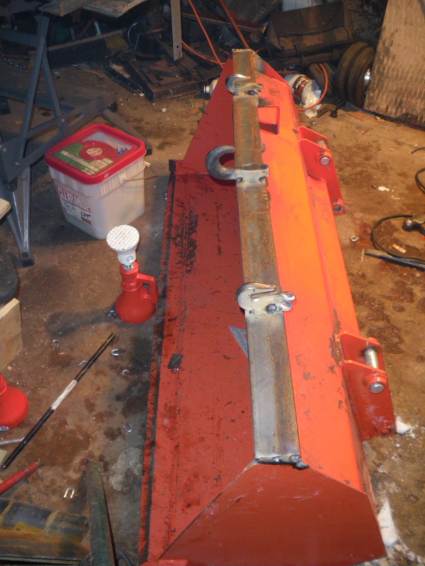

While the tow hook is rated for 10,000 lbs in a bolt on configuration, they are forged and weld on pretty easily. I can't lift much more then 1100 lbs so I am not concerned about my welds. Besides go to any trailer place and they sell a ball mount with 3 ball sizes and a tow hook all welded to one receiver mount.
