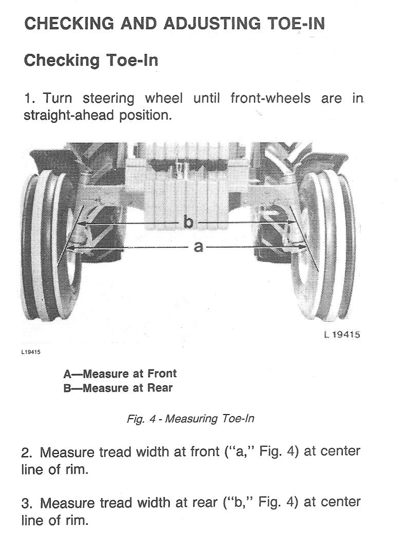

How do I set the toe in on my John Deere 2240 after replacing tie rod ends?
/ toe in on tractor #2
Measure the distance at the middle point on the front of the tire on the center rib across to the same location on the opposite tire. Measure at same location on the back side of the tires.
Toe-in (I don't have that model off-hand) is generally front and rear measurements are equal (0") or 1/4" toe-in meaning the front measurement will be 1/4" narrower than the rear measurement.

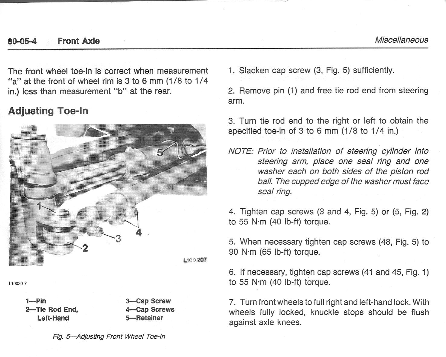

Adjusting both rods so that there is an even amount of thread showing and a toe-in of "roughly" 0 to 1/4" would be the ticket.
Attached are the instructions for a 2350 and 2550. Same idea and procedure. Toe-in0002.jpgToe-in0001.jpg

Ok, we measure an inch off. Turning the rod threads in and out doesn't change the measurement. I have the big bolt out of the clamp and loosened small one to turn it. (on John Deere)

Why is the measurement not correcting as I turn the tie rod threads in and out to the next slot?
So you loosened the bolts on the adjusting sleeve? I am not completely understanding could you post a pic?
