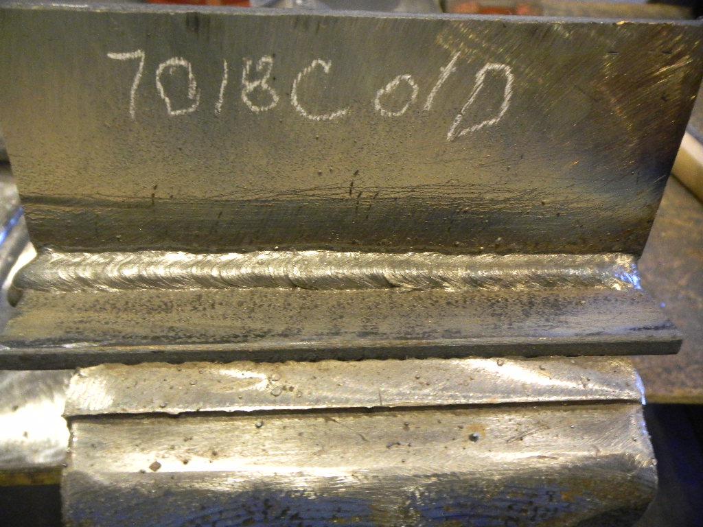

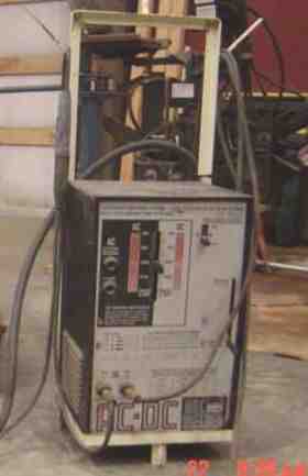

The thought never crossed my mind to run 7018 on AC until joining these tractor forums. So awhile back I gave it a try with my old buzz box. The noise really set me back:shocked:! About the only thing I noticed different was I could not get the weld to wet out like on DC. But I had no problems with the machine cutting out at all.
I just wonder if something isn't wrong with your machine?
Here's the machine I used, and the weld. The 7018 I used never seen the inside of a rod oven.
