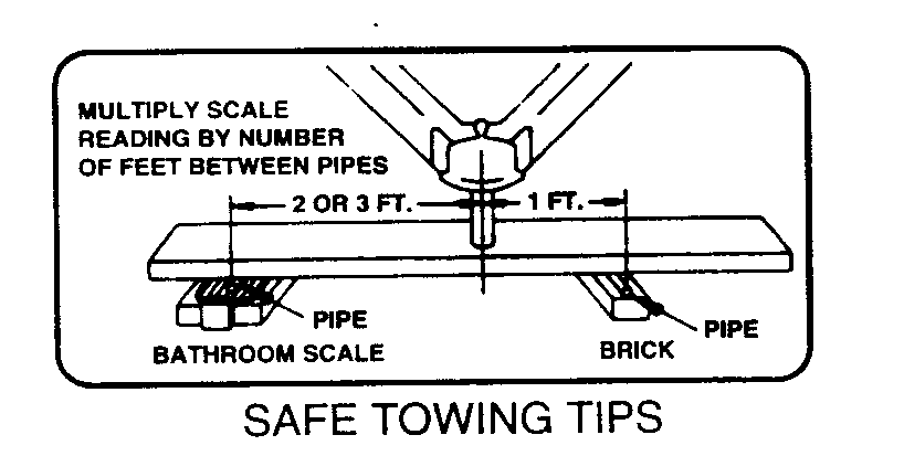

I live about 15 miles south of the Washington Monument. Do you think I could use their elevator? :)
Seriously, a lot of us don't live near elevators or scales. But probably more of us have bathroom scales and a board.
