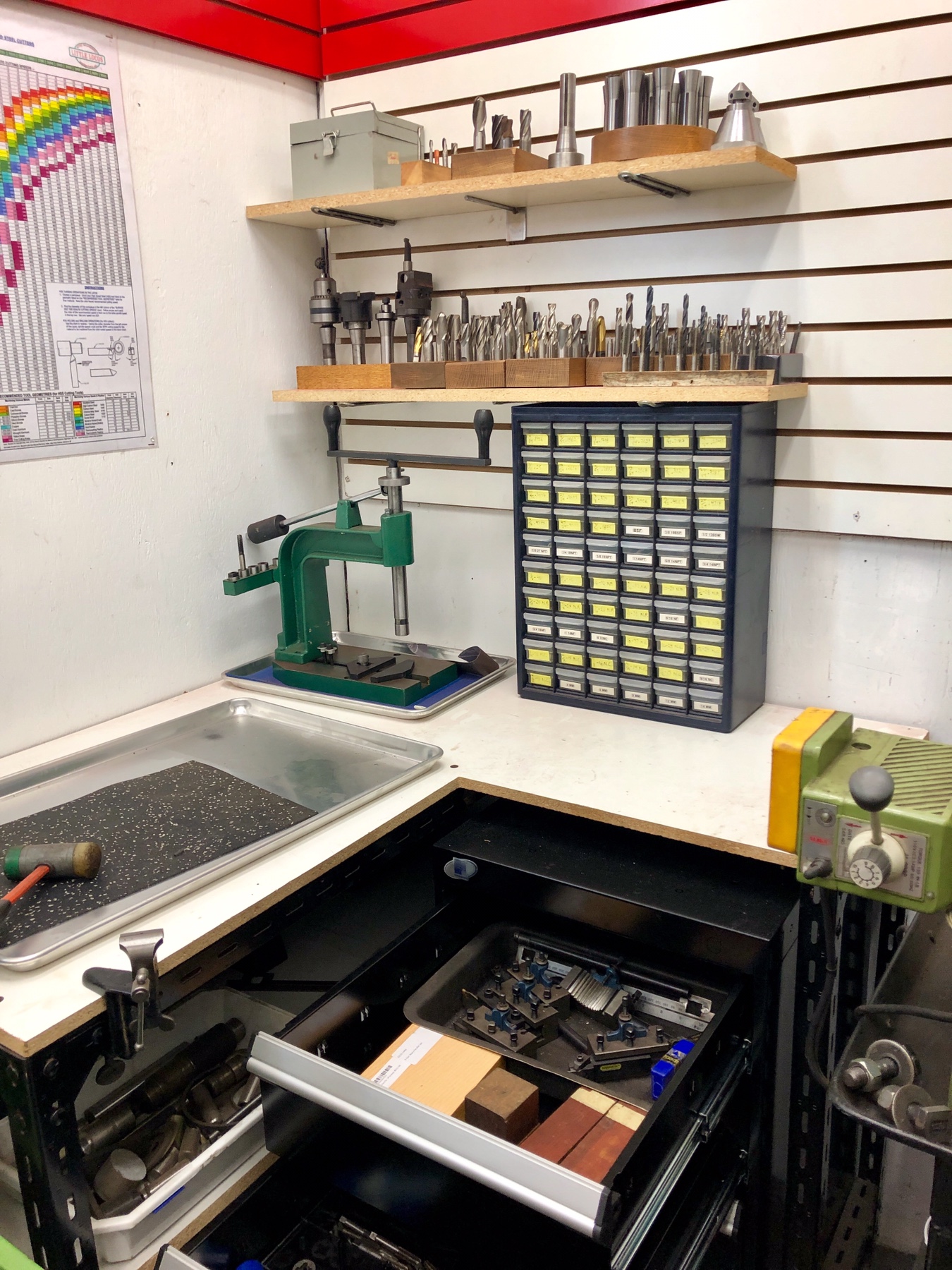

My two bits worth. Stay away from the round column mill drills, period. Been down that road, she's a bumpy one. The ideal would surely be a BP or clone, but reality sets in and unless there is an abundance of metal shops around for used used equipment, not going to find one. Mine is a square column Grizzly bench model. Fairly heavy, around 700 lbs, will do most jobs. And yes, the tooling quickly doubles the mill purchase price. Once set up, worth every penny though. Need to fix or build something, no problem. Lathes make square things round, mills make round things square.
I agree. I’ve had my square column mill drill for twenty years.
A few years back I picked up this BP clone for well under $1000.
Don’t be afraid of paying a little more for a decent machine that includes tooling. Buying pieces individually can easily outweigh the price of a used machine.

Also consider cost, space, power. The full size knee mills (Bridgeports etc, if you will) are great---they also take up space, are heavy (top heavy) and generally are 220 3 phase. An appropriately sized phase converter can approach the cost of a used mill/drill. Got a 220 30amp outlet available or going to have to hire that out? Moving/transporting/placing a full size Bridgeport can be pretty pricy. And while it is possible to get a mill/drill up and down a set of basement steps, that isn't possible with a knee mill. The need to rebuild/replace sacked-out ways is not uncommon on heavily used equipment
Towards the end of a 2 year machining program at a community college, I was offered a well used, round, single phase grisly mill drill. With the proper technique (no climb milling, correct speeds and feeds) it would keep a .003 Tolerance across 6 inches--adequate for a lot of the spacers, brackets and doo dads I needed to make. It was 1/18th the price of the new full size knee mill it was replaced with.
As someone else mentioned, the machine is just the beginning of the investment. Tooling (cutters, face/end mills), holders (vice, clamps), coolant and precision measuring equipment will all drain your pocket book. And once you invest, its nice to have a heated year round heated place to put it. If not coolant becomes a liability and condensation an enemy
Good luck. I thoroughly enjoy my metal working equipment. Will never break even. Getting some trade/tech school (Fox Valley) training would jump start the road to success.
