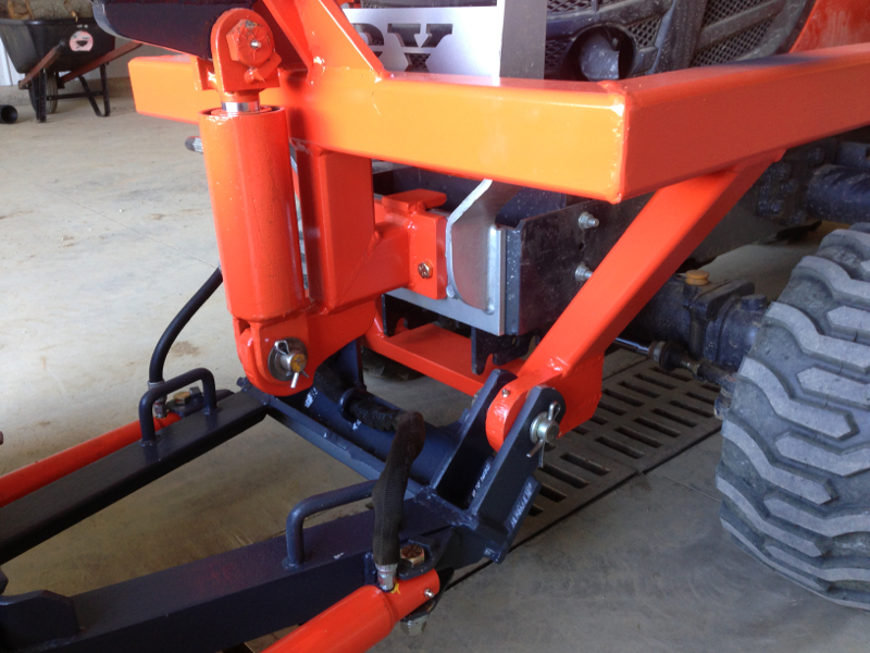

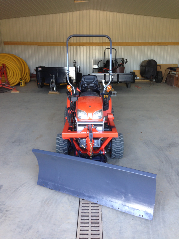

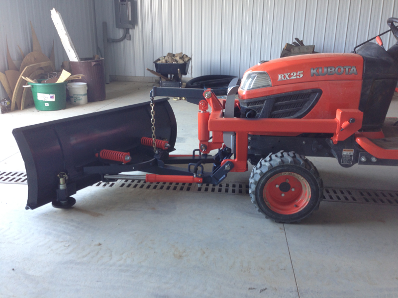

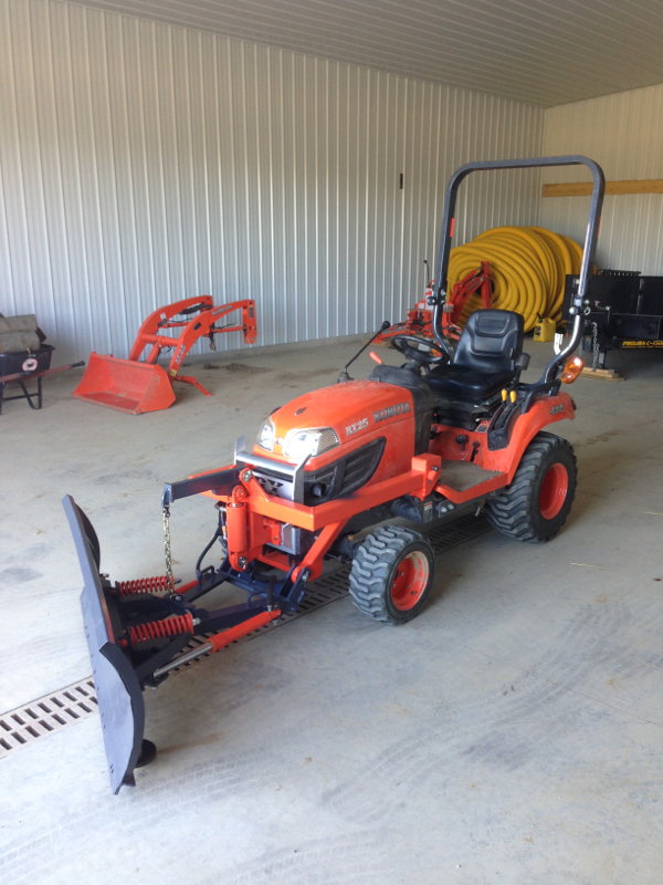

Very nice job and design, Nice welding too. I'll bet you can't wait to try that baby out.

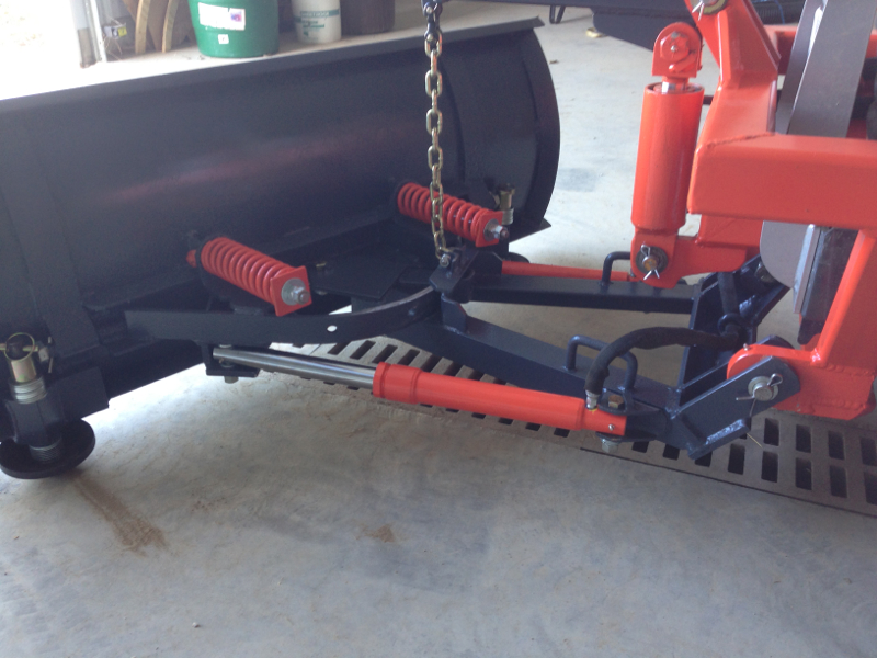

Just rec'd a new snow blade for my B-2620. Can't wait to enjoy the hydro angle feature I was getting tired of jumping off to pull a pin and change the angle of the blade. Probably means that we won't have much snow.

Nice set up. Nice big blade. Mine is a 54" blade, but if I could ever find a beat up 60" for cheap, I upgrade it. Maybe put up a video of how you mount or dismount it when you get a chance. Only question I'd have on your set up is that you won't have down pressure for scraping, but that may not be an issue if the blade is heavy enough.

Very very nice job. I am curious to hear how well the tractor will handle the plow, specs show it is near 1600 lbs.

I seriously can't wait to get out in the snow with this new set up!
Sandyc I know the pain of jumping off to pull a pin to change angle. Having hydraulic angle will be a huge time saver!
Thanks CHDinCT! This is a 60" blade and I think it fits my BX perfect. Down pressure shouldn't be a problem this set up has a good amount of weight to it. But I guess time will tell. Ill get a video up next time I'm out at my shop with some extra time.
