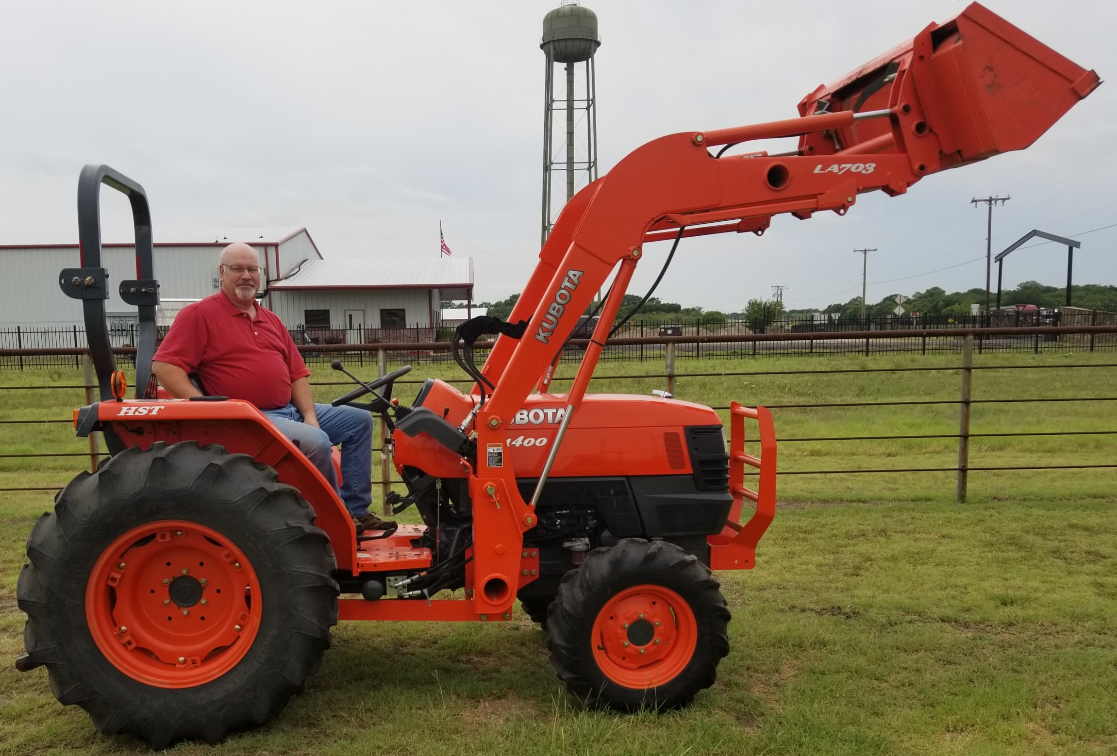

Went with the L4400, '08 - 157 hours on it.
Test drove a L3901; it felt a little light after having been on the MX4700 ("light" being relative, everything's a matter of perspective, right?)
The 4400 seemed to be the sweet spot in between: still in the compact category, but heavier than the newer 01 models, and with a more substantial FEL. I shouldn't have any issues hauling it with my 1/2 ton truck. The HP at the PTO ought to be enough for me to add most implements I might consider. The fact that it doesn't have the emissions crap on it is a bonus, and less than 200 hours to boot!!
It was plainly taken care of, but sat for a time in a shed; the owner went into a nursing home and the wife finally decided no one in the family was going to use it. I'm going to pick it up Tuesday - a 3 hour trip I'm highly anticipating. My first order of business is changing the oil/filter, checking the belt and other fluids and filters. I've already talked to the parts department at my local dealer about filters, oil, and other consumables. Could have ordered online, but many posts here urge a relationship with locals. Still need a good operator's manual. Anything else you recommend putting under the microscope?
Putting up a photo my wife took, ignore that old, fat balding guy sitting on it. :D

Greasing is the second most frequent maintenance on my L3560, after fueling.
Kubota calls for FEL to be greased every ten operating hours, the balance of the tractor every fifty operating hours.
Get a cartridge grease gun and a Lock & Lube coupler for the gun to zerk connection. Coupler is value at $30. Moly grease is Kubota standard.
I would secure a rag around the PTO splines and dampen rag with Blaster, WD-40 or diesel and let it soak. I bet there is hard material in the indentations which will make connecting a PTO shaft difficult until crud is dissolved and wiped out.
Clean the battery terminals and apply electrolytic grease. If you track down this specialty grease (Amazon/eBay) you will only have to grease the battery terminals once every five years.
Congratulations on the Kubota. You hit the sweet spot, indeed.
