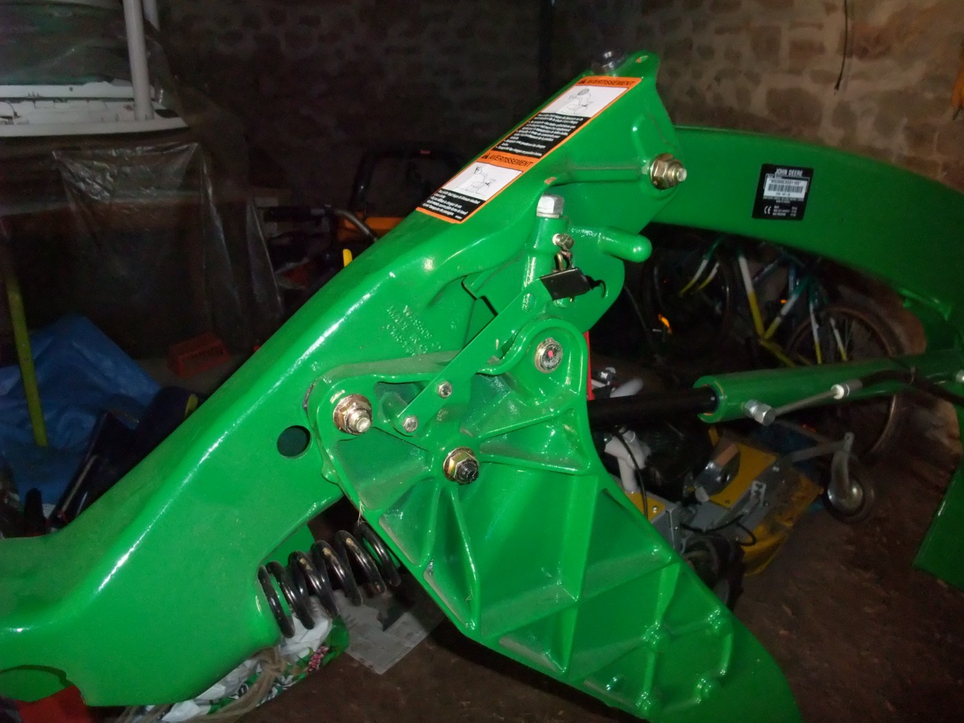

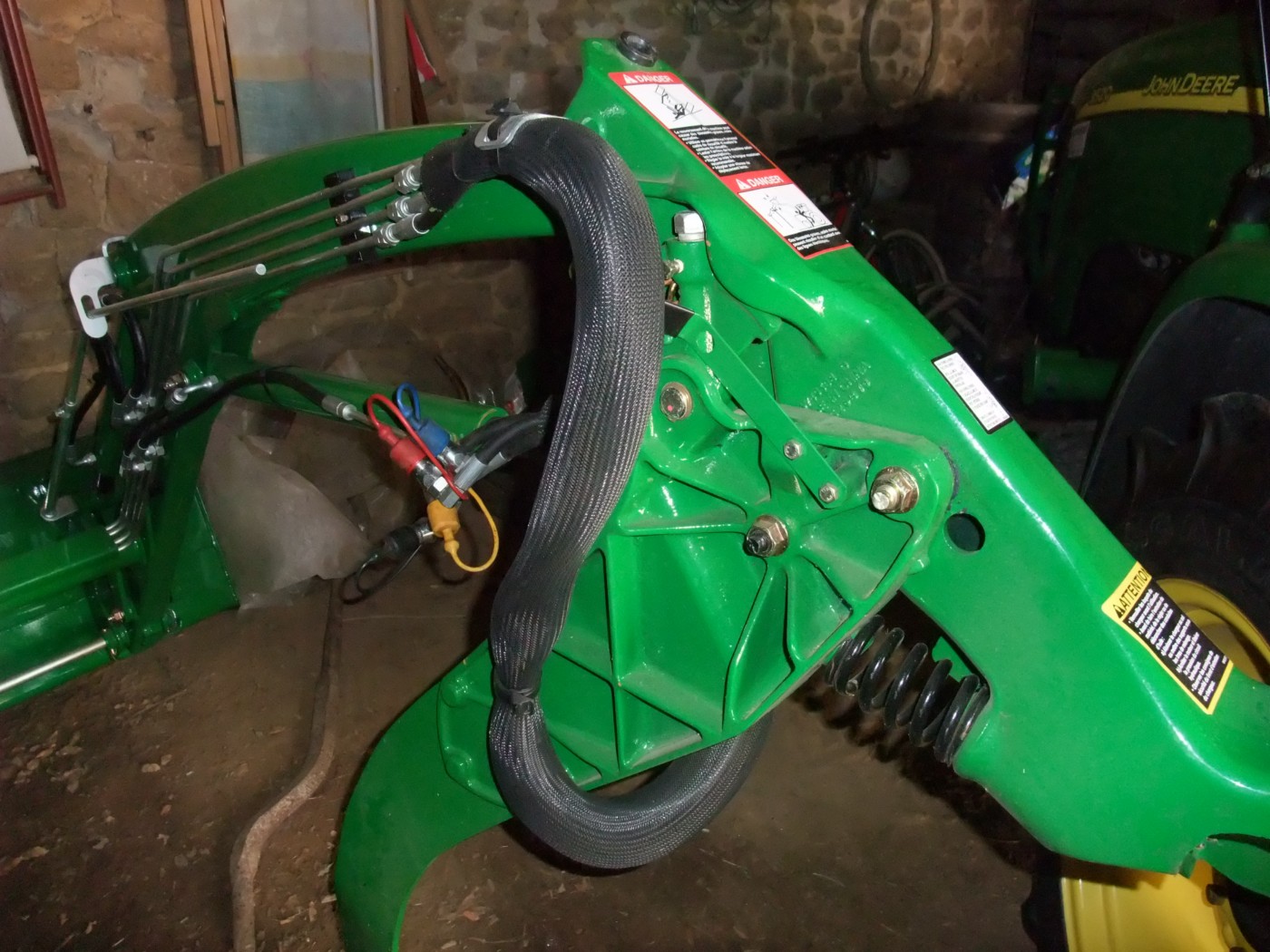

My 300cx loader has a black mesh over the lines. I think this is a safety net? I have heard this fluid is very dangerous if it get in you body as mentined above. I read the warnings one rainy afternoon.
The black mesh is only at the back, where the lines might rub against the body of the tractor.
