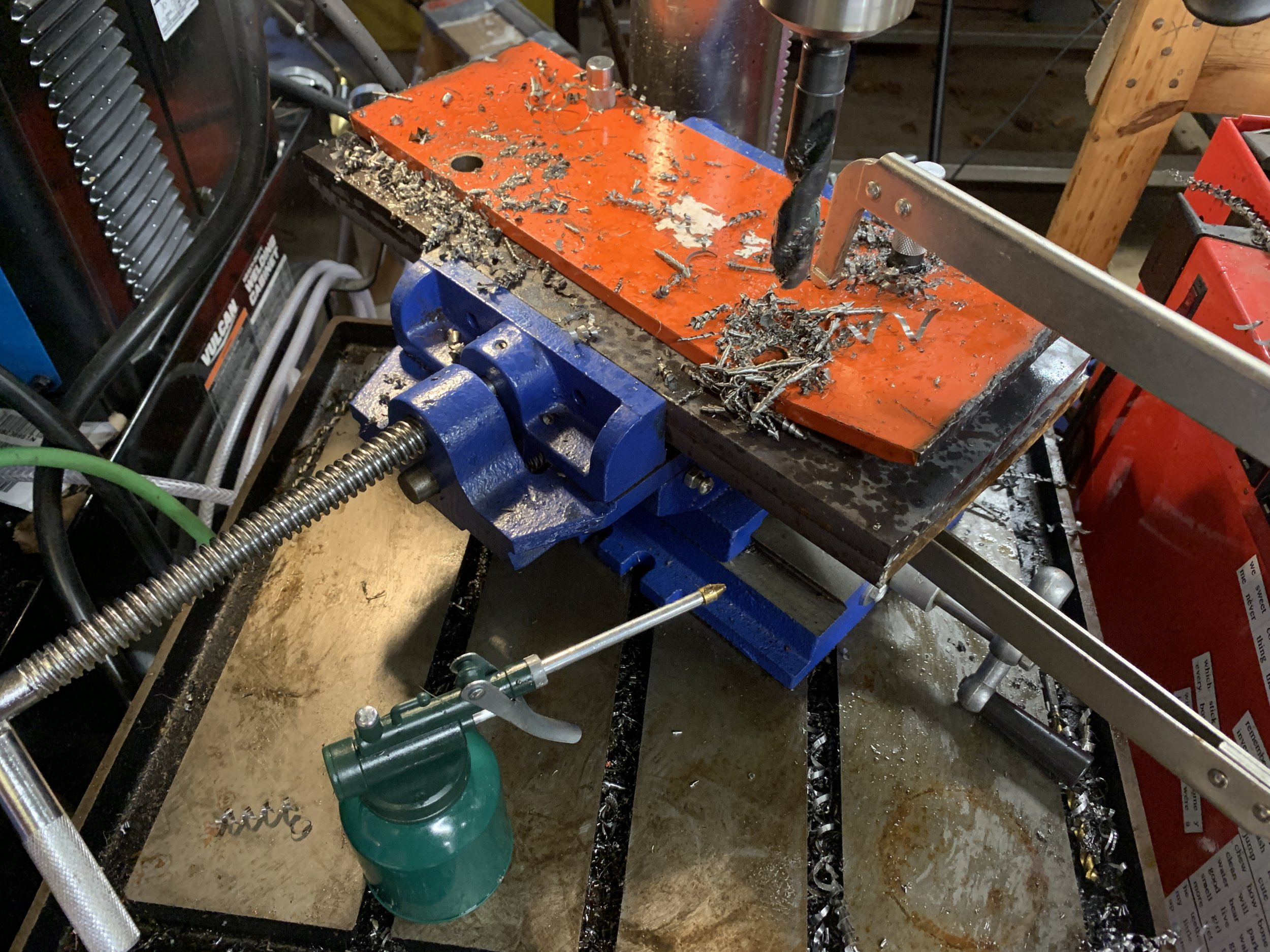

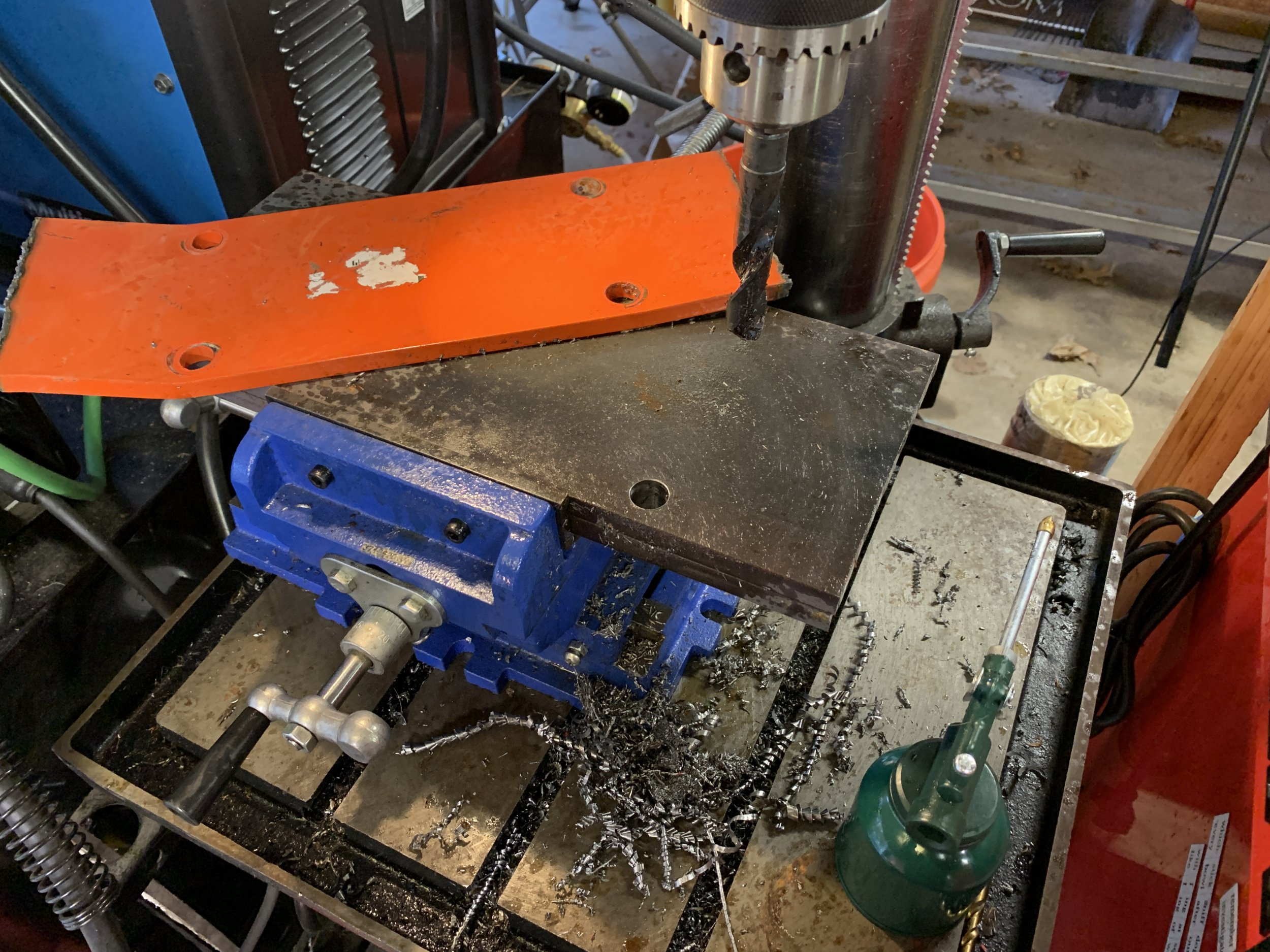

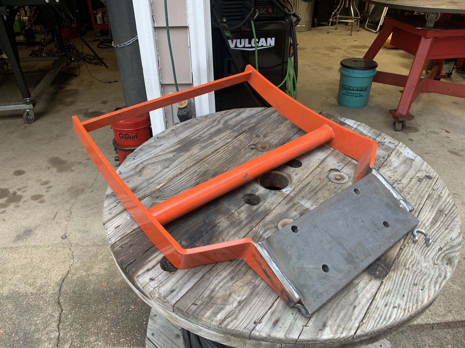

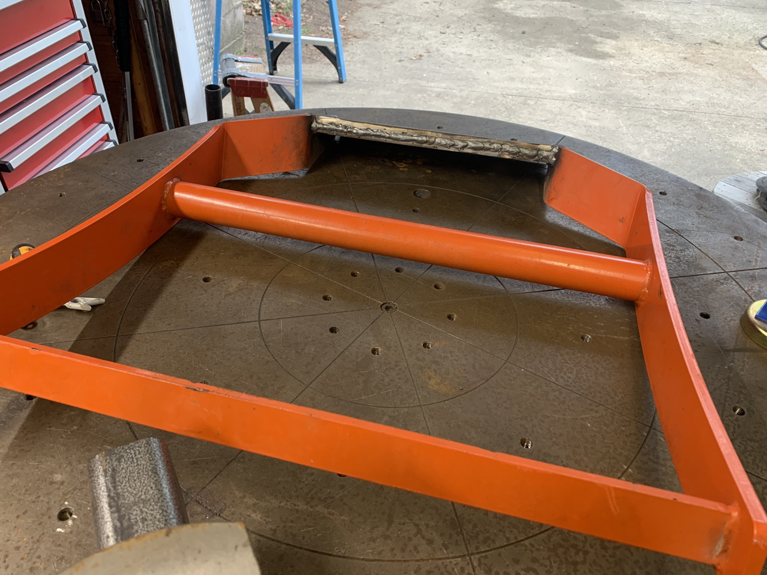

My brush guard bends if you breath on it. I don’t know how many times I’ve pulled it out and away from the hood of my tractor. The brush guard is near useless and so finally I cut out the-frequently-bent-and-bent-back, 12mm plate that it uses to bolt into the frame of the my tractor, laminated two 1/2” plates and welded them into place. I recognize that the brush guard bolts into pretty flimsy frame material, but if that starts bending, I can cut that off as well and remake it with stronger, better material. I’d show some photos of the reinforced brush guard bolted on, but I had to order in 14-1.5x60mm bolts and I’m entertaining cutting out on my plasma table an Immortan Joe grill insert to match the “what a lovely day” Immortal Joe sticker that I have on my tractor’s rear window. Trouble is I'm just not that into skulls

Here is the often bent and then bent back base plate that bolts onto the frame. It is a pretzel. At any rate, when the longer bolts arrive and I test fit this thing, I'll decide at that point if I'm going all-in on making a folding version that would necessarily require beefing by also laminating the sides in order to support the twiddly bits. As it sits, I'd kinda like to get at some other projects—especially swinging around to making some boat fix-it videos.
