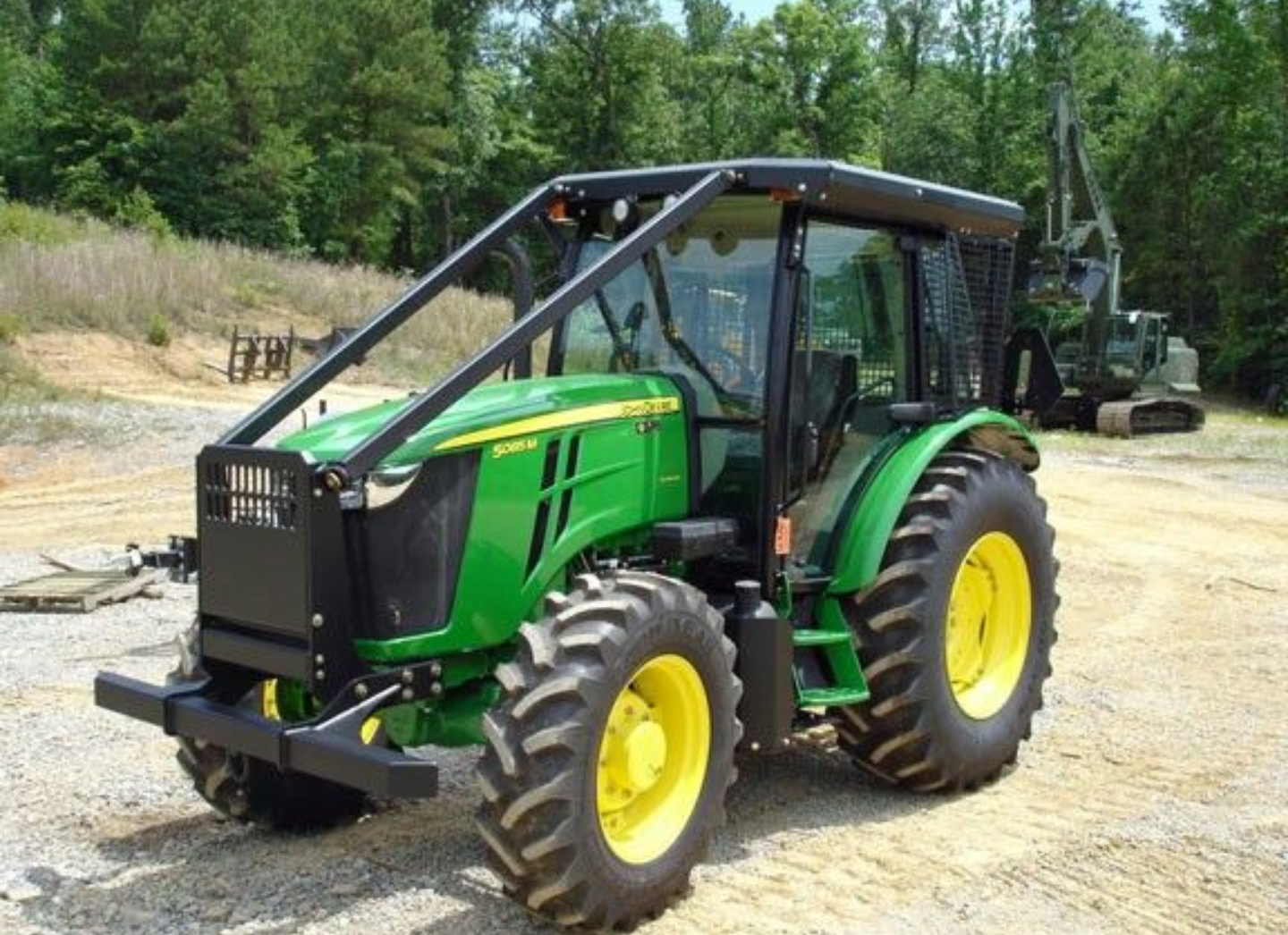

Stacking brush is a little different. It's fine in concept, but twigs and branches are going to get away. And the **gard thing in this case, whatever it's called, is lightly made and weak. (Whatever it's design intent, it's not working well for stacking brush piles.) If we're going there, maybe this would be more in order:
It's a bit more, but would seem a better improvement. After all, what's going on is more like small scale forestry.
At this point, the real estate that I purchased this tractor to clear out has largely been cleared and nowadays this tractor mostly picks up fresh windfall trees and what I've knocked over with my payloader and is going over areas that I've already brushed out multiple times. Even so, the front end gets occasionally dinged from stacking log slash.
That said, I wanted to make a nice insert for the brush guard this go around but time constraints are pressuring me to get other stuff fixed. While I like your idea of building extensive guards, insofar as armoring up an NX series tractor that has a cab would really require some extensive fabrication as the six 12mm bolts that hold the cab top onto the cab's ROPS screw through thin metal tabs up and into nut plates that are inserted into fiberglass. As such, in my mind, a cage would require its own A and B pillars coming up from the base of the tractor (requiring a subframe to be built) and continuing up and over the cab resulting in some mad-hatter look unless one was willing to cut into the fiberglass top and risk mouse intrusion.
In my mind, the effort is better spent on buying a properly tracked forest mulcher.
