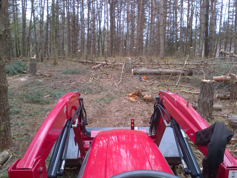

Got her on Friday and have been putting her to work. A couple of guys gave me a quote of 6k and 8k to clear about 2 1/2 acres of red pine, price does not include stumping. Just for giggles, I cut a 12" pine about 4 feet from the ground, choked a chain around the top part, and the 5035 popped it out of the ground like it wasn't even there. So, I figure I'll save some money for implements and cut it myself.

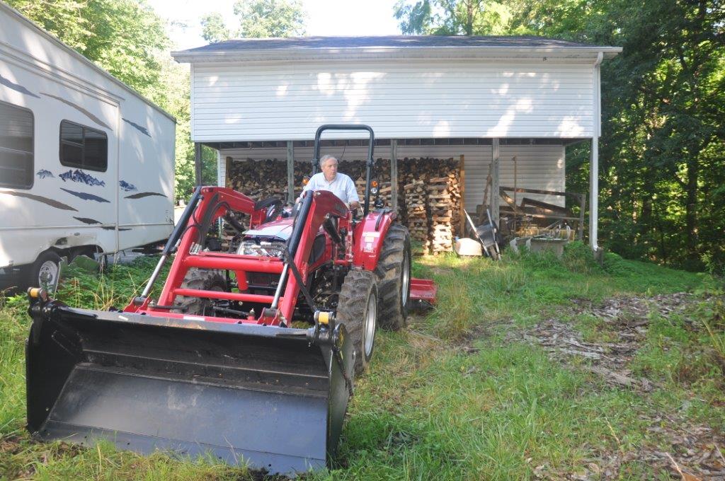

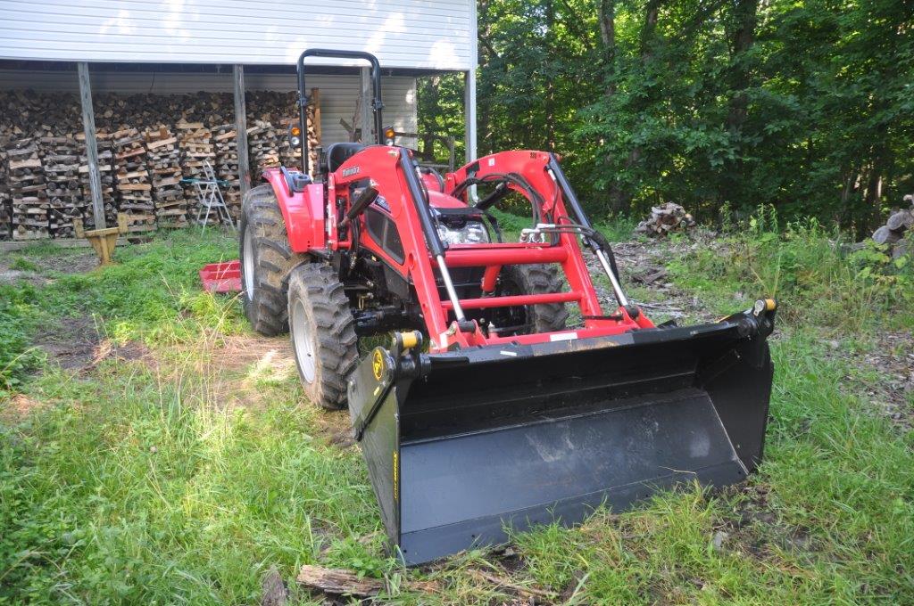

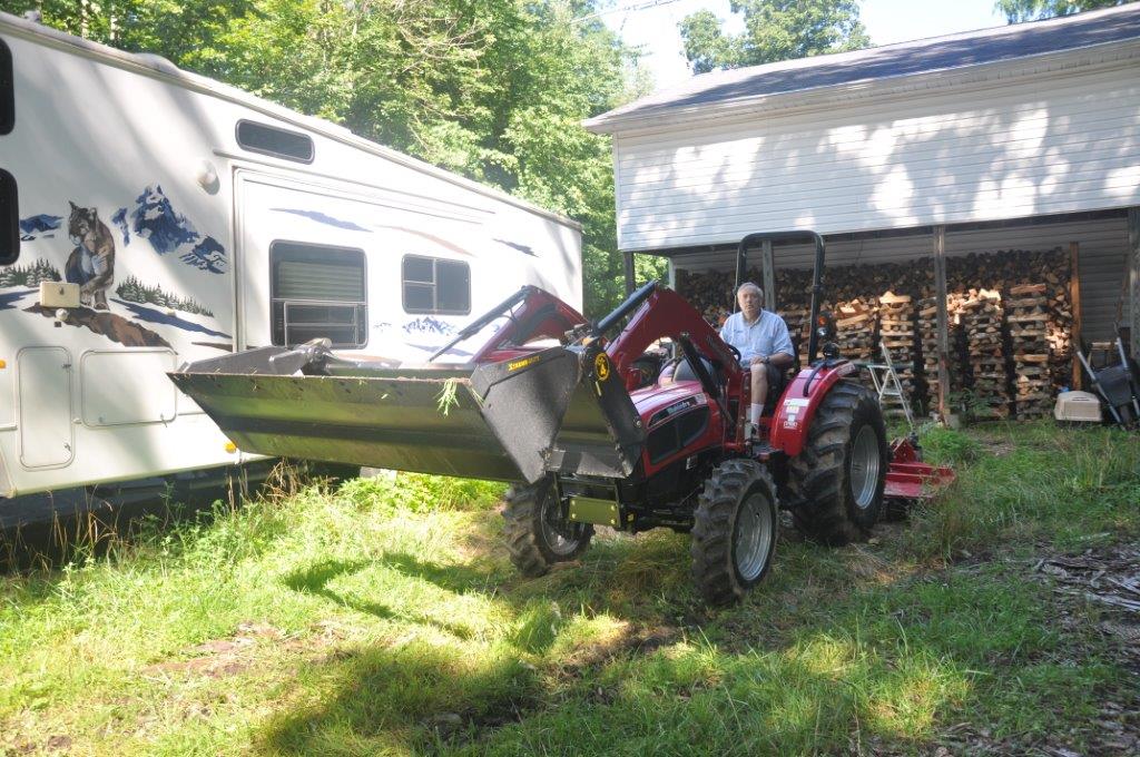

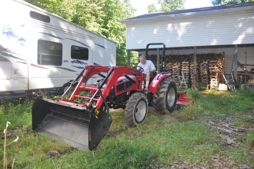

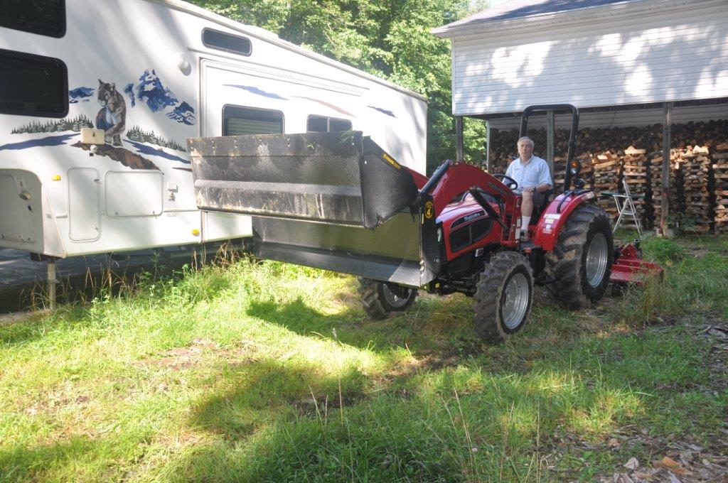

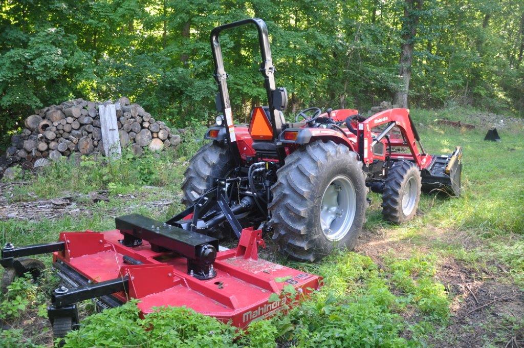

You asked for pix, so here are some. I just got it yesterday. One note: at over 10,000 lb as equipped, it doesn't climb even gentle slopes in high range!
   / Took the plunge 5035 HST #23
How's it do with that 8' cutter?
   / Took the plunge 5035 HST #24
I am still breaking the engine in, so I have not run the cutter yet. I am sure it will do fine, though, as I have run a 4' Woods Brushbull on a 16 Hp Kubota for many years.

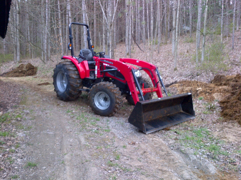

View attachment 433930View attachment 433929View attachment 433931View attachment 433932View attachment 433933View attachment 433934
I feel for you.
My 8,300 pound L39 (37.2 HP net, 39 HP gross) GST can get up to about 5-6 MPH in 10th on a moderate grade. 12th it will not climb a gentle grade either, but on flat ground will go over 15 MPH.
But my little 3200 LB Max 28 Shuttle is a hot rod for a tractor.

I have started to do some bush hogging. It has no trouble powering the 8' cutter through normal grass and brush. It slows down a bit in the 3" stuff it is rated to cut, but that is why I have an HST drive. So far I am happy with the tractor. However, as some others have noted, it does not seem to lug as well as I expected. By that I do not mean to imply it does not develop rated power. I mean, the torque rise as it is forced to slow down under load seems less than in my old Kubota B7100, which had a 50% torque rise from rated rpm to peak torque rpm. I have not been able to find any actual published data on this for the Mahindra engine.

Can anyone suggest a good way to carry a chain saw with this tractor? I don't like putting my stuff in the FEL, as it can fall out, and I often need to use the FEL to move fallen trees off the trail. Is there a commercial product that will clamp on to the ROPS? I won't be using a ballast box, as I will be dragging logs from the rear.
   / Took the plunge 5035 HST #30
Now I have some more questions. While working in the woods, mowing down some saplings, I managed to break off the hood latch knob, which is not well protected. I will need a new knob and cable, and have had my son weld a bracket below where the knob will go for additional protection. But the cable will still be vulnerable, as will the hydraulic hoses running from the rear remote to the 4-way bucket. Is there a better way to route these? Also, the wiring for the rear lights goes up inside (under) the fender wells, which makes the wiring vulnerable to anything the tires kick up. Any way to protect the wires?
