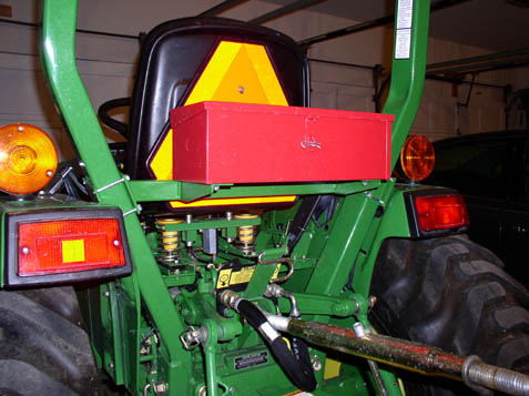

Here are a couple of photos of how I mounted a tool box on my John Deere 790. I know that it blocks the SMV sign, but I do not drive on the roads.
The mount is made from some 1.5" square tubing, 1/4" plate, and a couple short pieces of 1.5" angle. The only tricky part was cutting the compound angles on the ends of the 1.5" tubing. I did it by first making the 1/4" plate brackets, and bolted them to the ROPS. Then, I measured the angles horizontally and vertically where the tubing would meet the brackets, and carefully transferred the angles to the tubing.
Hope it helps!

Does your tractor have a loader? If not, does it have a place for weights on the front, like a bumper? Can you build a bracket of some sort and mount it there?

Great looking job and it gave me an idea where to put more stuff. That box is just begging to be green:D

I couldn't see it either. It's probably the box that replaces one of the fender grab handles. The box is manufactured for the 990, if I recall. If that's the case, I checked one out at the Deere dealer. It's not a good fit for the 790.
Beau's idea is great. I kept the picture when he originally posted it a year or so ago. As far as the SMV sign, I'd find another place to mount it or get one of the magnetic ones, if you travel on the road enough to justify that.
