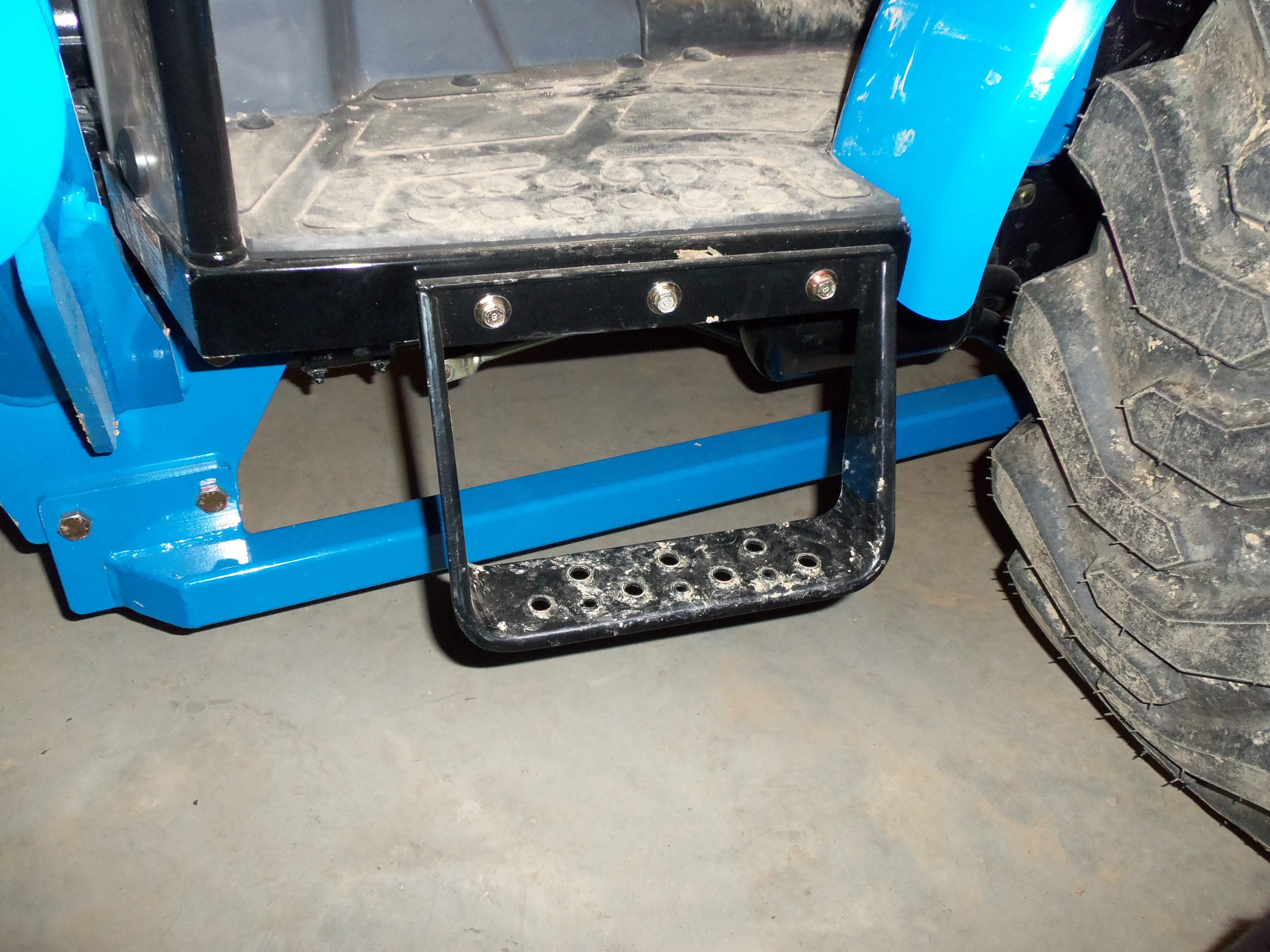

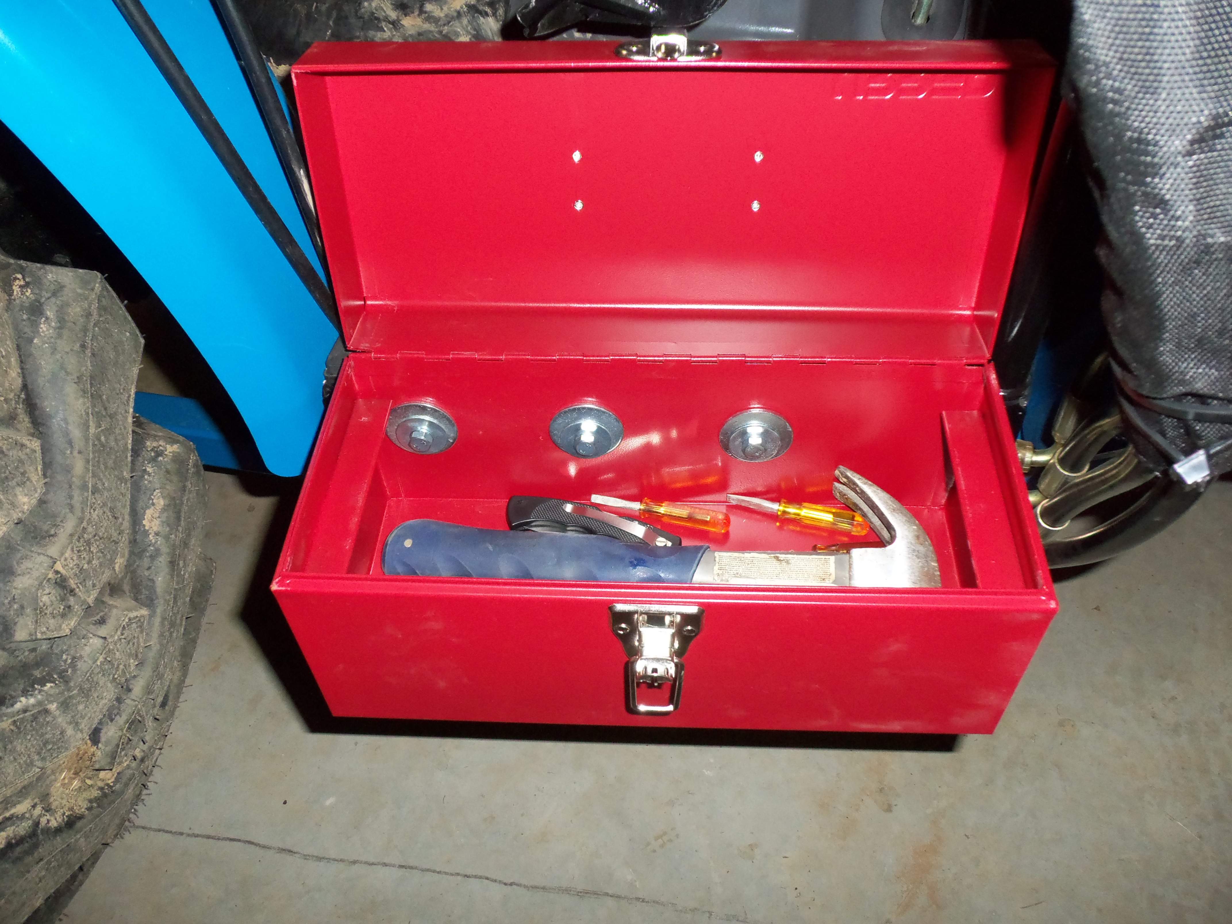

My tractor is an LS, I took off the right step which I agree is worthless. Then I drilled three holes in the tool box got some longer bolts and mounted it where the step used to be.

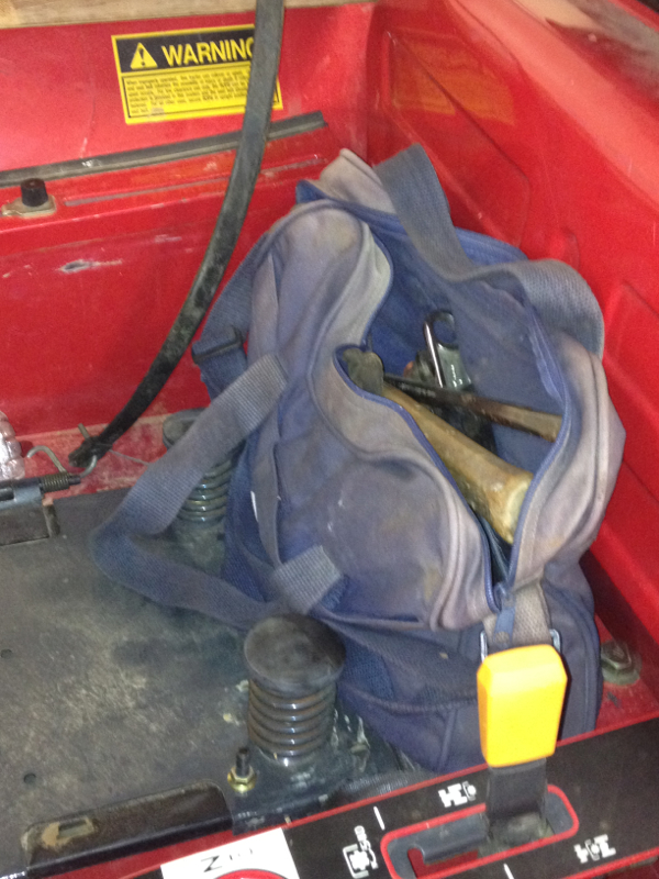

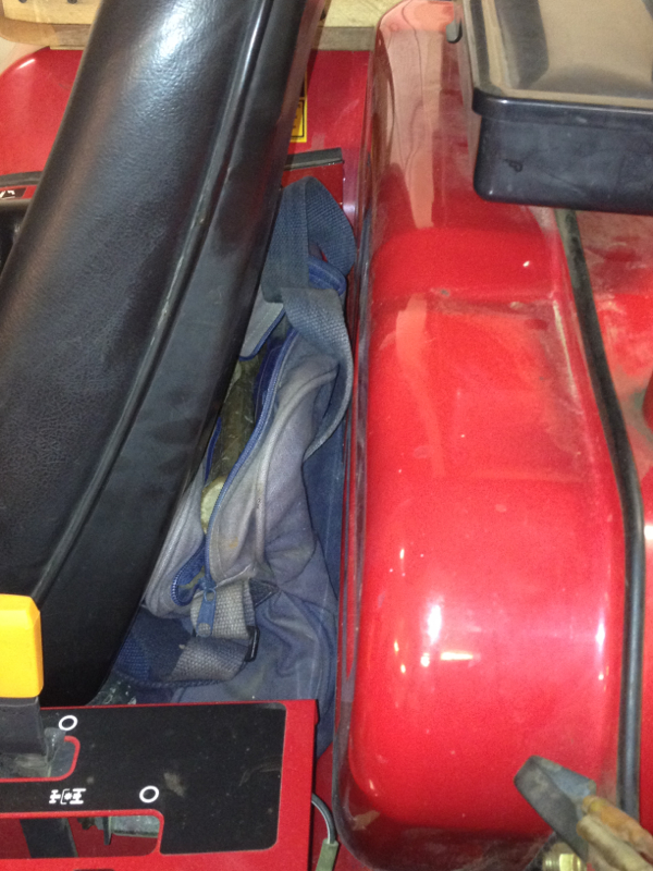

I have tool bag behind my seat which holds a hammer, adjustable wrench, gloves, couple of screw drivers, 10 or 12' chain, gloves, among other things. The seat is all the way back and it fits fine.

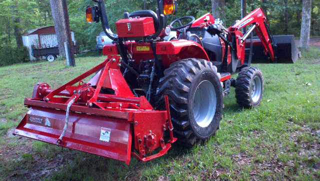

Do you have room on the rops bar? See the rops bar on my mf. It's were I mounted. Used 16" box got from TSC for $14. I didn't drill any hole in the rops bar. Used 1/8" x 1"x 5" long strips of steal, and bolts. Sandwiching a piece old inner tube wrapped around the rops bar.

Fordlightning do you have any closer pictures? Ive been wanting to mount one on my 1529 and have toyed with a few different ideas.....Thanks!

I will try tomorrow to get a closer pic. Raining today.
I took that pic with a 8mp camera. Can zoom in real far. I can zoom in to point seeing the bolts.
