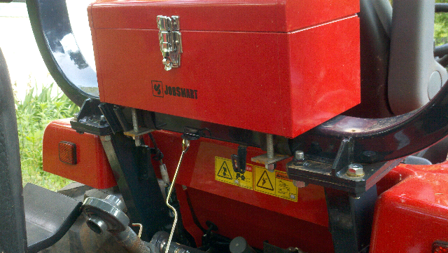

It works but I would like to have a true tool box but there are no ideal locations on the 2615.

I will try tomorrow to get a closer pic. Raining today.
I took that pic with a 8mp camera. Can zoom in real far. I can zoom in to point seeing the bolts.
thanks !!

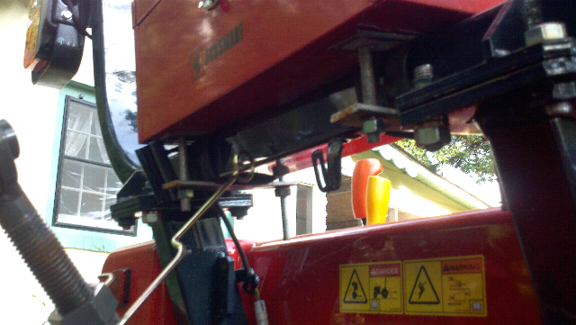

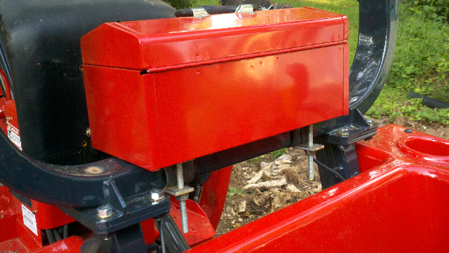

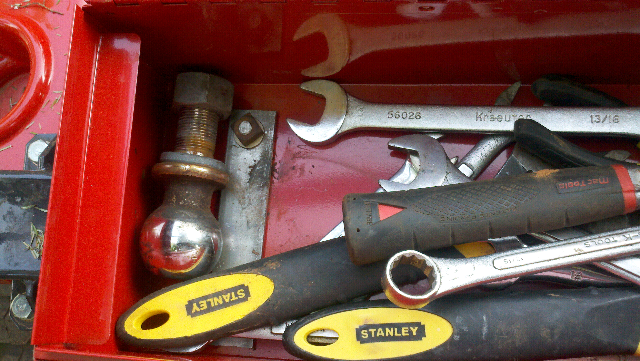

Here is few pics. Should be able to see the threaded rod and flat pieces of steel.
Underside.
Inside look.

looks like a simple but very sturdy set-up, thanks for the pictures..!!I see you put strips of steel on the inside of the box, do you have strips directly underneath as well(sandwiching the box)?
Yes. Total 3 strips per side.
