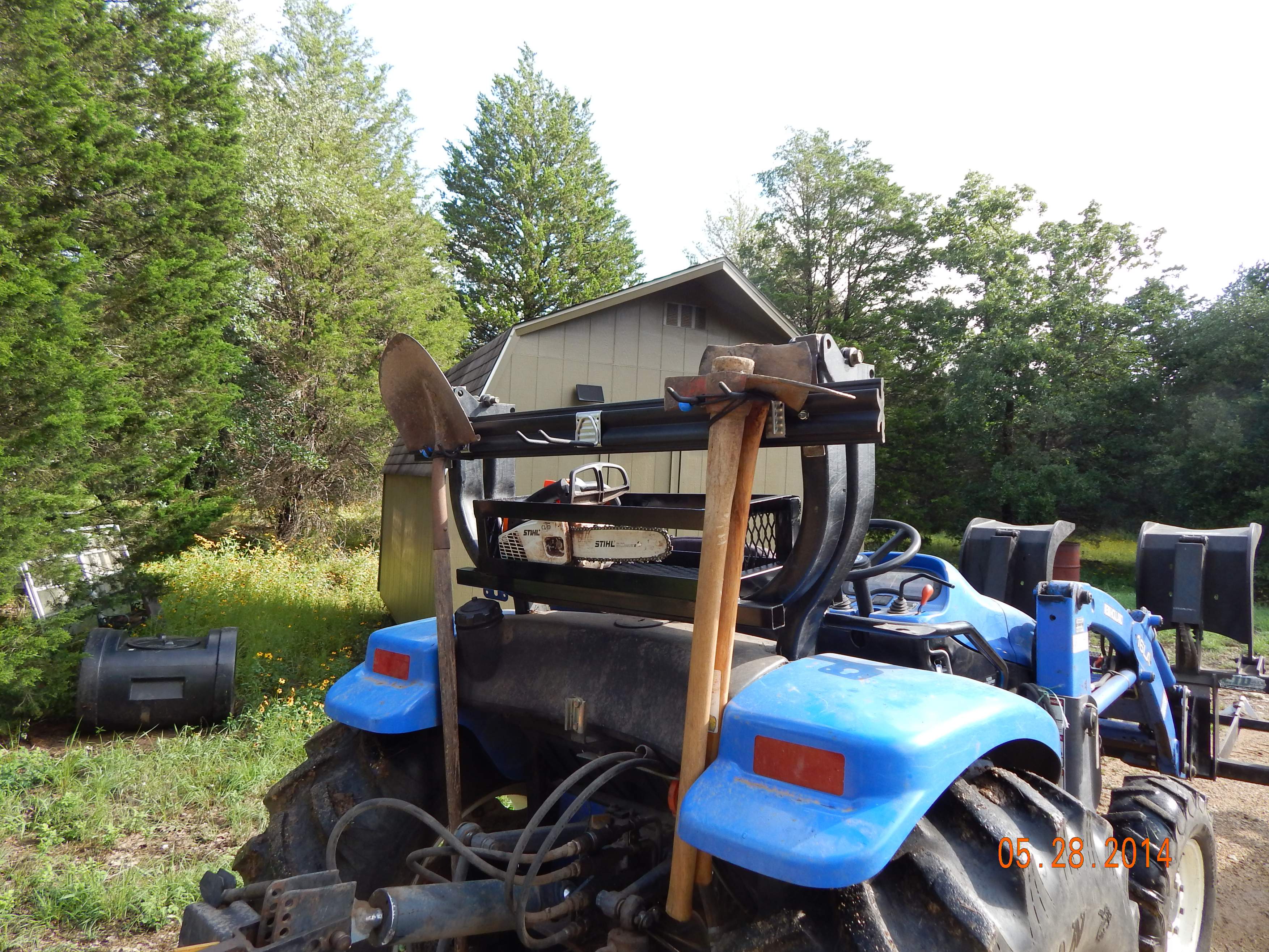

We all talk about being able to carry tools / chainsaws on board the tractor and there are a lot of solutions out there that guys have come up with. Here's mine. Yes the ROPS is folded...My tractor and I live / work in the trees and it's safer to have the ROPS down then up as it grabs limbs and brings the front up in-a-hurry. The basket and tool rack both just slip on - no bolts - so it's an easy on - easy off. The bungee cords aren't necessary, just insurance. Please ignore my lousy welding. I just bought a cheapo wire flux welder from Northern and the price ($140) and my skills (lack thereof) are a good match. This tool basket is my first attempt ever at metal glueing. If it holds together at all I'll call it success. The hanging tool rack I bought at Lowes - but everybody sells a version. DSCN0234.jpg

Looks good from what I can see. Welding is an art that takes lots of practice. The key for us novices is to use enough power to make sure you get good penetration without turning the piece into molten slag. It's what's worked for me anyways.
By the way, what is on the three point? Is that a wood splitter?
   / tool carrier #3
Nice handy rack. The best way to learn to weld is to make stuff like you are doing. Keep it up.
