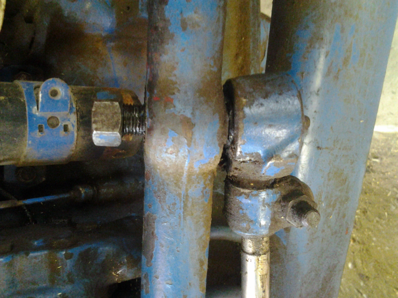

I really need to have the ps cylinders rebuilt on my naa. I'm having a hard time working out the right tool to accomplish this. The ball joint "pickle fork" isn't gonna cut it. Any thoughts/suggestions?

dunno.. looks like pickle fork work to me. worked on my 850... same setup.

If you're just going to replace the packing,you don't have to remove them at all. You can use the PS cylinder's own hydraulic pressure to push the seals out and then slide on the new seals. You have to screw out the chrome shaft from the balljoint, but leave the balljoint bolted to the tie rod. Remove the snap ring on the packing and just loosen the clamp on the balljoint and screw the shaft out. Then turn your steering wheel EASILY and the pressure will push the seals right off.

Where the end goes through the arm smack the large boss with a hammer a few times

If you want to remove the ball joint from the tie rod,I have soaked it with PB blaster,run the nut out flush with the end of the stud(turn nut around on stud if it's castellated with flat side towards hammer), put a piece of steel with some weight to it on the other side of the tie rod and took a ball peen hammer and taped on the nut. Let the PB blaster stay on it for an hour or two before you take a hammer to it. The reason I say tap is you don't have enough room to do much else LOL. It has worked for me in the past. The reason I do this instead of using a fork is if you have a good rubber dust boot on the ball,the fork destroys them.

I have used this approach successfully, only using the pickle fork to put the tie rod end under stretch (to preserve the boot), while whacking the tie rod end boss with a hand sledge sharply. The sledge impact slightly deforms the boss and releases the tie rod end taper.
