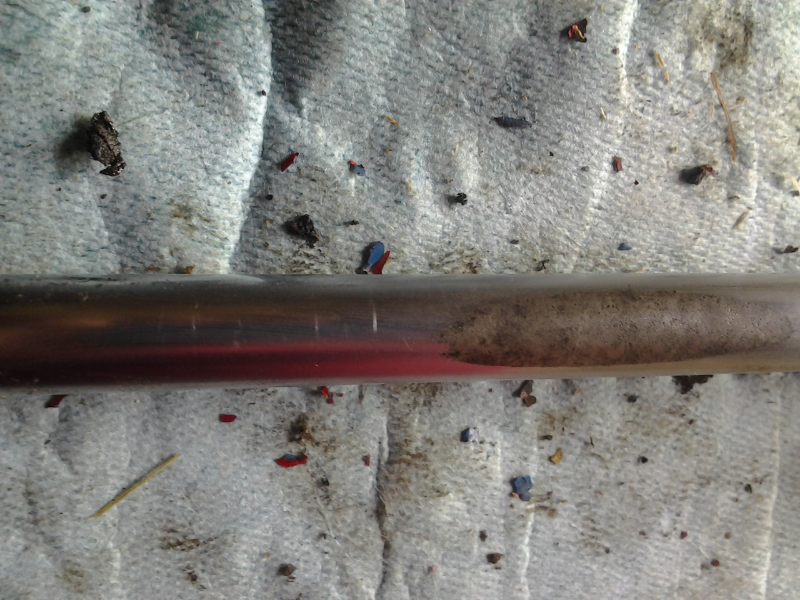

This is an interesting idea. I was wondering if this is the way to go. I'm pretty sure that I need to pull the entire cylinder because the rod has a 3 inch spot of corrosion on it....the chrome is gone. I'm pretty sure that this rough spot is what is causing the seal to fail. When i got the machine going it dribbled, now it leaks all the fluid as quick as the pump can move it.

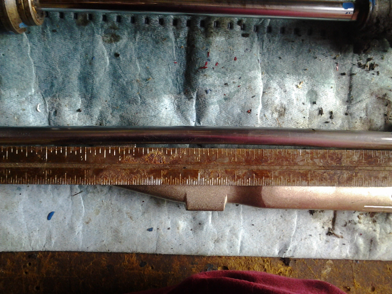

Well thanks for all the good advice. I bought a new picklefork and became less of a chicken about swinging the hammer. Both came off relatively straightforwardly. The left one i'll probably be able to just get away with seals. The right cylinder is much worse. Picts show the rough spot on the shaft...but worse how badly it is bent. (Straightedge for reference) I've a feeling this is gonna get expensive.
the simple worn part on the rod isn't much of an issue if it is polished smooth.. for a old tractor ps system.. however the bend ruins the rod.. and the one with a wear mark, check for a bend on that one too..

Dropped it off with "my" hydraulics guy today. The wear mark is likely caused by the bent rod...he is going to explore some options...maybe a new rod maybe a whole cylinder. The other cylinder is in great shape comparatively.....so if anyone has a source where i might find a replacement please let me know.
