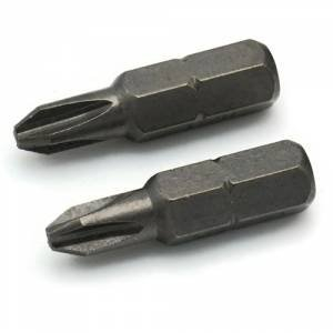

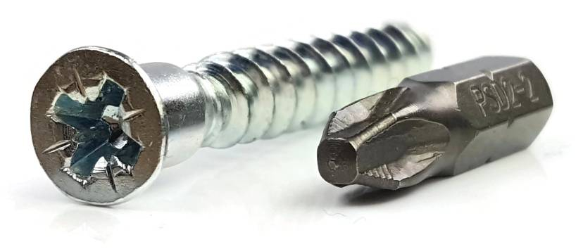

I had a 1968 Suzuki (X6 Scrambler) and a 1971 Kawasaki 500 that used "Phillips" screws on the side casings. Soft metal too. Hated Phillips screws ever since. Finally started using a hammer driven impact driver on them. Maybe I just had the wrong screwdriver? (the rinky-dink screwdriver in their toolkit wasn't good for much)
Hah, reminds me of dirt bike days in the 70's... we replaced all the "Phillips" head screws (yes, using the hammer driven impact driver) and replaced with socket heads. We didn't realize it was a different style of head, just that the buggers rounded out way too easily. 😂
