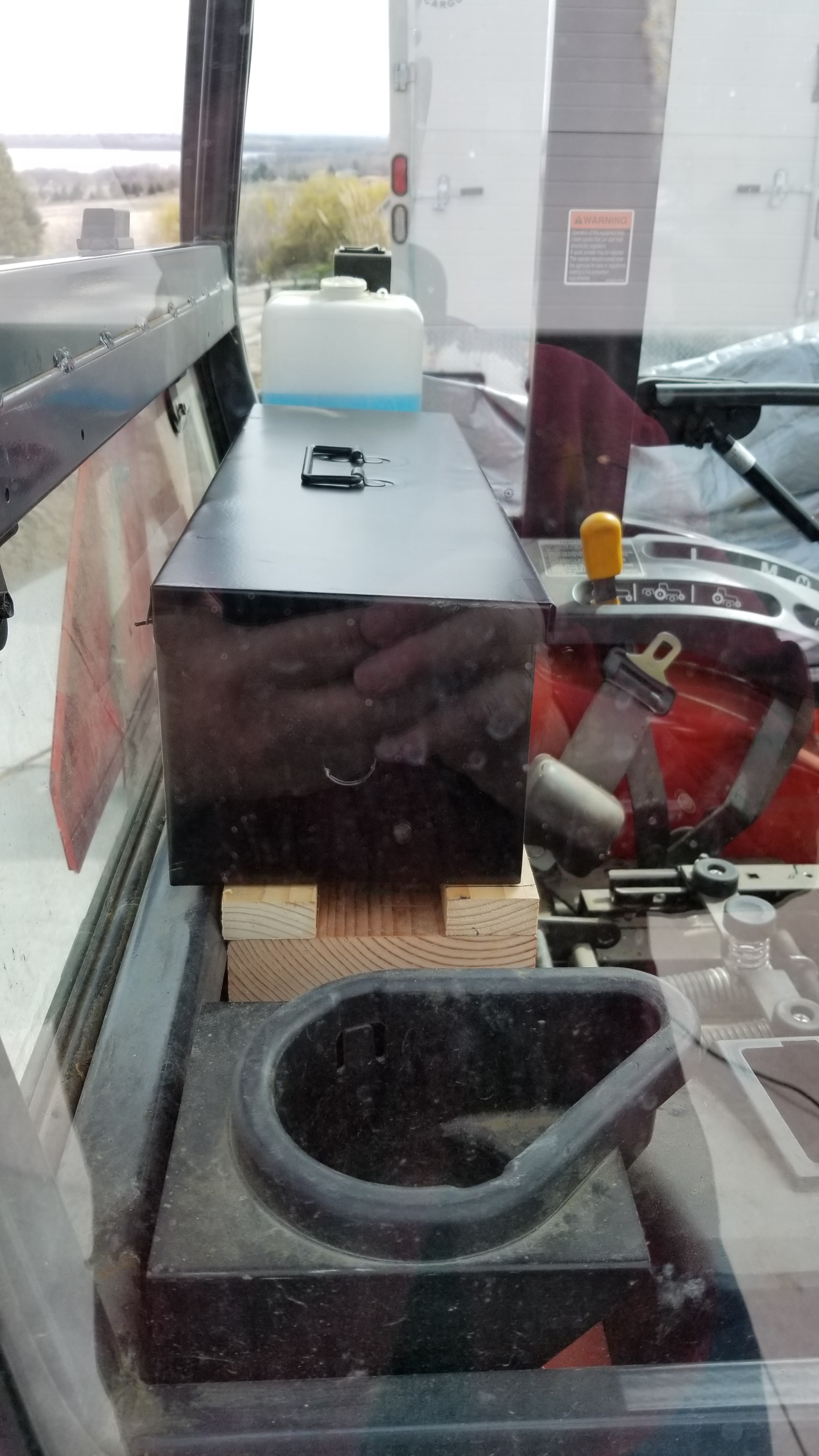

I have a cabbed tractor with no convenient place to install a tool box. Finally decided to place one behind the seat on the 3 inch wide base of the cab mount.
Since it was so narrow I looked for a longer size tool box and found one that is 20" long, 5" wide and 6.75" high. Bolted a piece of 2x6 and and 1/2" boards to raise the mounting surface so I could slide the tool box back toward the lower window of the cab so as to allow space between the seat back and still allow the lid to open up and stay open. I can access the tool box by tilting the seat forward or through the open back window. Now I have a place to carry tools and extra pins, bolts etc.

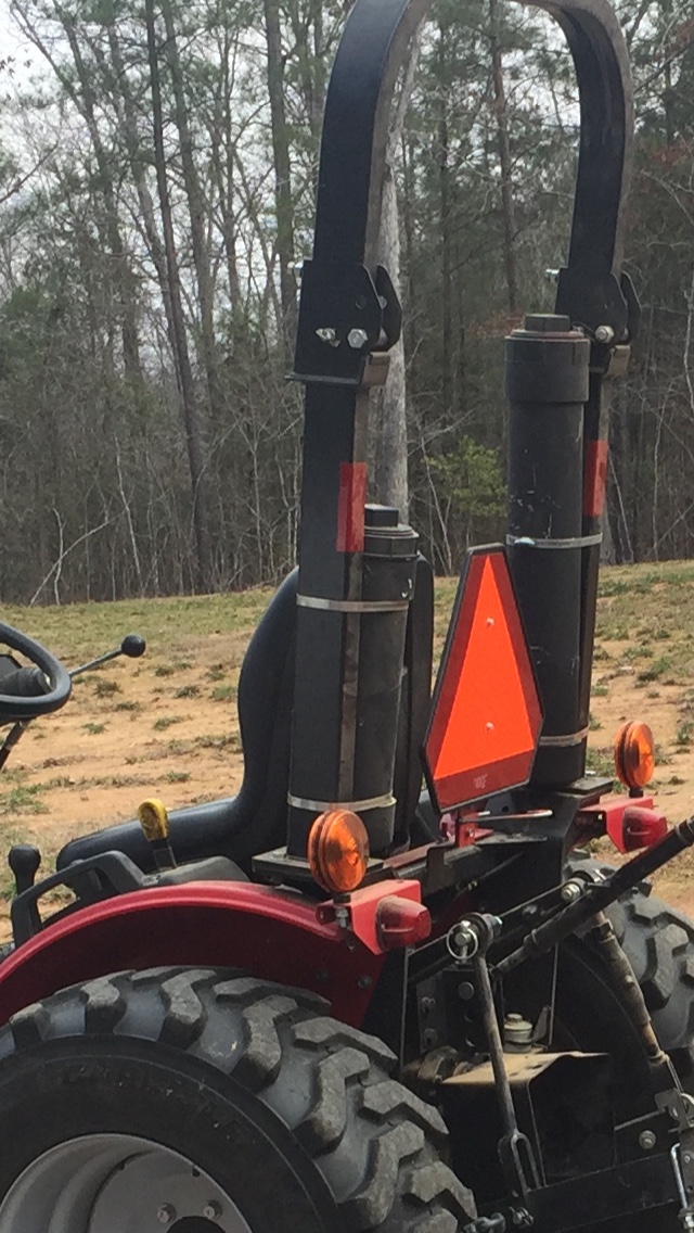

I used 4” PVC attached to the ROPS - with screw on tops and it works for me ...IMG_3179.JPG
