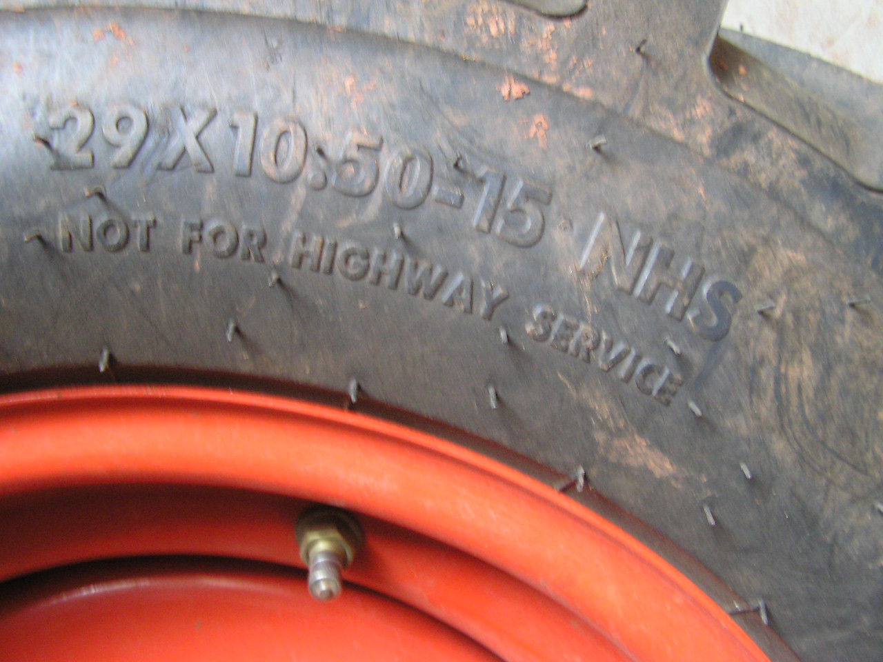

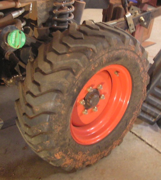

I have been reading a lot of past posts regarding light truck tires for the Toolcat. In addition, I am also taking not of rim size for those tires. More specifically, bolt pattern. It seems to me that everyone had posted that a 6x5.5 bolt pattern is what they have used.
I scored a set of Toyota Tacoma rims and when measured they are 6x5.5. However, when I tried to test fit them onto my Toolcat (series A), they would not fit. When I measured my rims, the bolt pattern is 6x6!
Did Bobcat change the wheel hubs for later models to the 6x5.5 pattern or am I missing something regarding installing that pattern on my Toolcat? I have subsequently looked for the 6x6 pattern rims and they are very hard to find. Seems most are used on farm implements and have severe offsets making them practically useless for the Toolcat.

I put the calipers on our series F, they are 6x5.5 with a 4-3/16 center hole.

My 2009 Series D (purchased in 2008) has the same tires and rims as Xfaxman. 6X5.5"

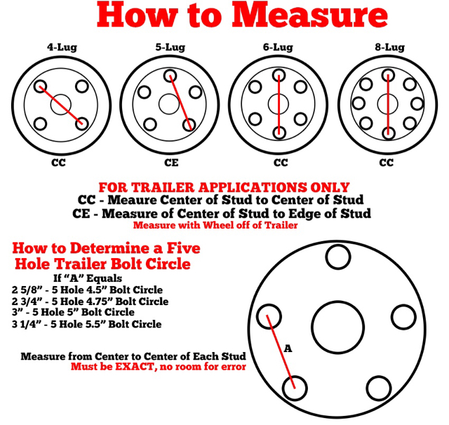

My 2013 F series is just like the rest. How are you measuring?
