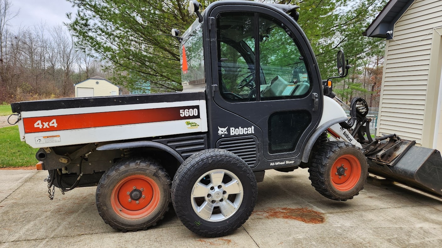

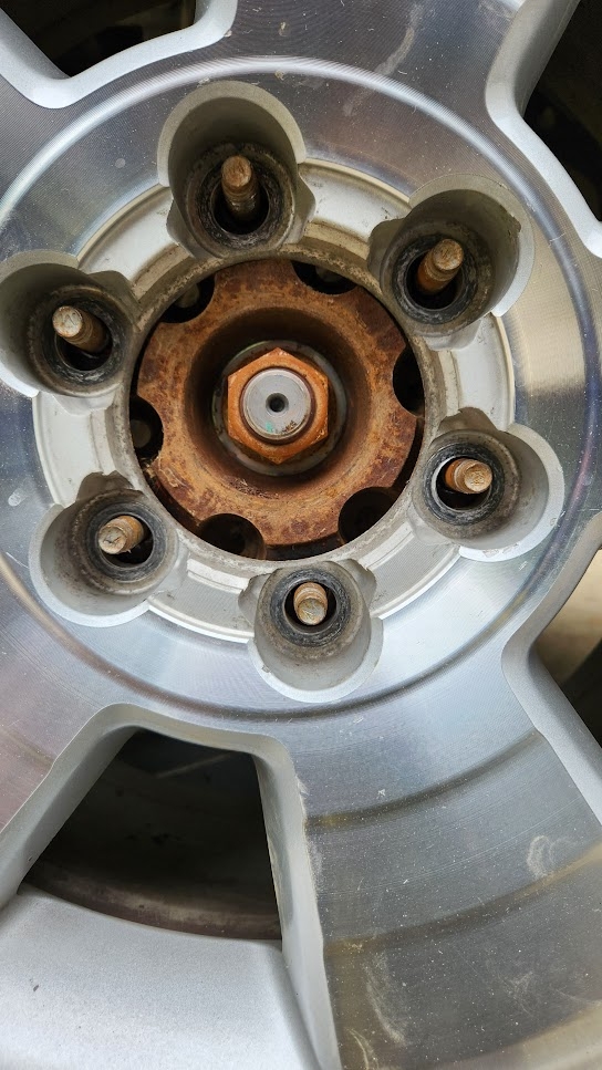

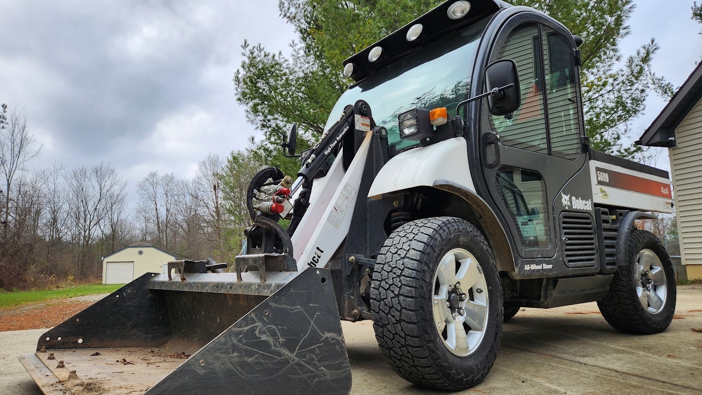

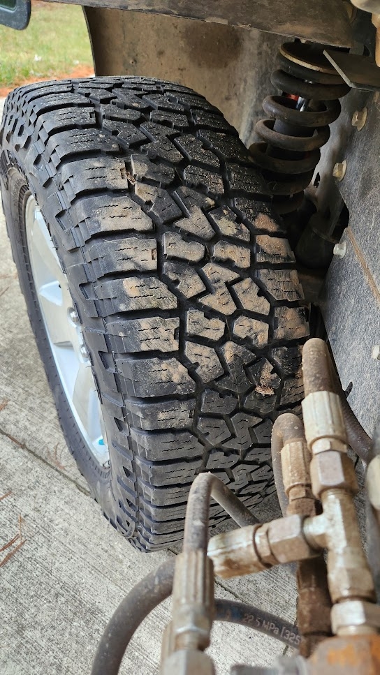

Were you able to find the type of 6 lug, 6" on center rims you needed to mount load E truck tires?
   / Toolcat Rims and Bolt Pattern
#14

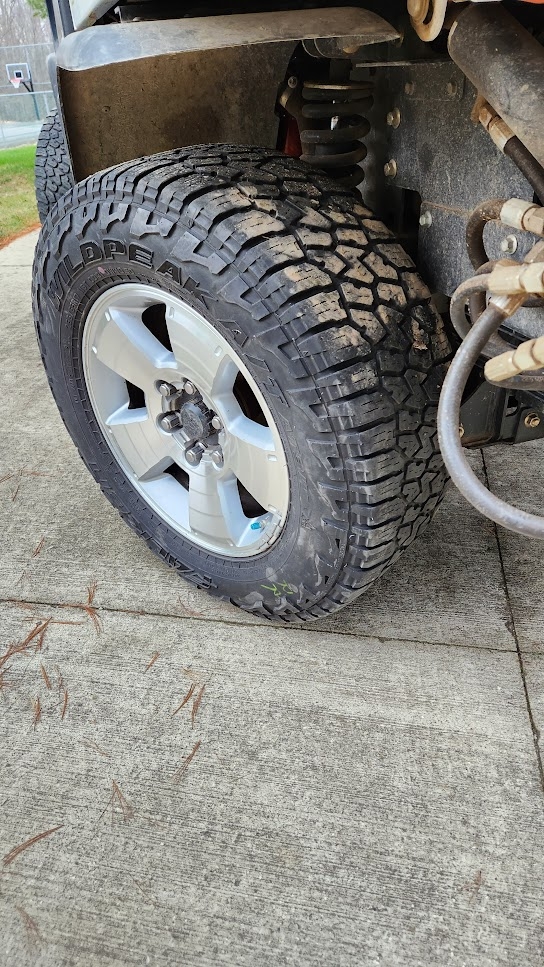

Yes - through the link you provided above plus a fee other sites. However, I have not been able to find any without huge offsets. Maybe I will start to check some farm equipment auctions and see if I can locate any rims.
   / Toolcat Rims and Bolt Pattern #15

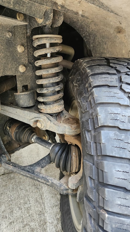

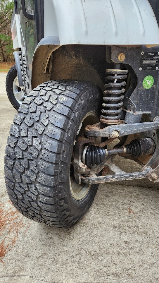

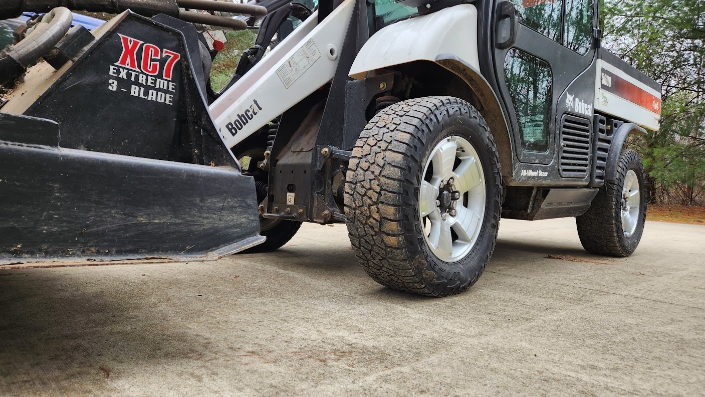

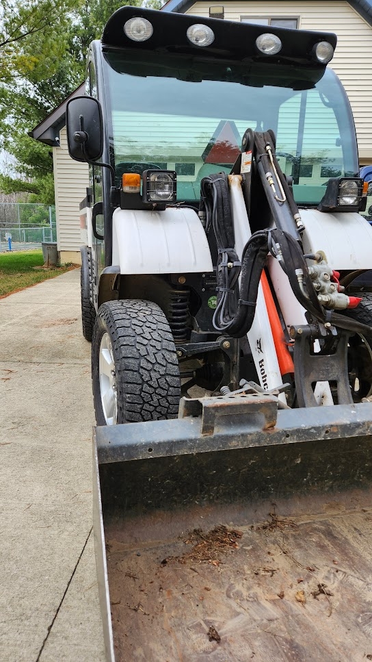

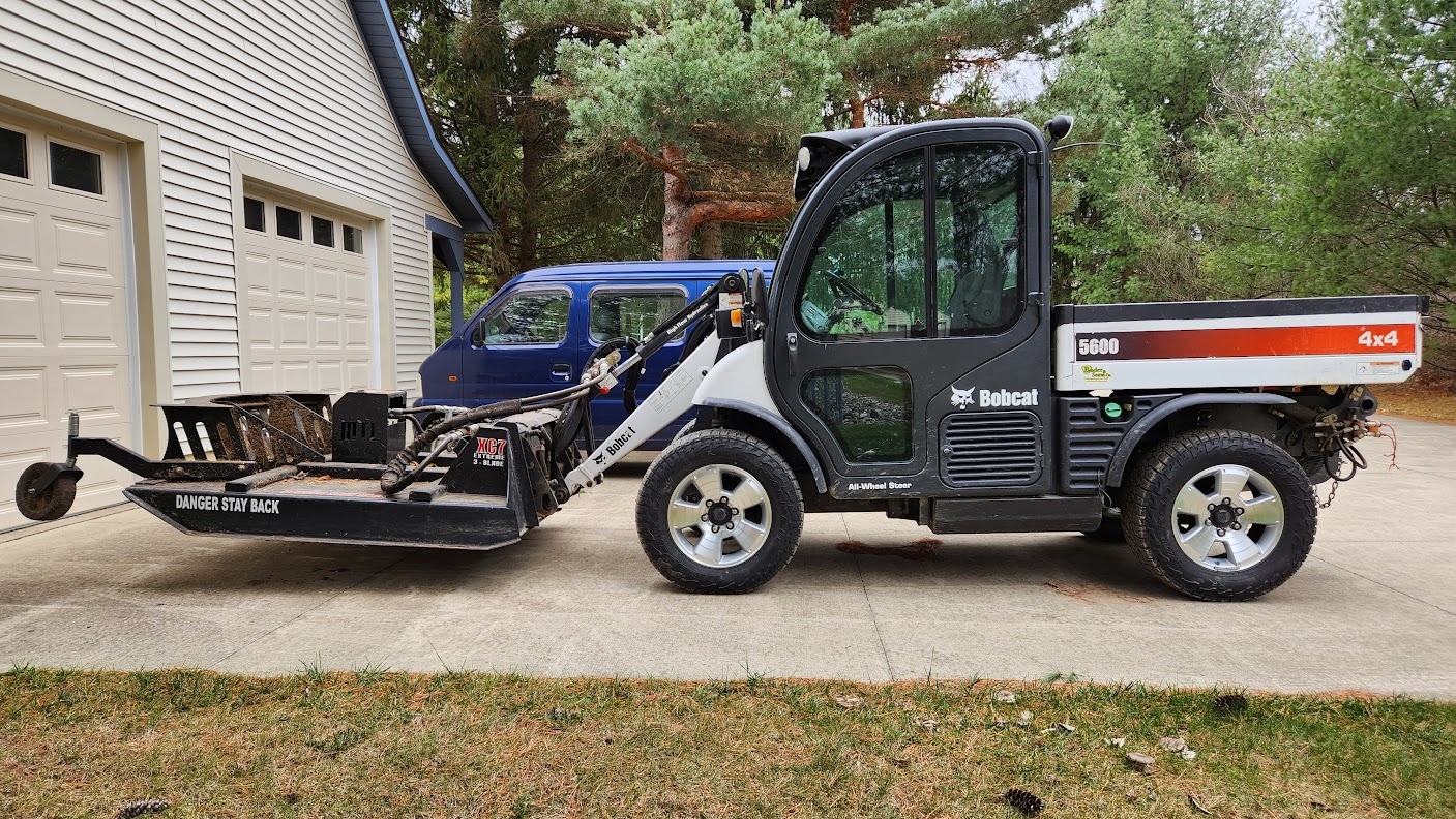

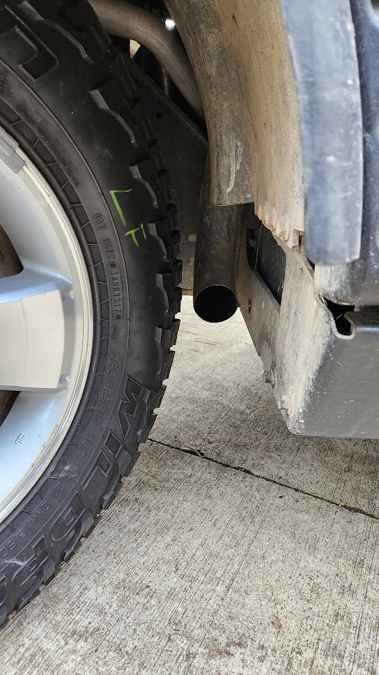

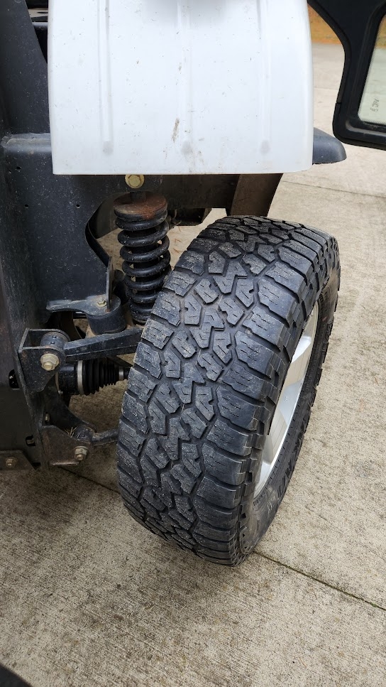

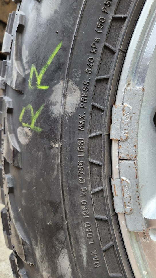

I finally did the switch to truck tires, Toyota Tacoma 265/65r17 on 17x7.5 +30mm offset wheels. Fit with no rubbing (i've driven on them loaded off road since and nothing seen even with lifting tires off the ground in ditches).
Full video on the install and findings/learnings
