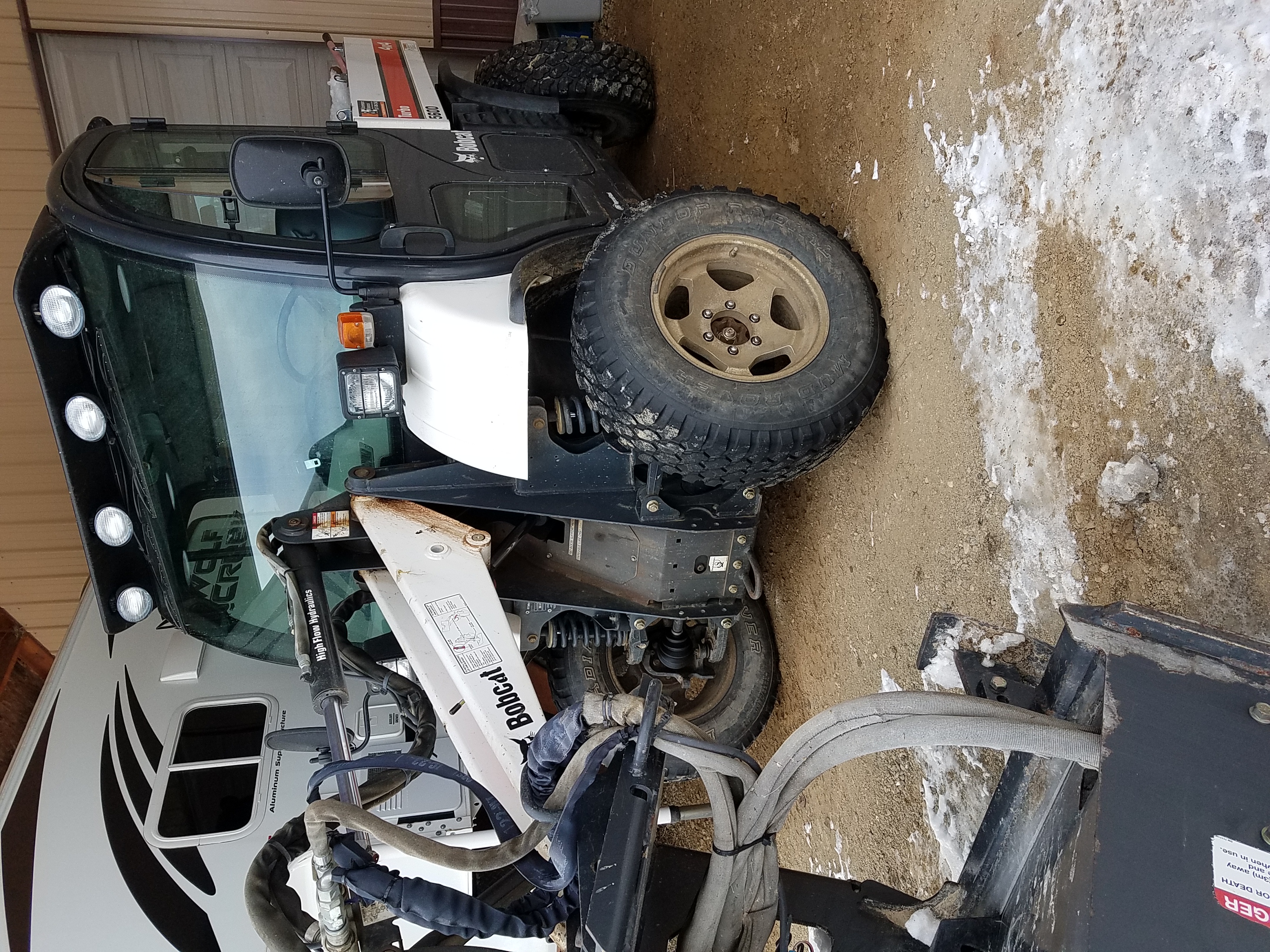

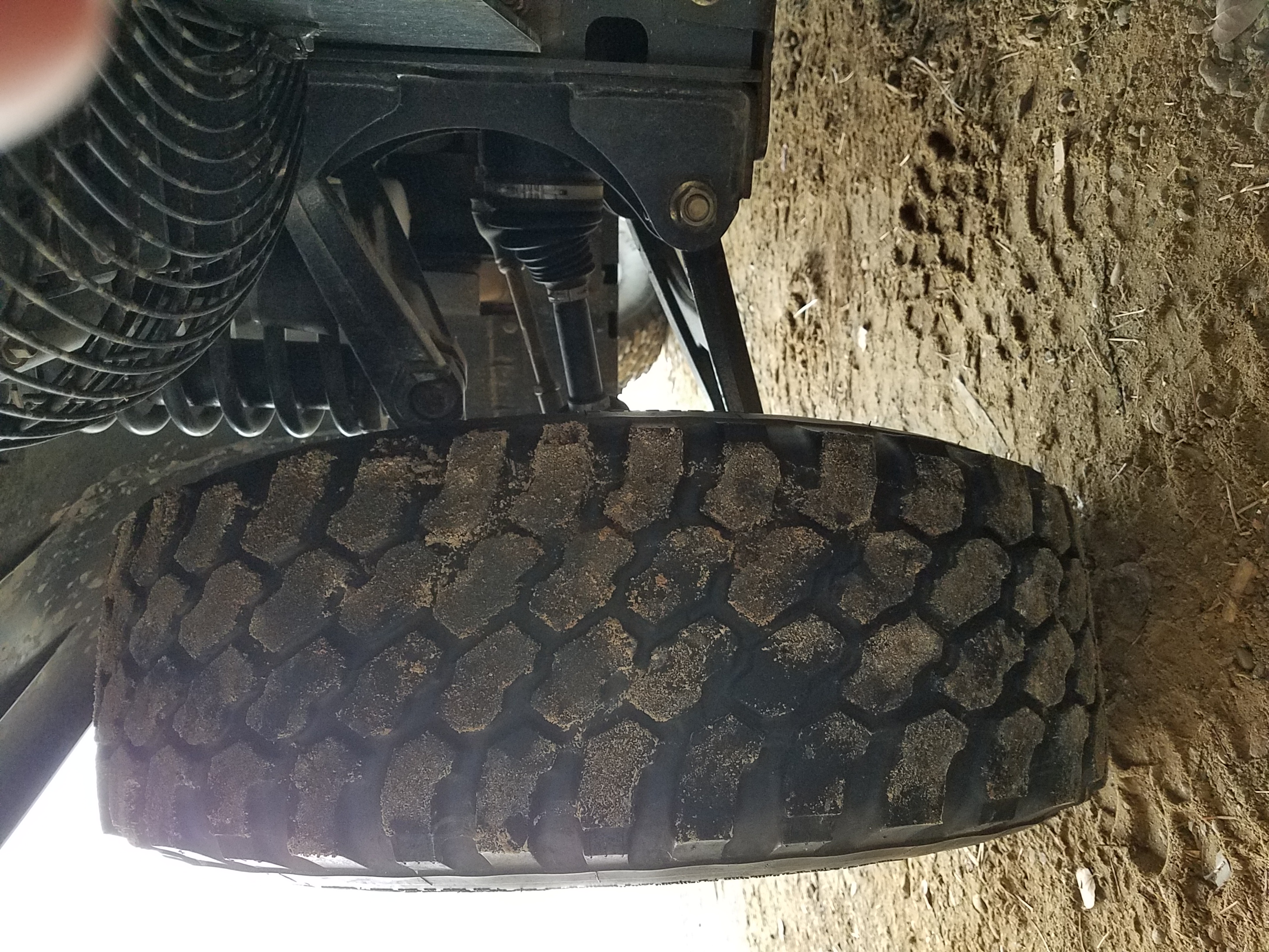

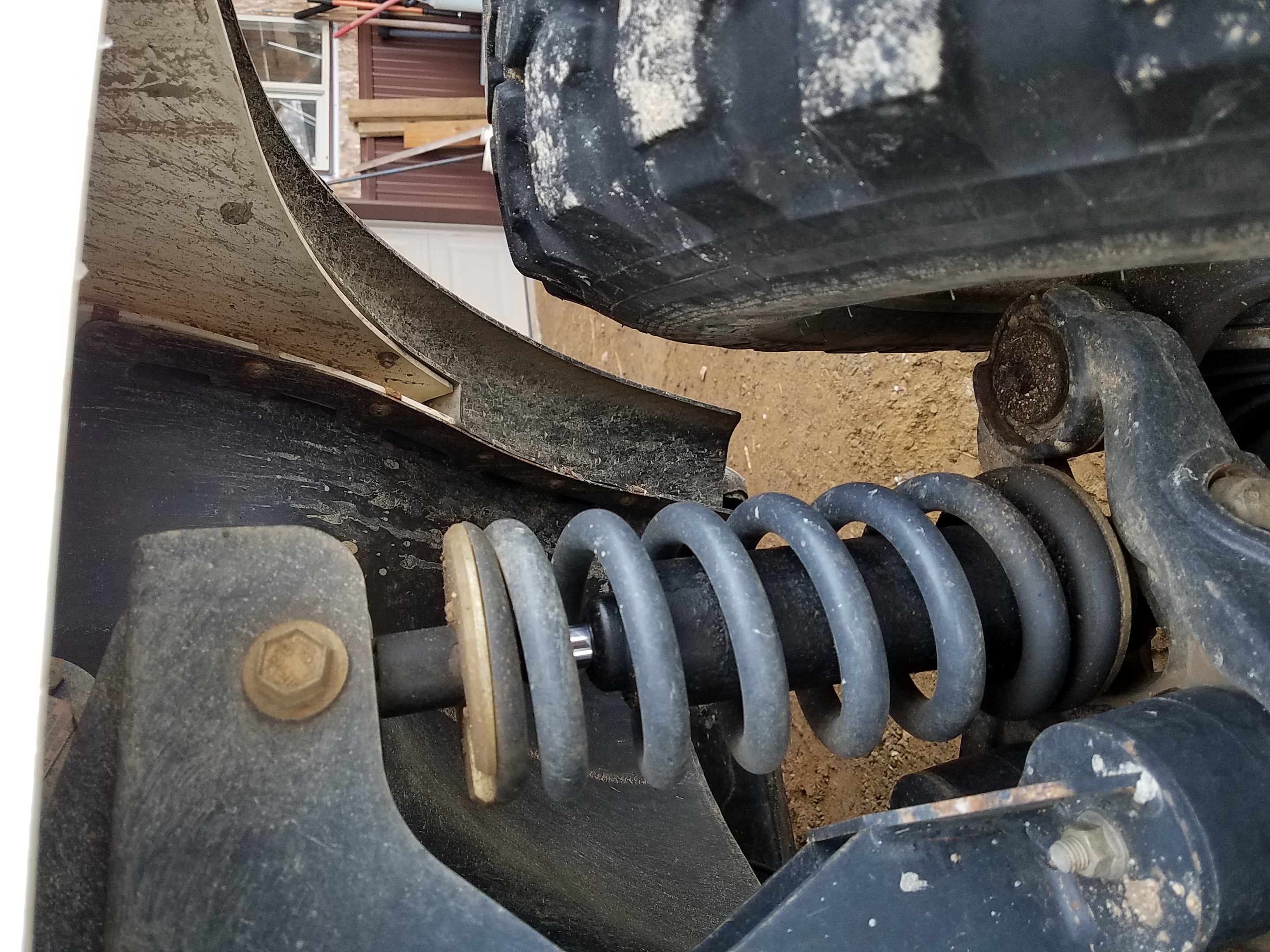

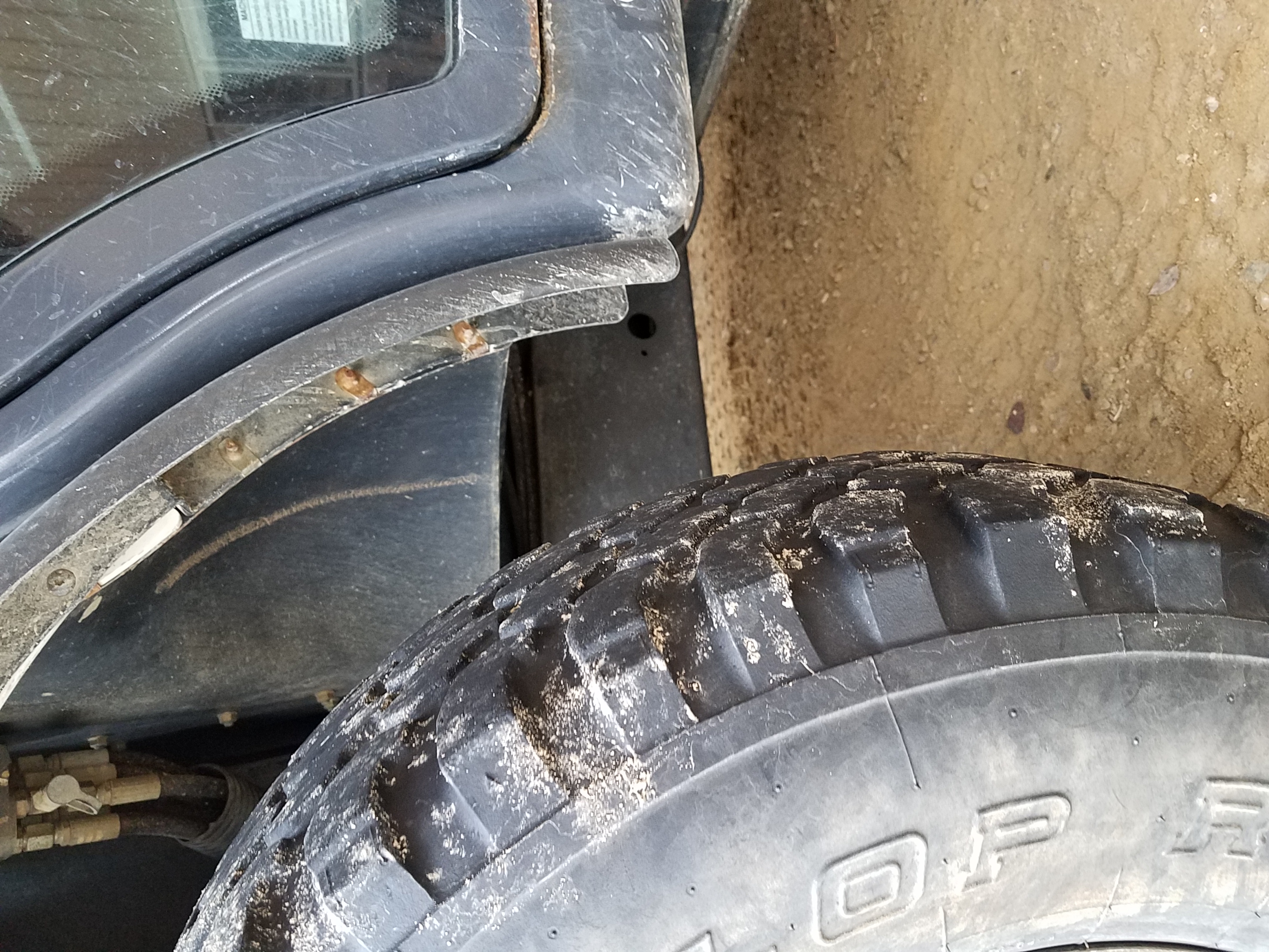

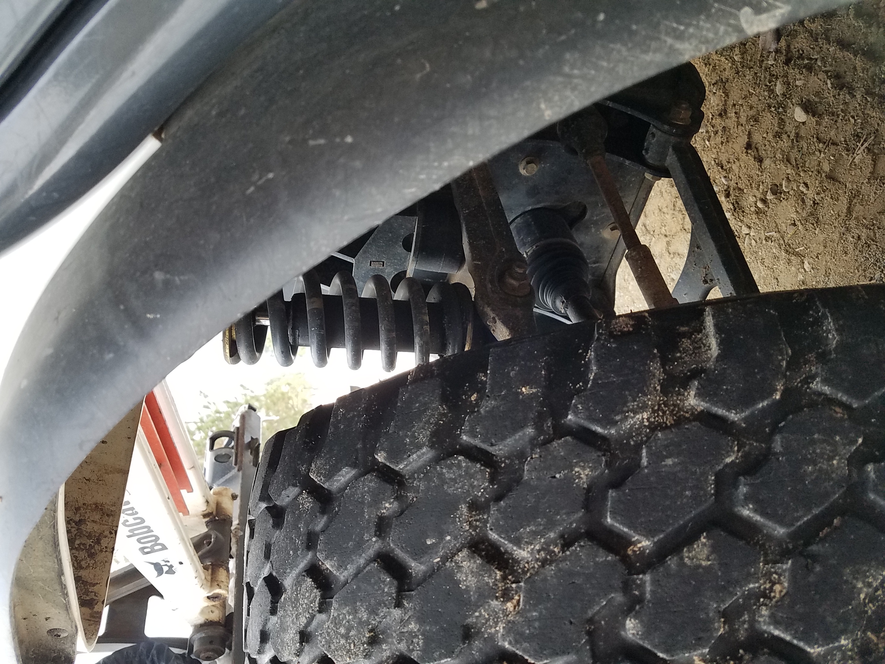

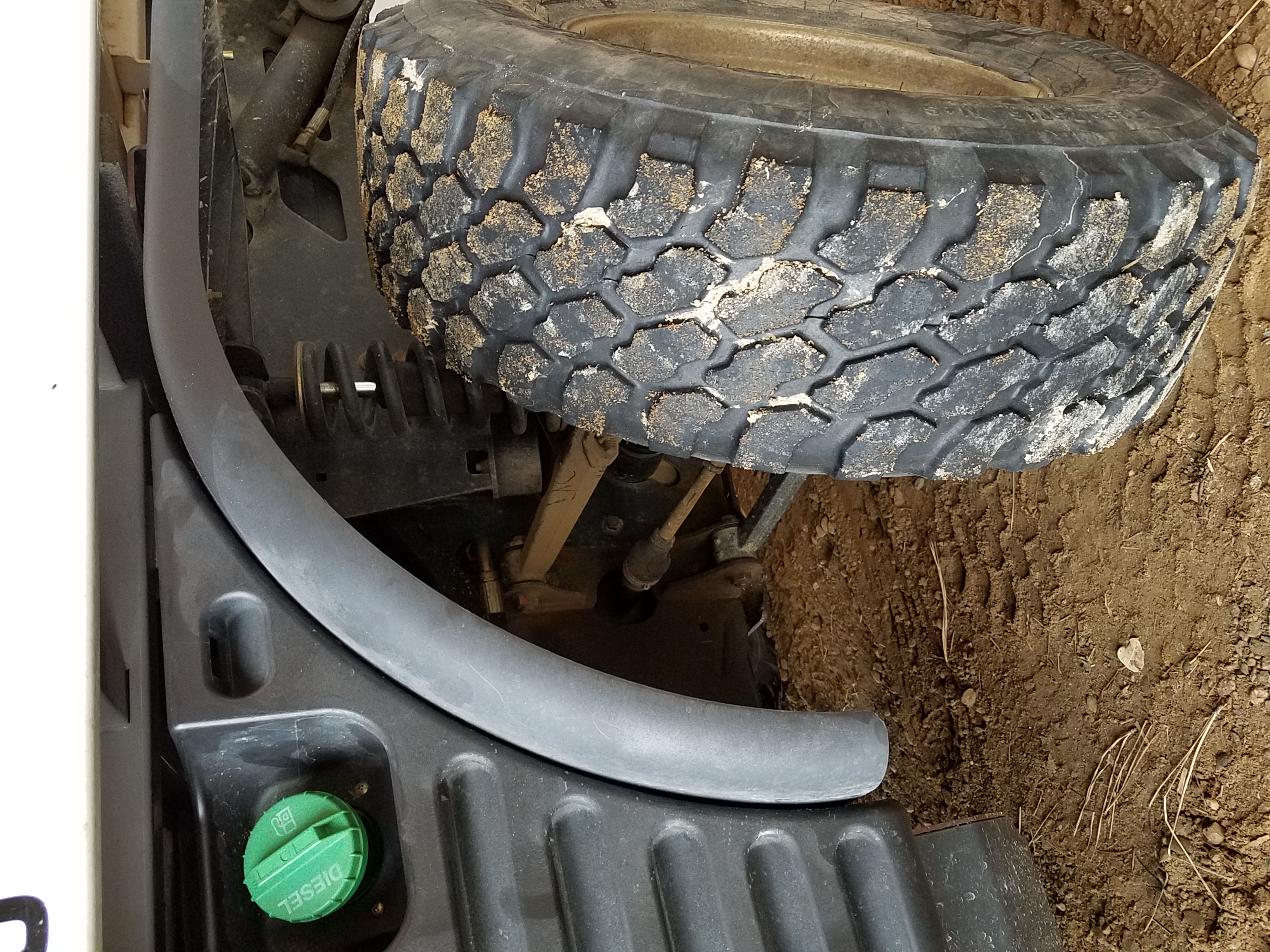

Sorry about the orientation of these pics. They looked fine on my PC but after uploading I noticed that they all need to be rotated CW by 90.
Pic 1 is the machine as-photographed. The blower (SB200-72) is lifted off the ground so as to compress the springs. The second pic is of the sidewall of tires showing 265/75-16. The rest of pics show clearances. The clearances are better than they may look. I did include a chunk of a 4x4 post in some of the pics to give some perspective. Clearance was typically 4.5" or greater. In any event, as she sits, there is good tire clearance. With one or more of the tires dropped into a hole (stuck!) that clearance may go away. Having said that, I've been stuck more than a few times and clearance hasn't been an issue. Pics 3-6 are up front while the rest are the rear. I don't recall how tall these tires are; however, Tire Rack has an nice online chart of tire sizes/heights.
