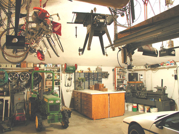

Harv, could you please post an image of your gas forge. I have scrounged up some some Kaowool insulation and some 18" light weight steel tube and was wanting to build one. Was figuring on a propane forced draft burner. I and many others would love to read your thoughts. Also I remember your posts on the wire rope fence shortening up over time. Could it be the rope rusting or dirt blowing inside between the wires and being they are twisted spreading the wires apart and shortening the length? Kinda like twisting a rope tighter. Along the lines of the hanging welder here is an image of a table saw hanging from the ceiling. A boat winch gets it up and down,
