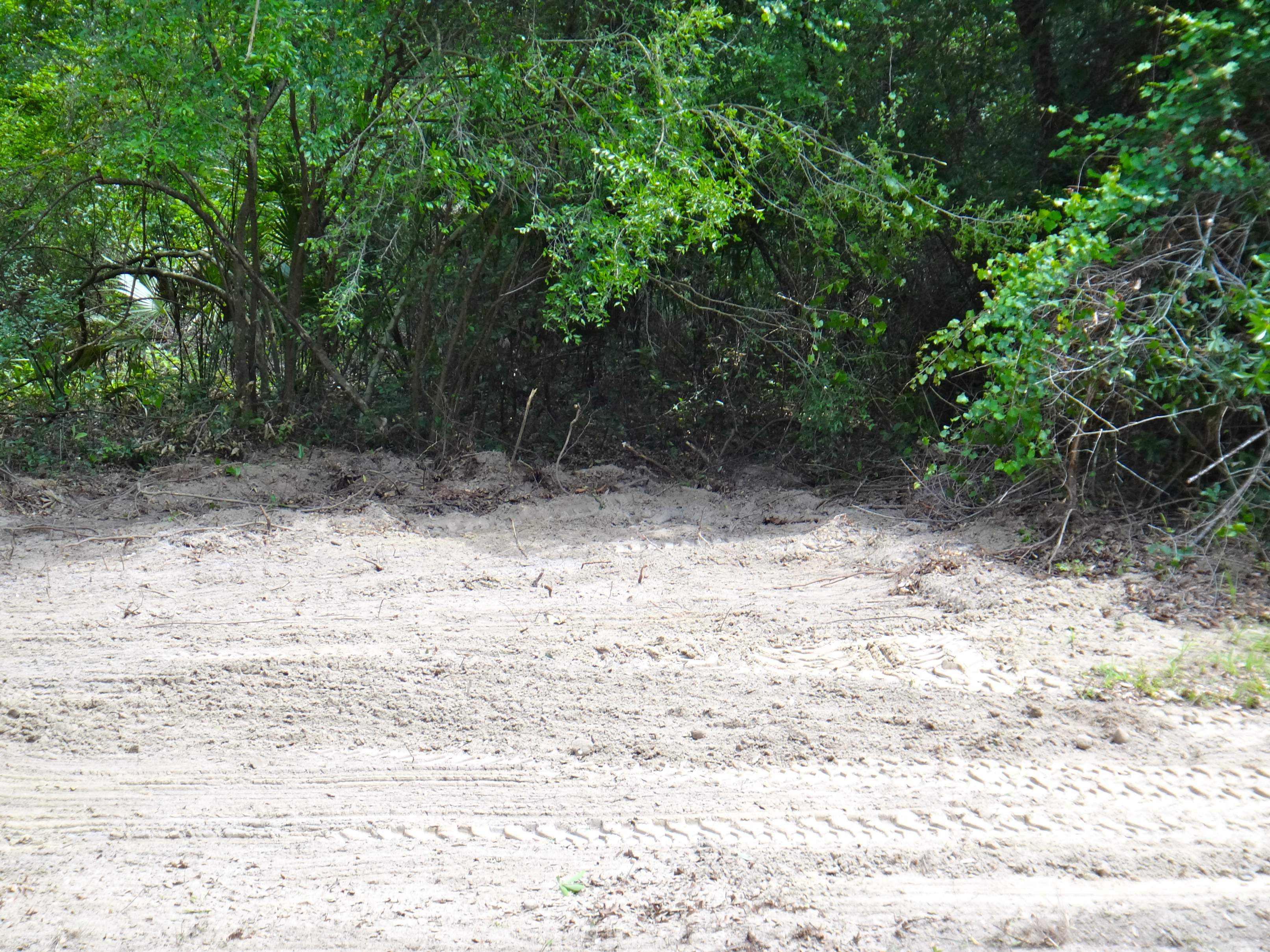

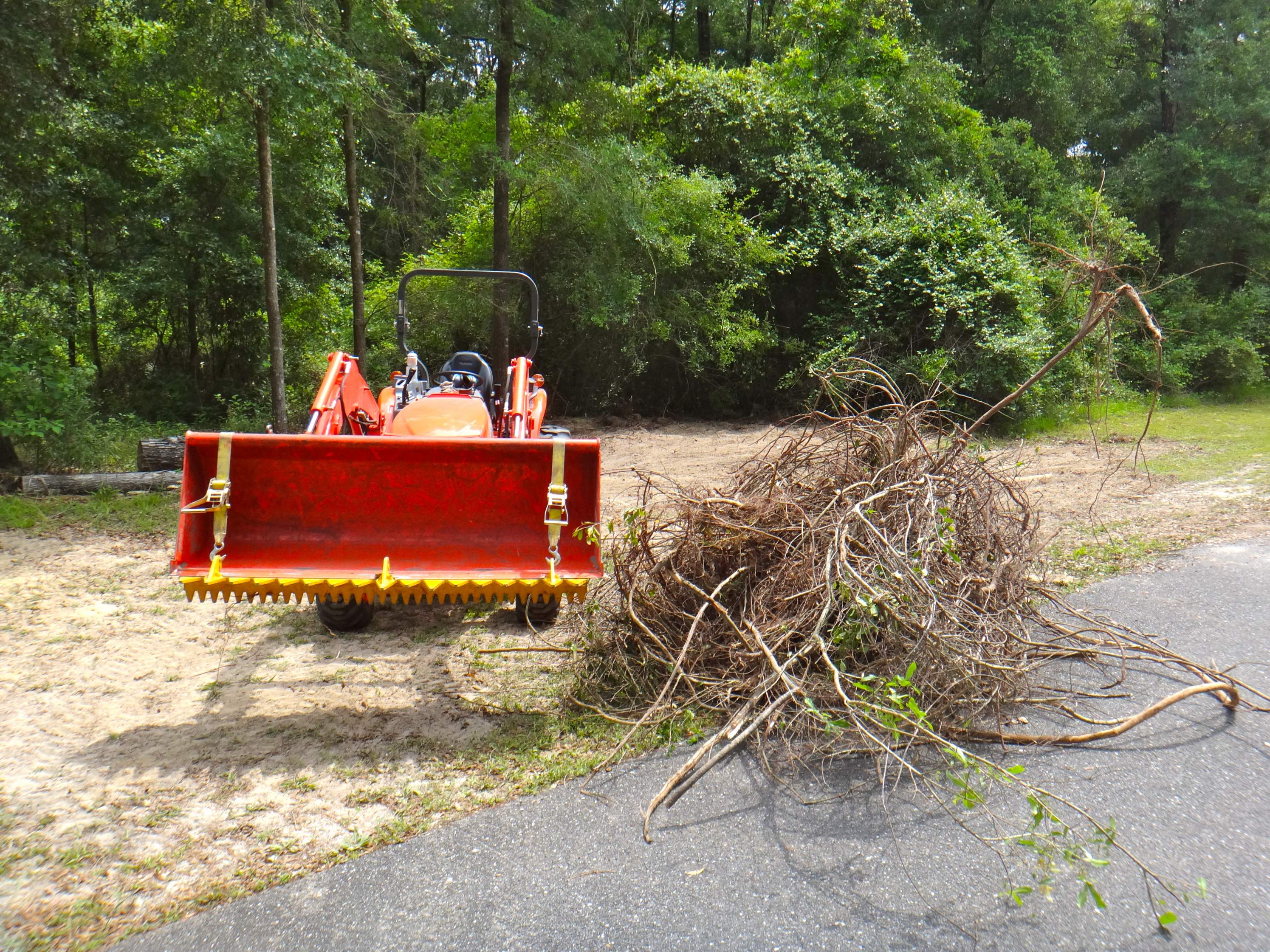

/ Tooth bar question? #8

I got the BXpandable tooth bar for my JD and it does do a better job or ripping out shrubbery than a flat edge on a loader and up to one inch saplings it usually can handle it pretty well depending on the type of tree. It does also help the loader quite a bit when scraping and you hit a hardpan of clay. For the price of the add on implement they are worth the money.

I stab a tooth under the roots to snag it, then pop it out by driving forward. With just the flat edge of a bucket, you can't slide under the trunk without digging up a really big, wide divot. An alternative is a tool that grabs the trunk (eg like a claw hammer) as you drive forward, pushing it over and then out of the ground.

The tooth bar will help a lot. The teeth can rake through the top layer of soil where the roots are and rip them and you don't get piles of dirt. You can't do that with a blade edge. If you push a tree over and then get under the root ball to free it the big teeth on a tooth bar will really help you grab on and rip it up. When you are done the teeth make a nice brush rake too.
I put a tooth bar on a year ago and can not believe the difference it makes in everything.
