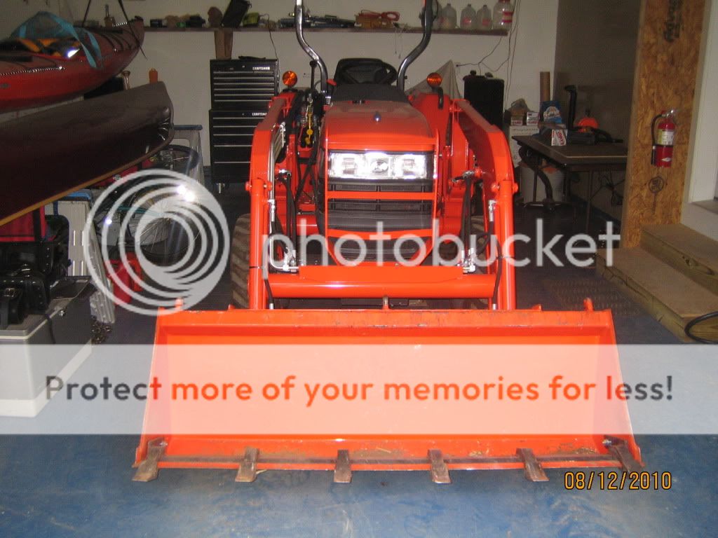

OK, really want a tooth bar now.
And am I right in seeing the tooth bar mounted on your 3 pt hitch? How is that? How did you "aim" the teeth down under the trunk?
This is exactly what I'm interested in doing myself. Wouldn't have thought I could dig up a tree that large. Huh...

In the interest of full disclosure, I must admit that the trees won. I was only able to remove one of the three I wanted out. :ashamed:
I beat up the remaining two pretty good:
There are other trees behind them, making it hard to push. And their roots are all entwined around large rocks:
I guess I could have kept going, but I did not want to beat on my tractor. It's just really tough digging up here.
That being said, I would not give up my tooth bar for anything. It is a GREAT tool for dealing with the terrain I have. And there is plenty to do apart from removing larger trees.
And it mounts to your bucket blade. Think of it as an extension of your bucket:
So the final score was : Trees 2, Tooth Bar 1
