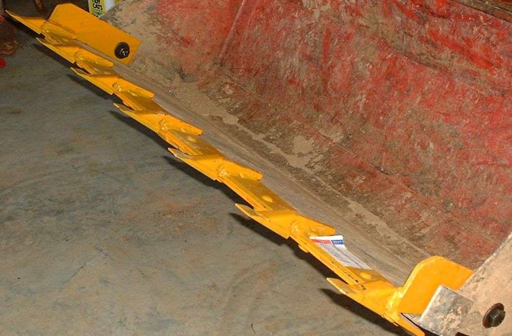

I just put a new tooth bar on my bucket, and it is great. check out www.ezattachments.com and they will have pictures. Here is a picture of mine taken just after installation. Two bolts and its off again.
Good Luck, Les

Hi Les - I've seen the web page you directed us to - have you tried the toothbar on anything yet? It looks like there are only two bolts holding the bar and I'm curious if the contact edge gets loose if you really hammer it into hard ground. Does it look like a lot of the stress is passed through to the two bolts, or is it spread out along the bucket edge? Sorry for all the questions... I'm really interested in how this works out for you.
I've been using my FEL to begin re-grading my driveway, but as the other posters have mentioned in another thread, the frostline is very difficult to break through. I've been using the BH then cleaning up with the FEL. Right now I have a bolt on edge on my FEL bucket, so I may be able to buy a toothbar that fits the existing holes.
Thanks,
   / tooth bars #9
Hi,
I have the same toothbar as Smithla, less the paint.
The bolts do not do anything except keep the toothbar from rotating/flopping around and to keep it from falling off. There are a number of rivits between the teeth, that actually contact the the lower lip of the bucket. You can see them in between the teeth in Smithla's attachment.
You do not have to hammer the toothbar on at all. It slide easily on and off. You do want to make sure it is on all the way before you holesaw the mounting holes. If I remember correctly, the holes are 1" and for the supplied shoulder bolts.
I am not sure if this style toothbar could be used with a bolt on cutting edge or not. I tend to think not...but don't know for sure.

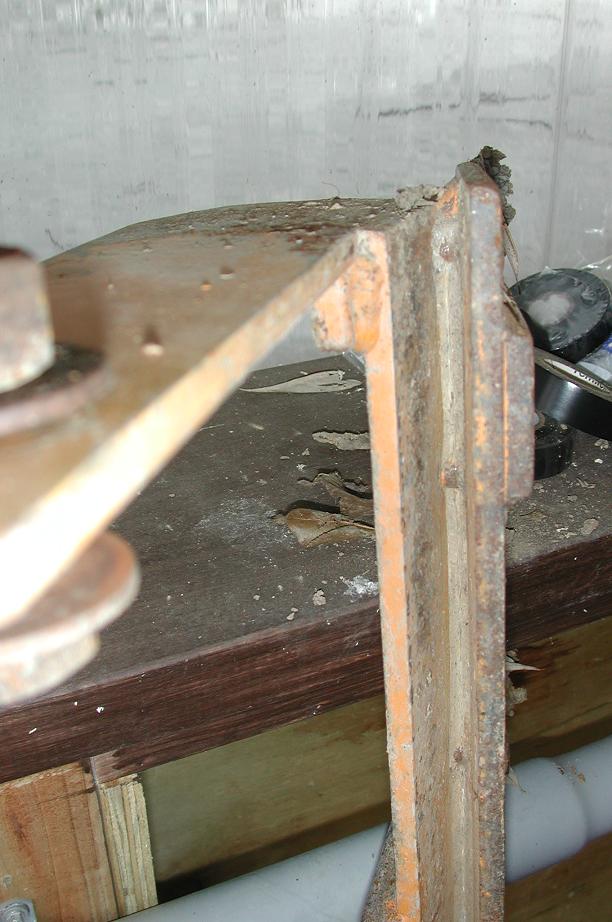

I've attached a photo that shows the inside of the toothbar which rests against the bucket edge. Several of those rivits [for lack of a better term] are visable...
