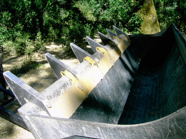

Okay, I gotta jump in here. I bought the Gearmore tooth bar for my bucket 'cause I'm lazy and didn't want to drill holes in my bucket. This tooth bar is simple to put on off, just loosen 4 "allen" set screws and it's off. I've used this bar when digging and moving 24" rock, dirt etc. and it hasn't even come loose. I take it off at job sites if need to move dirt off pavement or sidewalks then put it right back on for digging.

I'd never known the Gearmore toothbar was held on by allan screws but it makes a lot of sense. I could never figure out why Markham and the others use big bolts to hold a toothbar on when you are essentially jamming it into the bucket lip everytime you use it. There are very few instances when you could put "pull" pressure on a toothbar that would require a couple of half inch bolts to resist.
