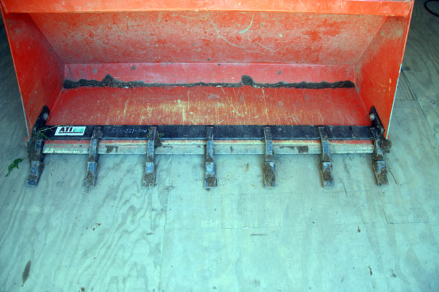

soxfan:
how does that toothbar mount to your bucket?

A 3/4" hole is drilled on either side of bucket to hold toothbar on. Teeth on bar have a notch cut in them to clip over cutting edge of bucket.

Here is a picture of my ATI toothbar which is pretty similar to the Markham one. You can see how it mounts from the picture.
