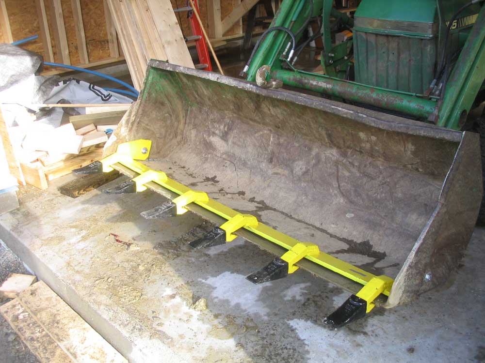

I bought one of these Ebay toothbars a month or two ago. The company is United Steelworks in Plymouth, MA.
They shipped my toothbar out within a day or two after I won the auction, and it's a great looking piece: heavy-duty with sturdy teeth. I haven't had a chance to use it much, but it looks like it'll last a lifetime.
And if you have a green tractor, the yellow color of this toothbar is a good thing too!

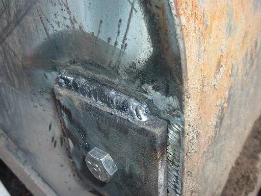

Hot dog, got it on. Only took a couple pictures though, none very good.
I used the toothbar hole as a guide to drill the half inch hole from the inside. No messing around with pilot holes, just grabbed the half incher and poked 'er through.
One tip, don't hit the tooth tip directly with the hammer to set the bar on the cutting edge. Turns out the teeth are brittle and will chip. Instead, use a chunk of wood as a bumper.
Here's the weld.
