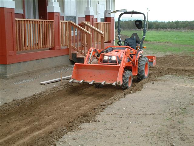

The Kubota B7510HST I had a few years ago had a Markham toothbar on the bucket. A big help in digging.
To backdrag, I just curled the bucket up to get the teeth pointing at 30-45 degrees above horizontal and use the bottom of the bucket. No problem.
