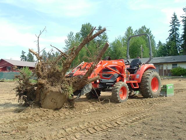

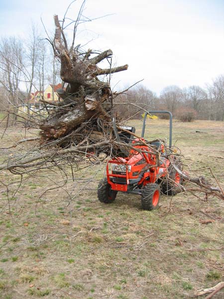

There you go posting yet another photo showing how desparately you need a grapple. Toothbars are for digging. Grapples are for stumps.:D
Call Markham.;)
Call Markham.;)
I'm not sure if I'm ready to stimulate the economy or be stimulated by it just yet. I need to wait for awhile first. I have determined that the grapple is a way smarter investment than a backhoe or tiller for me.
The only time a take that toothbar off is when I am going to be laying and smoothing out gravel for a road. It is much easier for me to use my loader bucket to get a nice road than to use the boxblade the whole time.
