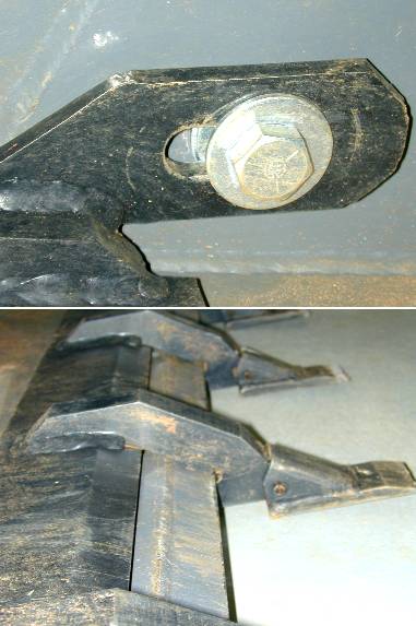

I'm finally getting around to getting a toothbar for the Woods model 1012 loader on my NH TC33D. Woods sells two models: Standard w/ welded on teeth, and deluxe with replaceable teeth (the deluxe also fits over a bolt on cutting edge, which I do not have).
Any comments on how desirable the replaceable teeth are? I'm not doing any commercial work with this unit, but I would like to dig out a few good sized rocks, and some stumps (most stumps less than 4 - 5"), along with some general earth moving. I wasn't sure how likely it would be that I'd ever need to replace the teeth. Also, not sure how good a fit I'll get with the deluxe bar, without the cutting edge installed (don't want to loose any more lift capacity than necessary)
Any comments would be appreciated.

John,
I don't have an opinion on the replaceable teeth as I've only had my toothbar for about a month.
But I do have the deluxe Woods toothbar and am very happy with the fit. It seems the V just gets wider near the back to accomodate the bolt-on cutting edge (which I do not have). If you push the toothbar back far enough, the bucket lip fits into the V, giving it a nice tight fit. I take it if you had the bolt-on cutting edge, it wouldn't slide back quite as far and your holes would need to be drilled slightly forward.
I've attached a picture of the replaceable teeth. I wish I had a picture of the fit (from the side), but I don't have one with me. I can take one if you'd like. The shadow makes it look like there is a gap, but it is actually very snug.
Hope this helps.
--Brad

Thanks for the picture of the replaceable teeth. If you get a chance, a pic of how it fits over the bucket edge would be appreciated. It looks as though the side bracket on the toothbar might have slotted bolt holes? If so, it might be possible to fit either with or without a bolt on cutting edge by just sliding to one end or the other of the slots??

John, you're right. It does have a slotted bolt hole. Hope this picture helps.

Do you have a cutting edge installed, or is that the bucket edge in the photo?
