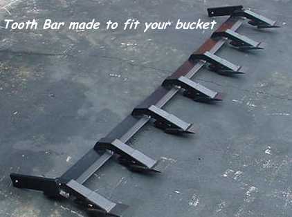

Here is what I am doing...I just ordered a 58" toothbar from http://markhamwelding.com/ Check them out, might save you some money. Their standard bar has 7 teeth (attached picture), I ordered 8. That gives me 5.75" between the teeth. Probably not enough space for the forks. Longer bar, more space. Less teeth, more space. I am also going to order some light duty forks from Payne's. Their capacity is about the same capacity as my LA402 FEL @ 500mm forward of the pivot pins, so they will suffice. My tooth bar will probably be left on the bucket most of the time since my soil and terrain conditions are a bit more demanding than what the regular cutting edge is up to. As for the forks, I will use them for moving brush piles, lifting building supplies, elevating a work platform and generel stuff like that. As for the extra 15 minutes it will take to pull off and reattach the toothbar so I can use my forks: I can nullify that by driving in high gear at full throttle between task /forums/images/graemlins/ooo.gif or maybe I will just take 30 extra minutes and sit down with a cool drink, stare at my tractor and remember how hard all these task would be without it. /forums/images/graemlins/cool.gif

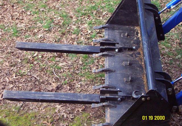

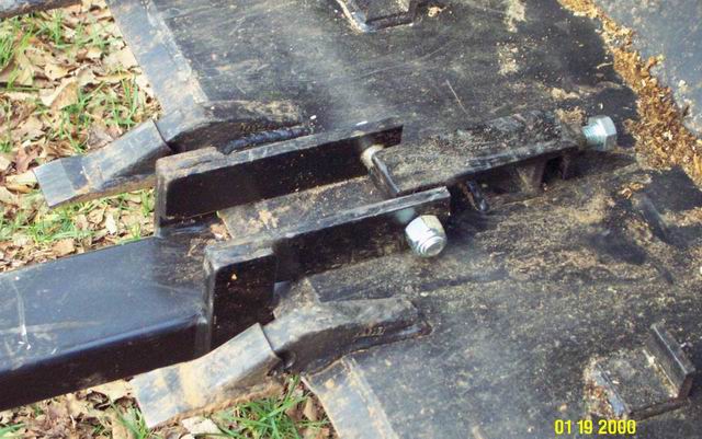

How about both at once? Fabco 2A weld-on teeth cost $110 total and unlike most toothbars they are flush with the bottom of the bucket edge so I can scrape my driveway without digging in. Forks are made from 2 x 4 x 3/16 tube with hangers from 2 x 1/2 flat. The hooks keep them from cocking sideways like clamp-on forks.

Picture 2.
