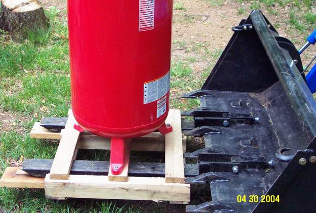

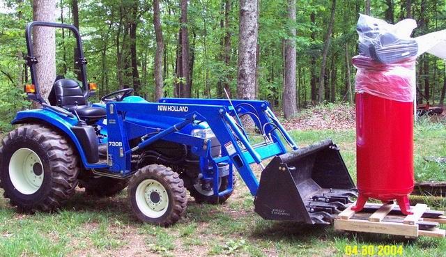

Wow. I like those forks...very nice indeed. How are the forks attached to the bucket? I know I should be able to tell, but am not sure. Sure it is not Jet plane science...or maybe.... /forums/images/graemlins/shocked.gif Oh, I see it now. you tighten that rear bolt against that hook like thing that is welded to the inside floor of the bucket....How far does the fork extend under the bucket, same as the top piece?

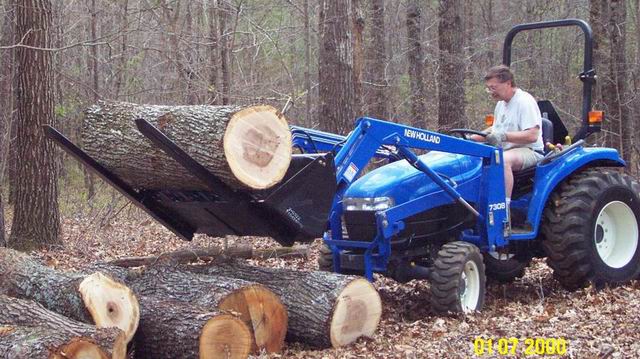

What kind of welds are on the teeth (stick, Mig, Tig)and where did you get the teeth. Not familar with Fabco. I think it is time to learn to weld....look out world.
So, how fast does your tractor go.... /forums/images/graemlins/grin.gif

</font><font color="blue" class="small">( Oh, I see it now. you tighten that rear bolt against that hook like thing that is welded to the inside floor of the bucket.)</font>
Yeah, you got the idea. I found that the bolts only need to be finger tight to keep the forks from getting knocked sideways. I've heard this can be a problem with the clamp-on type forks. The bolts bear on a piece of angle welded to the bucket floor. These angles don't collect as much dirt/soil as I had feared.
</font><font color="blue" class="small">( How far does the fork extend under the bucket, same as the top piece? )</font>
The fork tube goes all the way to the back of the bucket floor to give maximum lever arm to resist the down load on the forks.

</font><font color="blue" class="small">( What kind of welds are on the teeth (stick, Mig, Tig)and where did you get the teeth. Not familar with Fabco. I think it is time to learn to weld....look out world.)</font>
I just slapped a bead on 'em with a Millermatic 175 MIG. One advantage to doing your own projects is that you can justify tool purchaces with the CFO based on all the money you allegedly save. Plus welding things together is a lot of fun. I think any welder type rated 125 Amps or so will do the job.
See: http://www.fabco-inc.com/pdf/2Aseries.pdf
I ordered them through my local NH dealer.
</font><font color="blue" class="small">( So, how fast does your tractor go.... /forums/images/graemlins/grin.gif )</font>
Sometimes too fast. The TC-33 got pretty tipsy over bumpy ground with those big logs, even with about 500 Lbs of liquid in the rears. I should have carried the bushhog on the 3PH but then maneuvering would have been a pain. Wear your seatbelt, kids!
