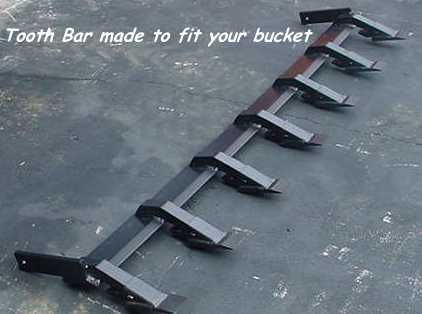

Shu, I live on the other tip of Texas....Old El Paso, anyway, here is one more rock on your tooth bar pile. I just ordered an 8 tooth bar from http://markhamwelding.com/ (attached a stock picture of the 7 tooth). They make them to size and they bolt in. You will need the inside measurement of your bucket from side to side, 8" in from the front lip of your cutting edge. I ordered mine on Friday morning, it was shipped that same afternoon and will be here on Wednesday or Thursday....$285. delivered.
