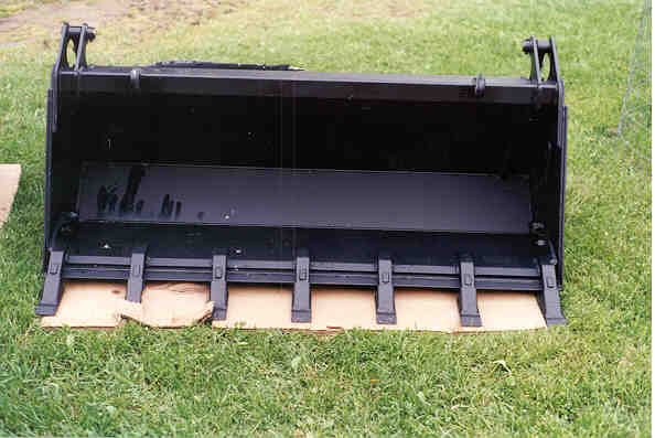

<font color="blue"> Lastly, I have heard toothbars interfere with snow removal, so I am wondering if I could get some input on this as well. </font>
Yep,......they do impede a bit the pushing and shoveling of snow. I'd recommend getting a bolt on toothbar. Two bolts on the side of the bucket attach the bar to the bucket (similar to the one shown in the attachment). One can quickly take this bar off during winter snow season when the bar isn't needed all that much. I think you'll find working without the bar in snow is somewhat more efficient.
...Bob

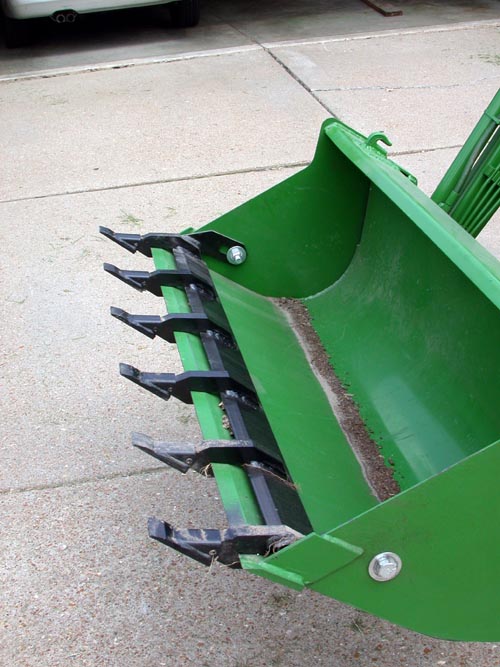

I have the same tractor and have a Woods bolt on toothbar. Got it from my JD dealer. About $275 plus sales tax.
Here's a picture!
