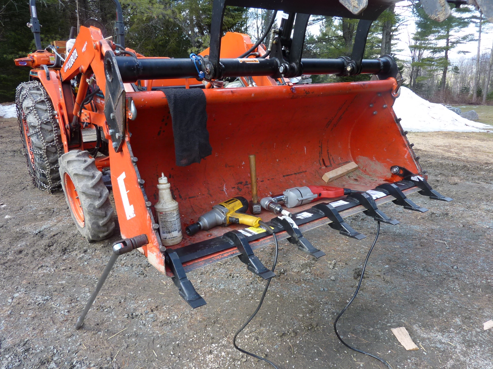

Hello,
I am looking at toothbars and piranha seems to be in favor on most forums but for my needs I thinks the traditional type might suit be best as I will be digging in hard clay, rocks and some roots. I'm not looking to skim the surface but as I understand the pirahna can be used to backdrag while the others will leave tooth ruts.
? Does anyone have the "Titan" toothbar and do the bolt on cutting edge heads interfere with installation? I have a Kubota L48 w/rounded top back bucket and bolted cutting edge plate.
Here's a link to the toothbar I'm considering:
48"-72" Skid Steer Bucket Tooth Bar Universal Size
Thanks in advance for reply's.

Here is where I bought my toothbar:
tractor bucket toothbar
Very well built and do not have to drill any holes in your bucket. I got the 46 1/2" for my 4 foot bucket.

Mine is a WR Long not Titan but they attach similarly. You are right about a toothbar for digging in rocky hard ground. I can back drag to smooth using the heal of my bucket w/o leaving teeth marks. And for smoothing hard bumpy surfaces or any surface the teeth really help. They are like scarifiers and the cutting edge spreads and smoothes.
