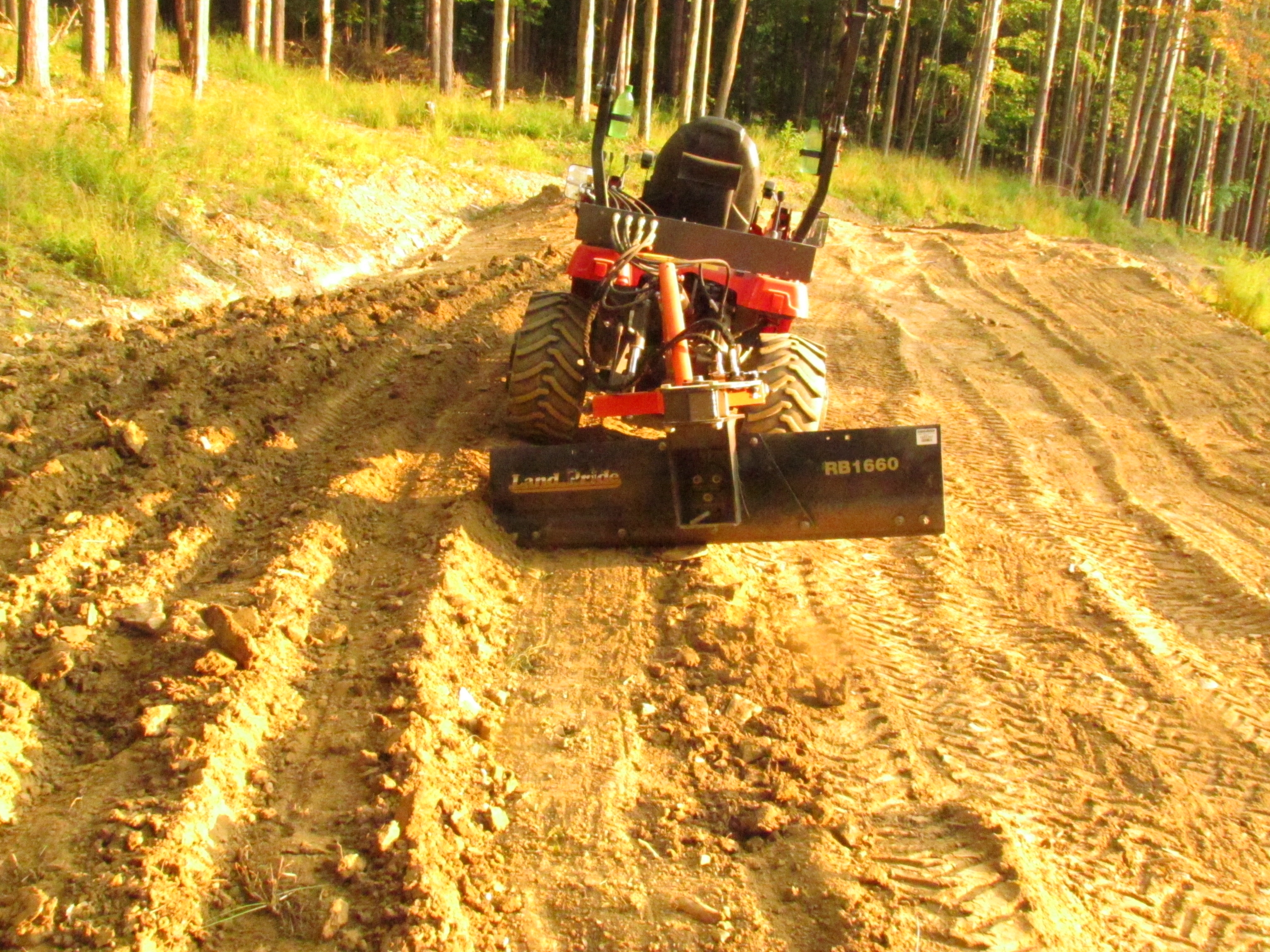

Maybe not the member that @von-mil was thinking of but I have dual tilt cylinders. I use a Land-Pride back blade extensively for "landscaping" and the dual cylinders allow me to easily change the angle to +/-15 degrees. This is great for ditches and swales and also allows me to break up my damned clay "soil" with the corner of the blade.
   / Top and Tilt on the left side? #12
Here's some photos:
