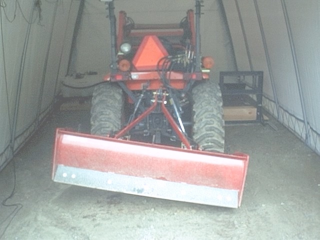

   / Top and Tilt Regrets? #30
Two tilt cylinders is expensive $$$ overkill in my opinion.
On the B-series the 3pt linkage geometry limits the tilt to about 3" in each direction. My TCC cylinder with its 5" stroke gives 2.5" of tilt. This is plenty of tilt (see this pic) and is more than enough to do anything that will ever come up on your property. If you need more tilt then you need a different machine!!
The real key though is to get the correct size tilt cylinder. A cylinder with a 4" stroke and a 10"-11" retracted length BEFORE adding the end forks would be ideal for the B-series. My experiments indicate that this would give pretty much an even tilt in both directions.
The TCC cylinder is generic and they only change ends for different tractors. Its retracted length is 4" too long for the B-series so I now have a situation where I had to lengthen the forks on the non cylinder side. This has the effect of making the max tilt in one direction less than the other with the limiting factor being the 3pt geometry. However, it is still plenty of tilt (see next pic).
Bottom line, based on my experience, is that a single, correctly sized tilt cylinder is the way to go. I can see no advantage to dual tilt cylinders. Adjusting the tilt cylinder to make the implement level takes 2 seconds and one lever.
Don't waste your money on a second cylinder. Spend it on beer instead.
