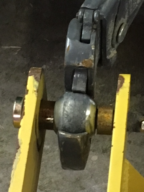

I think that you would find that the std full 3pt quick hitch works quite well when connecting implements when you have a top & tilt set.
If you want to step up from the Pat's, maybe consider Euro type draft link ends.
Lot's of options, just something to consider. :)
