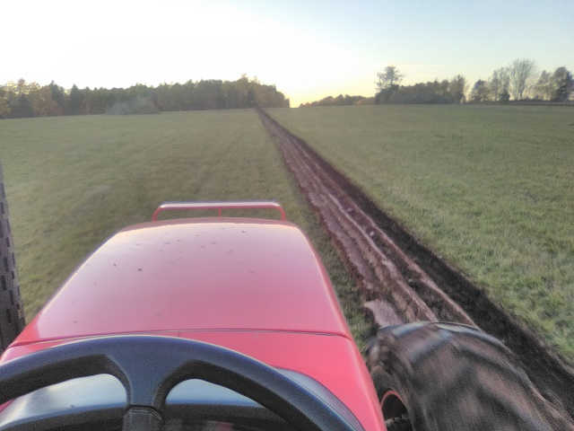

I plow with a 3 furrow.
Plow should be set up to be level while in the furrow.
If your top link is too long, the back bottom is in way deeper than the front bottom, vice versa if too short, back bottom is too shallow.
Tape measure is your friend setting up a plow.
Biggest impact on the front furrow depth is the 3pt lever setting.
If your points/shares are wore out that will affect plow depth as well.
Those are some straight and beautiful furrows Mr. Farmer.
And that's a BIG field to plow with a 3 bottom plow!
/ Top Link and Plowing Depth #9
Thanks!
One was 12.5 acres and irregularly shaped, took over a day to do it.

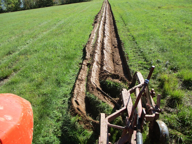

I have a single bottom moldboard plow and a hydraulic top link. So...... making changes while under way is simple. I've found that the plow works best, for me, with the bottom level when at the desired depth. Otherwise - the plow is trying to "surface" or "go deeper".
/ Top Link and Plowing Depth #15
Exactly.
For a multi-bottom plow, you have no choice though...changing the pitch of the points effect the whole plow
