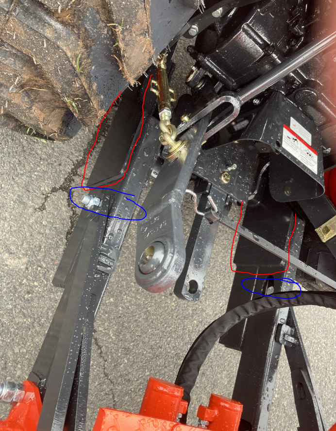

I Just found this pic today of a 2021 Kioti 2610 w/backhoe, looks like Kioti figured out additional bracing is needed on the subframe, not sure about that hole in the box for the linkage bolt on the RH side.. Id be interested to hear thoughts on that hole in the frame for the linkage bolt... like??? or no-like???
   / Top link brace for Backhoe on CK or DK
Just to add some detail on the new bracing plates from my previous post, they are on the innner and outer legs of the square tube, circled in Red
The questionable hole is shown with the blue circles....

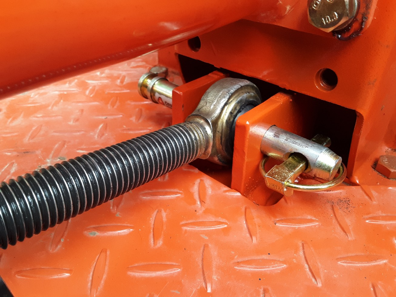

Heres a couple pictures someone sent me of the top link fix.
   / Top link brace for Backhoe on CK or DK #7
So I guess people that own these backhoes and the frame cracks are SOL!
That fix MAY help, by taking SOME of the strain off the top link where it is attached to the tractor!
I am not at all certain that I would bet the cost of a completely rebuilt tractor rear end on that modification.
If the hoe can be operated normally, without the top link being connected at all, I will become a believer!
