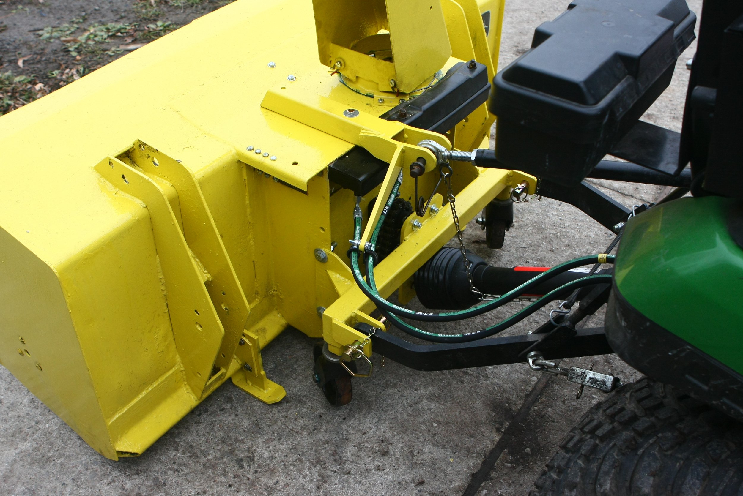

Not practical, still too much structure would have to be added to get it out and around the chute swing cylinder. And, the top arm of the 1025 does not shorten as much as the JD650 did. My home made vertical log splitter, I made for the 650, had a closer top link to get around the push cylinder. It fit fine on the 650, but will not sit vertically on 1025, with the top link most shortened. The 1025 appears to depend upon the top and lower links all being in the same vertical plane.
I plan to make my offset top link attach a bold on, so if I have been horribly wrong, I can unbolt, and rethink!
   / Top link off center? #12
Yup, I checked, everything turns the correct direction. It is evident that what had been a front mount blower on my JD650, was a converted rear mount blower from something else JD had build previously. It had a special gearbox to reduce from front PTO speed to blower speed without changing direction (idler gear, not evident until you take it apart). So, instead of gearing down from engine speed (roughly 2.5:1), I'm going to sprocket and chain up from rear PTO speed to blower speed (roughly 1:2). The desired blower (fan) speed is 1000 RPM.
That's the easy part. The lower three point links are also easy, as I've already made a cross beam for two 360 degree swiveling castors to replace the skid shoes (they dug in). The lower three point links go perfectly to that beam. The top link should be a little off center, so as to be beside the chute, rather than a complex and spindly structure to try to hold a centered top link half way along and behind a still off center chute.
I will put up photos when I have it all figured out. As I didn't even mount the blower last winter, for lack of snow, I'm not interested in buying a whole new three point mount blower, when I have an otherwise unused front mount blower just sitting here waiting for some creativity to make it rear mount!

I got the 1000 RPM from doing math on the gearbox I removed. That value was substantiated by a reply from a three point hitch snowblower manufacturer, who very kindly gave me guidance, in part saying:
The fan on the 700587 needs to turn approx.. 1100RPM. Direct drive will be too slow and will not through the snow very far.
So I'm just working with the information I have, but knowing that direct drive of 540 to the blower will not work well for me. Happily, I don't need to throw the snow far, just away from the driveway, so I don't need optimum performance, just move the snow 20 feet. I guess that if it shakes, I'll have some balancing to do!
The snowblower weighs around 500 pounds (and they shake!), so my fittings must be robust...
#15
Conversion complete. I had to offset the top link about 6" to the right, to clear the chute cylinder mechanism. I removed the original gearbox which reduced from front mount PTO engine speed, and made up a chain drive, which about doubled the 540 PTO to get the best fan speed. Everything works very well. If winter turns out the way I would like, I won't even use it!
Began with.....
Finished product:
   / Top link off center? #16
I don't think it should be much of a problem generally. I think it'd create an imbalance of forces acting on the two lower links, but only along the horizontal dimension, along which everything is very strong and rigid, so that wouldn't matter. It could add some twisting stress on a wide implement that might experience unbalanced forces -- such as a box blade with its rippers adjusted to only scarify the earth on one side and not the other.
I had a counterweight built from two very solid slabs of steel, that sat side by side on a repurposed drawbar. I had to put the top link on one or the other, so that was off center, maybe by about your 6", give or take. The top link kept the weight from pivoting forward or backward, and I could never tell that being off center made any difference at all, in my case.
