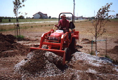

Wondering how many have encountered this problem. The top link on my tractor has always been very difficult to adjust, with or without the box blade on. Now, after I adjusted the link out (in a place that I have used before several times), moved and leveled 15 tons of rock, I can not adjust one side of the link. I have been able to get the one side to move (the other side is fine), using a long handle monkey wrench.
I am planning to visit my local dealer and see if there is a better top link then the factory one.
Will take any other suggestions.
By the way, the BX2200 does ROCK!
-Mark

Actually I believe those two screw holes were put there to allow the Kubota factory to use a drift punch inserted into the two holes to smash the threads with the threaded rods at their extended positions to prevent overextending the link and or having it thread apart. The screw are then inserted to prevent trash/water/etc from entering. Yes, I know this because using considerable force and techniques I perhaps should not mention in mixed company I was able to take mine apart and observe the punch marks or what was left of them after I threaded the thing apart. It is possible that one could install a grease zerk at either of these locations or a more central position. It may well be the link was punched to low on the thread and it is binding before it SHOULD BIND or that you are attempting to overextend the link. It is also possible that with a heavy load on the link like a boxblade that some force or leaverage will normally be needed--I use a Crescent wrench I carry stuck into the handle to turn mine. J
