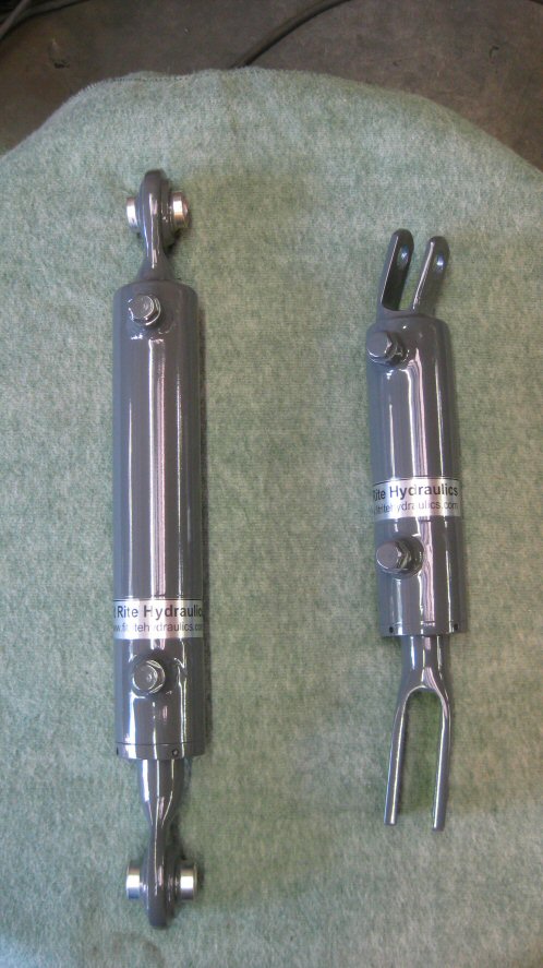

Why do you want a cat 2 end for your cat 1 tractor???? I personally would not get use a 1 1/2" dia cylinder for any tractor bigger than an actual garden tractor. Get a 2" dia cylinder. When I supply my customers with a B series tractor, I provide a 2" dia cylinder with a 1 1/4" dia rod having a working length of 18"-26". This top link has a 1 9/16" wide cat 1 ball swivel at the tractor end and a 1 3/4" wide ball swivel at the rod-implement end.
The picture shows a B series top & tilt set of cylinders. This is what works best for the B series tractors unless you are using a Pat's quick hitch. Then it needs the top link to be 2" longer for a 20"-30" working length. ;)
