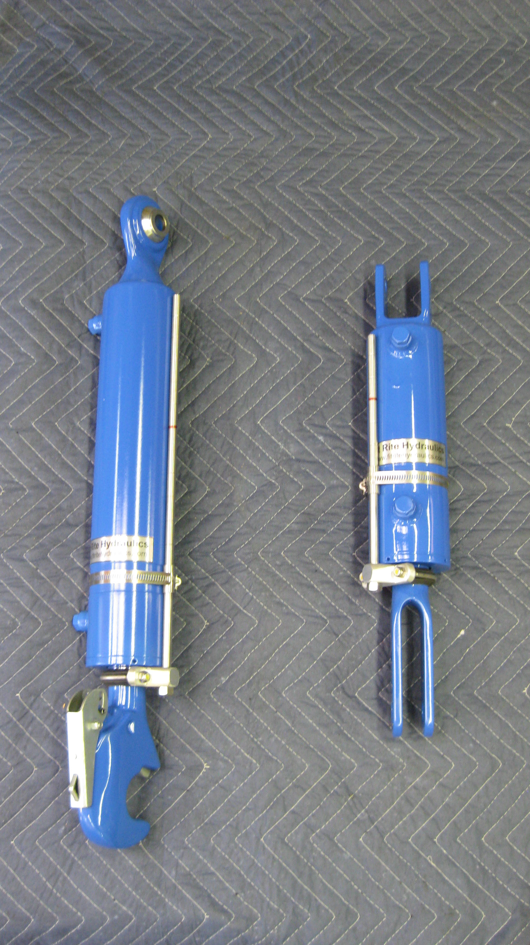

Fit & finish. My units are not off the shelf units. Every unit is built by me to fit YOUR tractor, no matter if you have an 18 HP sub compact or a 660 HP AG tractor.
I do my best to provide the optimum working length possible for each and every tractor be it a top or side link. Yes off the shelf units work, sometimes the same as mine. But the majority of the time, the working lengths that are available with off the shelf products just work and do not provide the ideal amount of adjustment in both the retracted and extended directions.
Pictures are examples of various top & tilt sets built with 2", 2 1/2" & 3" dia cylinders for Kubota, Kioti, John Deere, New Holland. ;)
