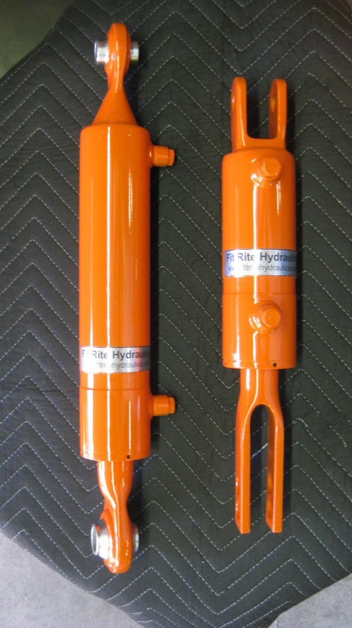

Look at this link, get the asked for dimension and use that dimension to determine what the mid stroke of the unit should be plus or minus a fraction of an inch.
I recommend a cat 1-2 top link with a 2 1/2" dia cylinder with a 1 1/2" dia rod with a working length of 23 1/4- 35 1/4".
Look at the link, get the pin-pin distance asked for and see what you really need. ;)

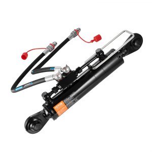

Make sure that the toplink that you buy has a stop valve on it. This keeps the piston from leaking down.

You could always go chinesium 😂
On a serious note, One thing to look at is the tractor side of your top link to make sure it’s cat 2 also. Many of the Kiotis of that size use a cat 1 on the tractor side. So if you were to order one from somewhere that was a cat 2 on both ends it will more than likely not fit the tractor side.
   / Hydraulic Top Link NS 6010C #6
If there is room for it, you can put a reducer bushing in it.
   / Hydraulic Top Link NS 6010C #7
I bought one of these in Cat 1. No issues. I don't plan on running Cat 2 so I'm just reducing the lowers. At some point I'm going to narrow the lower arm joints and use a Cat 1 Quick Hitch. The Cat 2 lower arm ends is unfortunate.
