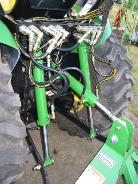

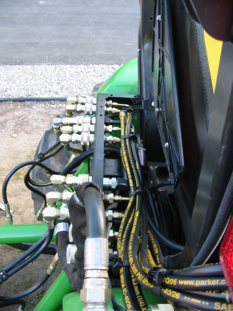

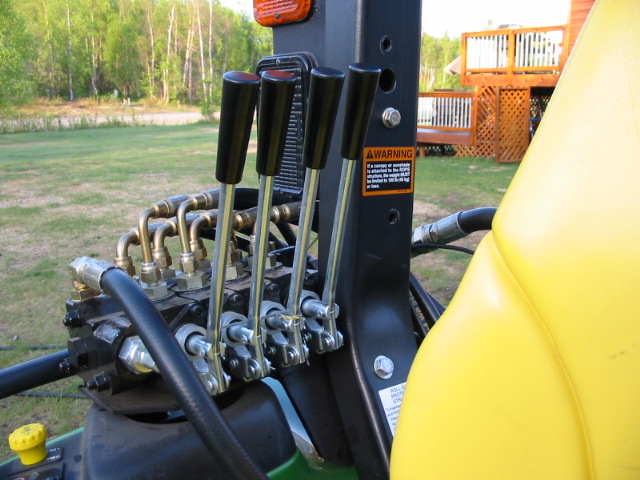

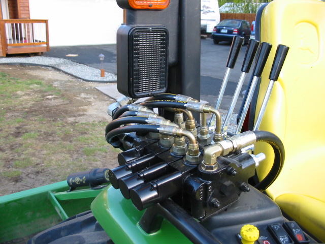

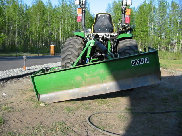

Bringing my old thread back to life...whoever said I would want TNT in the long run was right. What is the cheapest way to add it at this point? I have the 3rd scv, and at the very least I want to add a hydraulic side link that I could plug into the rear remotes. To control top and tilt I would need additional remotes. Adding two pairs off the primary scv with a diverter is too expensive. Again, can I use the power beyond? If I tap into this will I use the lifting function of the 3ph? I've read of some clearance issues with the 448 backhoe mounting bracket. What should I watch for. I'll be doing this myself since the dealer only speaks JD, and only promotes the addition of diverter kit and JD tnt kit.
   / Top N Tilt for creating drainage swales? #10
It's been a spell since we kicked this around....
Here's a few pics from a fellow TBNer from Alaska that used his Power-Beyond circuit to plumb an open center 4-way valve body mounted on the rear fender.
He's able to put some real angle to his box-blade!!
AKfish
